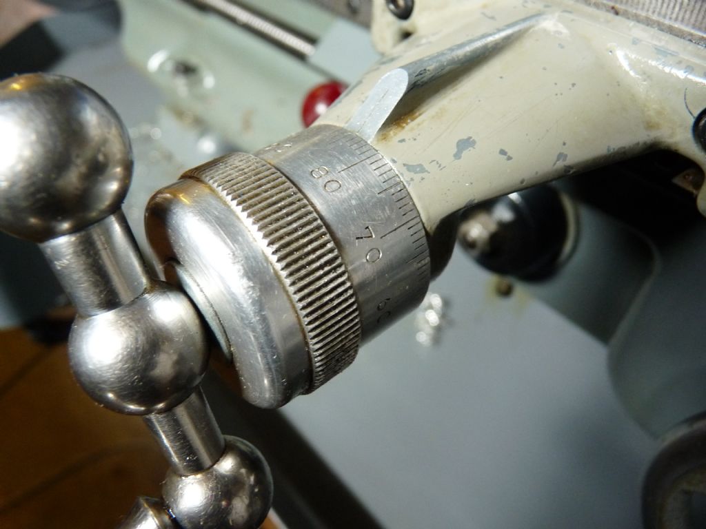

      CotswoldsPhil
        @cotswoldsphil
        Following on from Neils post, here is a crossslide index wheel I made for an ML7 years ago to replace the 'orible die-cast one. As Neil indicates the feedscrew is 10tpi so there are 100 divisions on the dial. A piece of clock-spring between the inner and outer components adds the necessary friction.
        Phil (CP)
        #168916
          Posted by Neil Wyatt on 07/11/2014 11:43:16:
          So, as the thread is 10 tpi, why not just make a 100 division handwheel, 1 div=1 thou or 2.54mm within 1.6%,, i.e. over 10mm the error will only be 0.016mm.
          Neil,
          Only Robin can say for sure, but [from my reading of his posts] he wants better than that.
          … i.e. convenience and precision when working to the final [metric] "gnat's wotsit"
          My preference for 127 un-numbered divisions on a re-settable micrometer dial, stands.
          Edited By Michael Gilligan on 07/11/2014 12:15:28

            #168923
              Sorry, over 10mm the error is 0.16mm.
              Bearing in mind my lathe is the 'other way round' using 40 divisions to turn 1mm into '40' thou I have never, ever encountered a significant error when applying a finishing cut
              My preference is to avoid an 'awkward' step in the dial at all costs, as if you overlook it and work past it, you will either add or lose a few thou.
              I also plan to replace the brain-damaging 75 division dials (0.02mm/div, which doesn't work in for me for some reason) on my mill with 60-division ones, although the DROs mean I keep making excuses to put this off.
              An interesting paradox is that my mini-lath has a 16 tpi leadscrew, I use this with a 64-divison dial, 1 grad = 0.97 thou, a 3% error. A metric 1.5mm pitch leadscrew would let me use a more convenient 60 divisions with half the error when working in imperial…

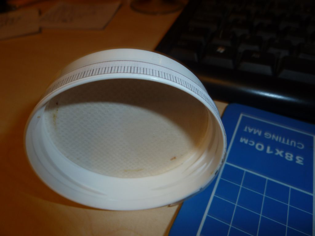

                  Robin teslar
                    @robinteslar
                    Posted by Michael Gilligan on 07/11/2014 09:05:58:
                    Posted by Robin teslar on 07/11/2014 08:20:50:
                    BUT when you are turning down a diameter towards the last few cuts then you re-zero the dial each time so its not really that limiting.
                    Robin,
                    if I understand your likely working practice correctly: I would probably make a simple re-settable dial for the Myford [there have been several designs published] and engrave it with 127 un-numbered divisions.
                    A valid point MG
                    I have never worked with an un-numbered scale but its worth having a feel of this – would I lose my way?
                    Dont know till I try
                    The OP has certainly produced some interesting observations and I am totally blown away by the geared scales but as said maybe too much play would detract from the benefit. I'll just knock up a test sample
                    BTW messing around with an ML7 is what floats the boat. I could have bought a modern machine with full DRO for less that the total cost of my old Myford but it wouldnt be the same as when I started out in a machine shop
                    So I recycled a jam jar lid from the kitchen pedal bin and here we have an un-numbered 254 grad scale. The print needs adjustment but it can work and cost me nothingdevil
                    Robin
