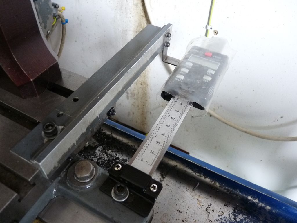

                I think this approach has already been well covered on here. These cheap digital calipers can make a cheap DRO but they are not very reliable, fragile and dont always hold their original zero reference correctly especially after powering down automatically as they do. From expereince, I dont trust them for continuous work. The old fashioned mechanical clock gauge is far better (provided it runs smoothly and hasnt been abused – like allowing it to spring back too quickly

                      Here is my version of a DRO fixed to my Super 7 which was originally made for an ML7. It gives me repeatable accuracy to 0.0005 or or 0.01mm at the push of a button. Just keep cutting fluid out of it, hence the plastic cover – don't ask. Total cost £35 + some bits from the cum-in-for box.
                      Phil

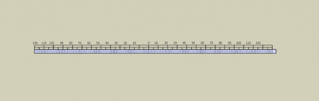

                                        well here's my attempt at the metric scale .01mm scale, i cant seem to attach a dwg so a jpg has to suffice. Its intended to fit on a 50mm wheel
                                        somethings slipped in the jpg and I could fix it but it shows the method
                                        At either end there will be a blank area not intended for use, but you can get +/- 1.2mm
                                        Robin

                                        #168882
                                          So are you saying the scale will only be used for less than one rev worth of measurement, seems very limiting.
                                          Still think the 50mm travel dial gauge would be more practical and just like what you are using at the moment.

                                            Yes thats true <1 rev BUT when you are turning down a diameter towards the last few cuts then you re-zero the dial each time so its not really that limiting. I also realised that Ive got the scale upside down and I also need to divide by 2 to give a diametric read out rather than straight radial. More work needed
