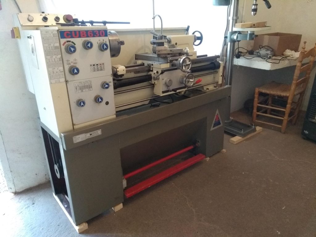

        As a milling machine is not an option for the foreseeable, I'd like to undertake light milling operations in the lathe as well as other operations involving attaching things to the cross-slide. However, the cross-slide on my lathe is not big enough to consider adding T-slots. In the long run manufacturing a replacement cross-slide would be ideal, but I'd need both a big enough mill and the skills to do it!
        So my thought is to make a fixture plate in aluminium which would be bolted to the cross-slide. I don't require repeatability of fixturing, I think, so the aim is purely to create a secure platform to hold things down.
        The cross slide is something like 350x120mm: so my first questions are: how thick should the plate be, and how securely should it be attached, to be reasonably rigid? Recognising of course that "rigid" is a relative concept! I don't imagine myself milling to accuracies of a tenth: more like holding a vertical milling slide to make things like T-nuts or a QCTP. I was thinking that six mounting holes in total would be adequate, in the corners and half-way along.
        Looking online I see I can get a bit of 16mm plate for about £35. I am thinking of an array of tapped M10 holes at say 30mm centres – does this seem reasonable? Or would it be simpler and more flexible to just drill and tap holes as and when I need them?
        Tap drilling aluminium: I may be looking in the wrong places but aluminium drills in 0.1mm increments don't seem to exist. I can find an 8.8mm carbide stub drill on eBay: to go through say 16mm, will this be up to the job for say 40-odd holes?

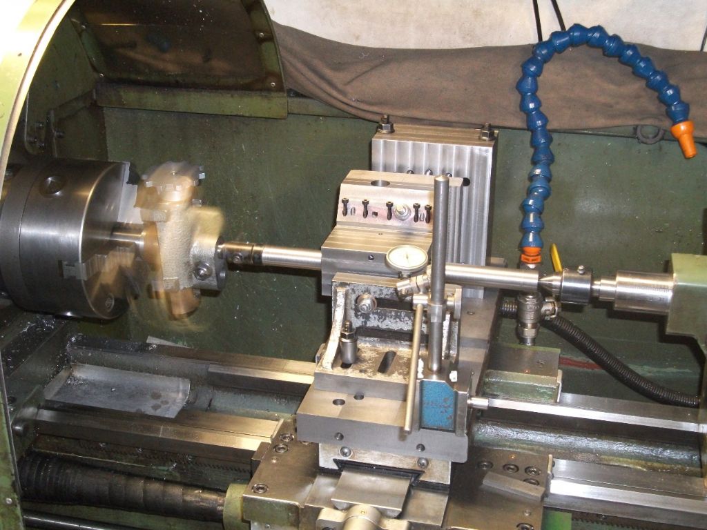

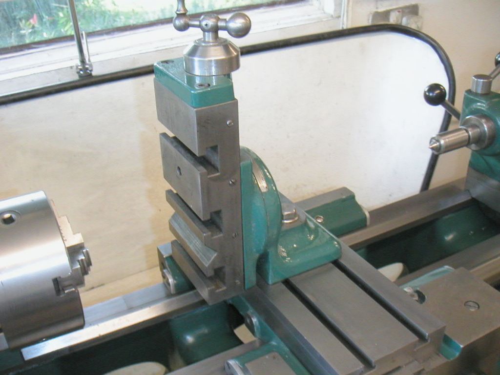

                            I have the similar machine to the Cub 750 in the Warco GH 1000 ,i also have plate
                            mounted as in the photo here it is 15 " long 6" wide and 1" thick at its machined size.
                            There are only 6 off 6 mm cap head screws to fix it.
                            I think you will need to re think the "I was thinking that six mounting holes in total would be adequate,
                            in the corners and half-way along" .
                            as you will find the cross slide at the back end is just a thin shell to cover the lead screw over
                            a length of about 4 inches and will not provide much of a secure fixing.
                            The cross slides on these machines are not that rigid ,a thick steel plate would be more
                            the thing to go for if you are unable to machine a cast plate as i have ,the aluminium
                            plate will add little to the rigidity of the cross slide.

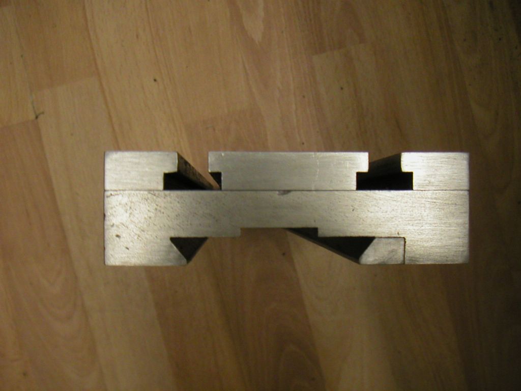

                              Callum,
                              I have added tee slots to my Colchester Chipmaster lathe. You may not want to go this far but it has proved to be very useful for all sorts of machining operations. It did also involve making a new topslide which can be moved and locked anywhere on the cross slide.
                              Alan

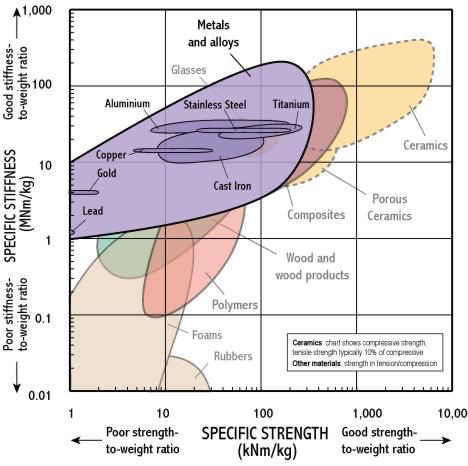

                                  Posted by John P on 06/03/2022 16:49:35:
                                  The cross slides on these machines are not that rigid ,a thick steel plate would be more the thing to go for if you are unable to machine a cast plate as i have ,the aluminium plate will add little to the rigidity of the cross slide.
                                  It may be worth noting that the ‘specific stiffness’ [i.e. stiffness to weight ratio] of the hard Aluminium alloys is, to a reasonable approximation, equal to that of steel. … and they’re much nicer to machine !
                                  A thick Aluminium alloy plate might therefore be preferable, if there is ample space.
                                  Edit: __ doubters might like to look here:
                                  http://www-materials.eng.cam.ac.uk/mpsite/interactive_charts/spec-spec/NS6Chart.html
                                  Edited By Michael Gilligan on 06/03/2022 19:22:31

                                      I should have added in the last post on this about using
                                      a thick plate instead of a thin one as Callum has suggested.
                                      The 2 tee studs that hold the top slide on are in a radial
                                      tee slot ,these can only be removed by removing the cross slide
                                      lead screw as the access hole is above the lead screw,if you
                                      use a thin plate it is very likely that the studs will protrude
                                      above the surface of the plate ,if you need to set up as in
                                      this photo here the studs would have been in the way.
                                      Using a plate of this depth the studs sit in holes drilled through
                                      the plate and below the surface. A piece of steel plate is
                                      likely the cheapest option in these sizes ,i recently
                                      bought a similar size plate 25 mm thick around 6 inch wide
                                      2 foot long for around £70 . The extra weight it adds to the cross
                                      slide is no disadvantage in milling operations.

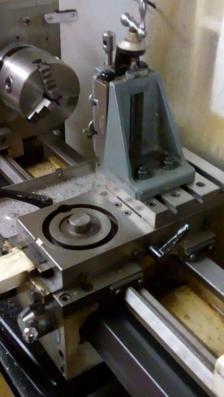

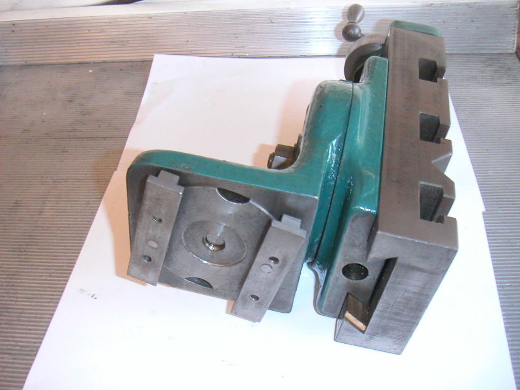

                                                I have a small mill, but wanted the similar lathe facility to what you are looking into – mainly so I had some milling capacity if, for example, I had something already set up on the milling machine and didn't want to disturb that.
                                                Fortunately I had a vertical slide I had inherited but nothing to fix it to on the plain cross slide. I purchased a small CI (100 x 120 mm) milling sub-table from one of the main suppliers at a very reasonable price (sorry can't be precise who – could have been ARC, RDG etc) and fitted this using a number of M6 socket screws.
                                                It works a treat for light jobs and is reasonably versatile. In the photo you see I have removed the toolpost, this was only necessary for special access on this particular job – making some fitments for the milling machine which is currently dismantled! Normally the toolopost is attached and operates as normal.
                                                regards, Mike

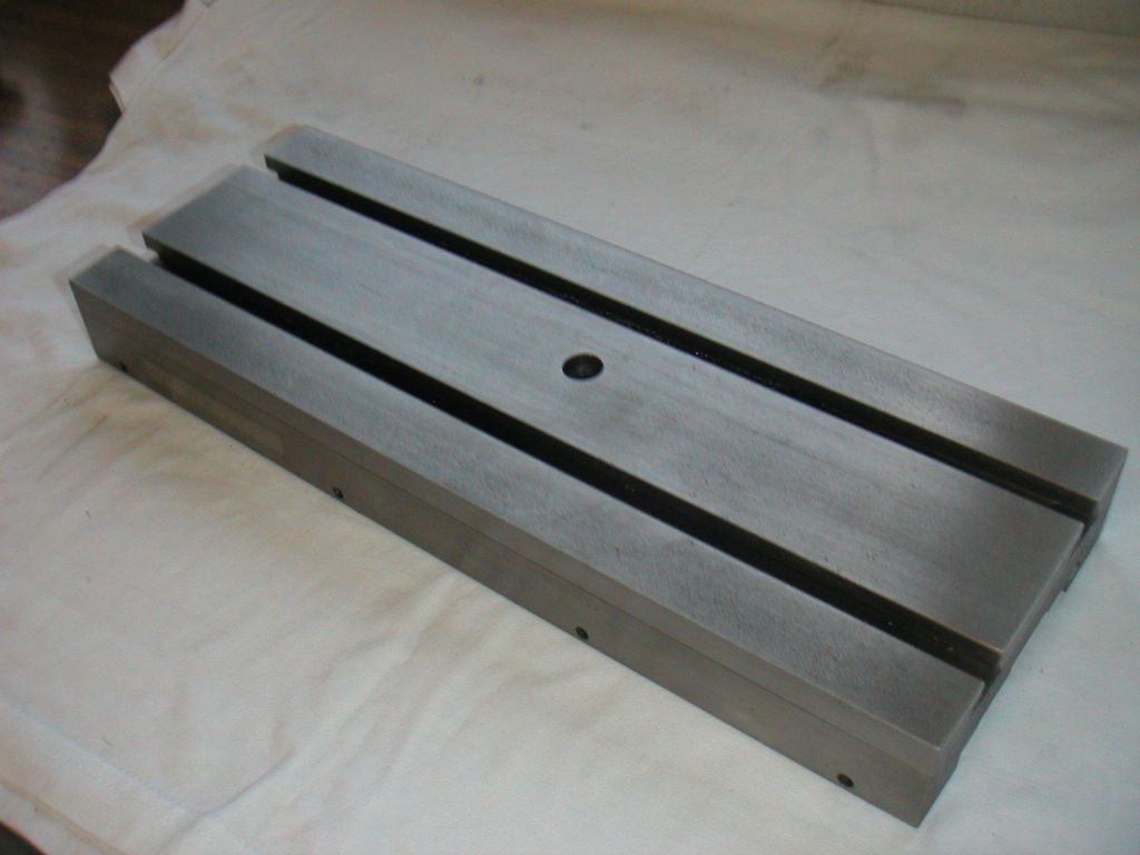

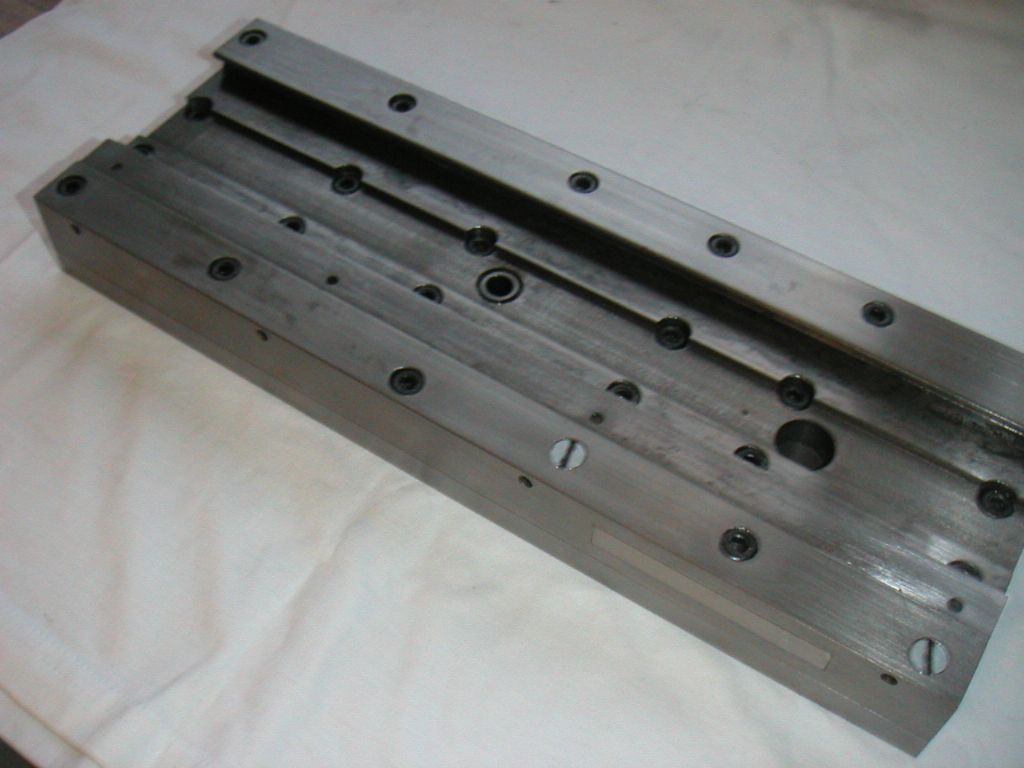

                                                Alan Jackson
                                                  @alanjackson47790
                                                  Callum,
                                                  I did not remake the whole cross slide, I just added 1/2" thick steel slabs with notches cut along their lengths to form tee slots. The slabs are dowelled and bolted from the underside to the cross slide. The space between the tee slots still enables access to the cross slide gib adjustment screws. The result is a slight loss of clearance over the cross slide but thats ok for me.
                                                  Alan

                                                      Vertical slide added
