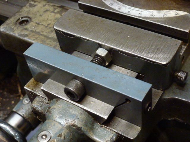

      Good evening all,,
      I,m wondering if anyone can enlighten me as to where I am going wrong.
      I have made a simple stop to limit the travel of the cross slide on my lathe in order to get consistent diameters each time.
      It consists of a screw, fixed to the cross slide which meets a stop fixed to the back of the carriage, nothing fancy. In order to make it more useful, I fitted it with a rotating disc in order to fit three such stops.
      It works fine, as a stop, but the results are far from consistent, anything from 2thou to 6 thou on all three diam,s.
      I have tried locking the cross slide but it made little difference.
      Any idea,s ? I have taken pictures which I will try to post
      All help welcome.

          Is that variation when you are cutting or with a DTI?
          If you put a DTI on the tool post and set it against your work, does it show the same variation each time you hit the stop?
          Could it be you are varying the force you are using against the stop?
          The stop could be flexing.
          The slide could be twisting.

            The obvious assumption is that the stop is not rigid enough, but pictures will help. For comparison I'd expect to hit a diameter to a thou or less just using the same dial reading on my cross slide.

              First off, I did not try a DTI ,the variation is when I,m cutting, even with a very fine feed. I tried to be gentle when bringing the unit to the stop, which is made from a piece of 40×10 which happened to be to hand. Not much chance of it flexing. I will try the DTI in the toolpost
              Andrew, I was hoping to avoid having to check the dial each time since I hope to use this thing when making a batch of small units. I did take pictures, but I,m still trying to work out how to get them from A to B, if you know what I mean
              For now, it,s back to the drawing board.

                Back again, I did manage to get those pictures into my album [don't even ask how ].
                I hope you may be able to make it out, it is simply a piece of 10mm bar which carries a disc fitted with three screws which can be brought to bear against a piece of 10mm flat.. As I said, even with the cross slide locked, when two pieces are machined at the same setting, there is a variation and a lot more than 1 thou.

                  Something is flexing possible the angle bracket, it's suprising how much force you can apply with a screw.

                    Larry, I think the bracket may be flexing and that a block would give a more consistant result.

                          I'd agree that the angle bracket is flexing; you only need it to deflect half of the diameter error. As to the error with the cross slide locked, that'll probably be down to something else. May tool or work deflection? Or the lock isn't that effective for the loads being applied?

                                  Larry if you want to test if the stop or bracket is flexing simply put a dial gauge on the opposite side and run the cross slide up to it. The gauge will show any movement, which will be doubled on diameter as pointed out by Andrew Johnston

                                    Hard to tell from the pics with nothing to give scale but the whole thing looks a bit small and flexible. Needs to be something of similar heft as the cross slide itself, more like the one in the pic Clive posted above. Your 3 bolts that form the actual stops would need to be at least 5/16" diameter I should think. I would make it 3/8 for good measure. And the body a good half inch thick or more. Basically, needs to be immovable as your cross slide screw exerts more force than you might realise.

                                      With respect the photo is almost the design. You'd have to measure the lathe to ascertain dimensions. The Allen screw goes through a clearance-hole in the clamp-block, to a tapped hole that happened already to be in the cross-slide. (I wonder what that hole was intended for?). The stop action is thus by the underside of the cap-screw contacting the block.
                                      Note the flexing-point for the clamp is the small hole near the top right edge; the cap-screw that actuates the clamp should be sufficiently far down for proper clamping action without an unduly weak wall between the thread and the block's underside. The clearance hole is just a tad generous, but not overly so if the Vees meet as they should.
                                      Larry –
                                      I would agree that stop as made is a bit too slender. The principle is very good and I am only surprised such stops are not more common. It does though, need to be very rigid and positive.
                                      The bracket could be made far more rigid by welding or brazing a triangular gusset across both ends to make a Vee-box form, rather as many angle-plates are cast.
                                      Or replaced by similar machined from a cube.
                                      It's a bit hard to see details but the central shaft and whatever it fits in, look a little thin.

                                      What you might consider is modifying / making new the bracket to be much more rigid. Then, if that does not entirely solve the problem, make the stop-carrier as above: a closely-fitting sleeve pulled back by a hefty screw to a facing on the bracket..

                                              Thinking the whole thing over last night,I came to the same conclusion ,that the whole thing was too light and flimsy.
                                              I think that the angle piece is far too light, a solid block would be a better idea there and the screws need beefing up.
                                              How was I stupid enough to believe it would work ? [Don't dare answer that !! ]
                                              It is now a case of "Back to the drawing board ", but much wiser this time around.
                                              I will build another one because it can be useful when making large numbers of items and if it works out better this time around, I will post some pictures of the Mark Two model.
