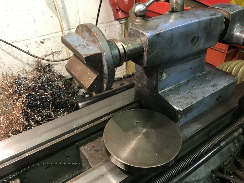

                          I think this is what Pete Rimmer was referring to in his earlier post about a 'Crotch'centre:-
                          This is a tailstock Vee cross drilling attachment from my Raglan LJ – on the front shear by the tailstock is the interchangeable flat plate which allows parts to be clamped to it for drilling.

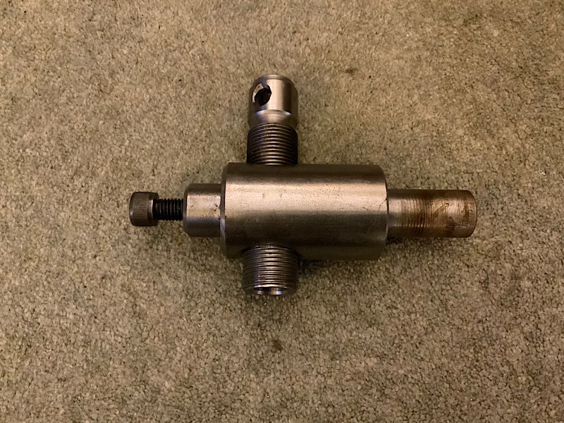

                              This is what I’m wanting to make a few of.
                              this is ok but the hole isn’t in the middle of the 50 mm bar

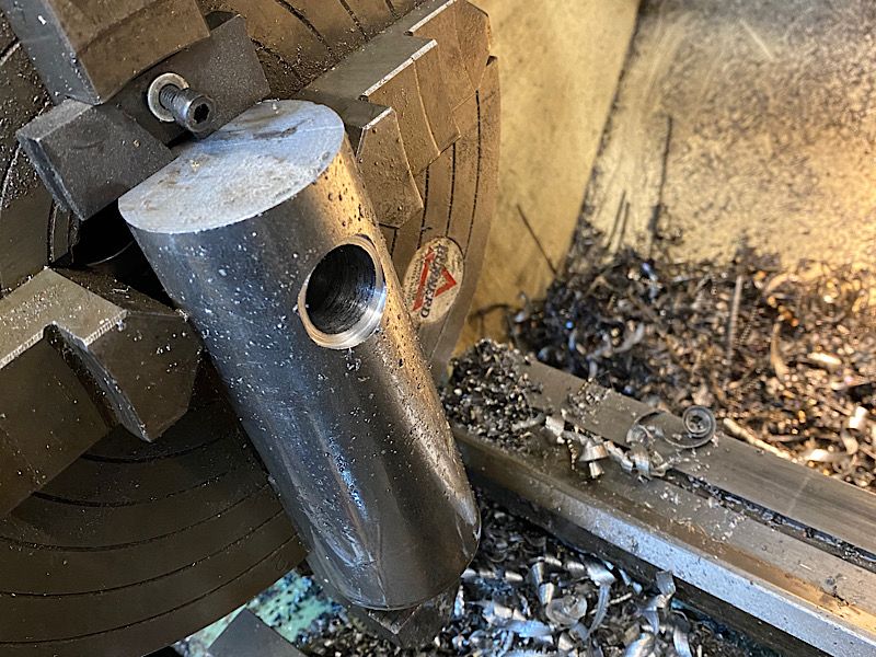

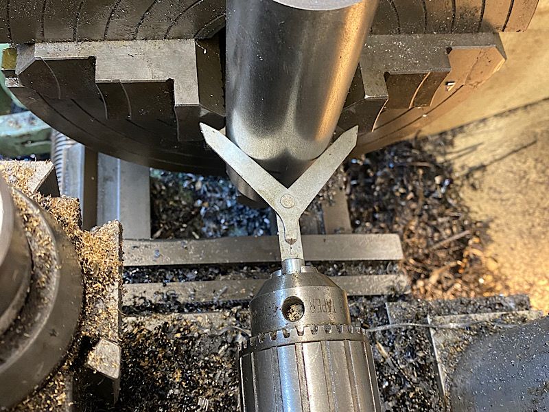

                                                    Well guys i think I’ve done it in an acceptable way for me
                                                    i do have a Dro fitted on this lathe so just touched off on the jaws holding on the diameter spun 180 and adjusted until the Dro read the same on both sides
                                                    Hopper I’d forgotten i had one of those centre finders but digging it out i remembered why i had never used it…its like it came out of a lucky bag

                                                      Oh and its a tailstock adapter for woodworking lathes for holding MT2 tooling
                                                      fits in a toolpost
