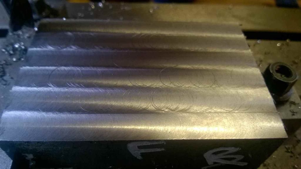

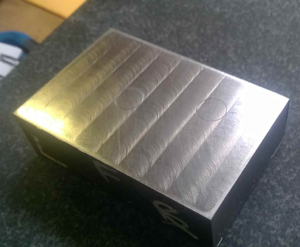

              Just had a look at your initial photos and I would say that the cutter is not presenting perpendicular to the work. Further I suspect it is cutting lower on the trailing edge which would tend to force the cutter away from the work slightly and generate the ridges as you see. When you stop the travel the cutter then cuts to depth and generates a circle. Firstly try cutting in the opposite direction so that the cutter cuts deepest on the front lip. The circles should disappear. This tells you that the head is not vertical and that gives a preferential direction of cut. Tram the head.
              The situation is made more complex by your statement that the gibs are not set correctly. However as you say you have adjusted them and the situation is improved but not corrected I think the problem is as I have suggested.

                It's odd that the surface finish in the 'crop' circles seems to be much better than the rest of the surface. So I would surmise that the problem is not to do with mill not being trammed, although that may have other downsides. It is more likely to do with the fundamental cutting process. It is as if the cutter is cutting properly within the circles but not elsewhere?

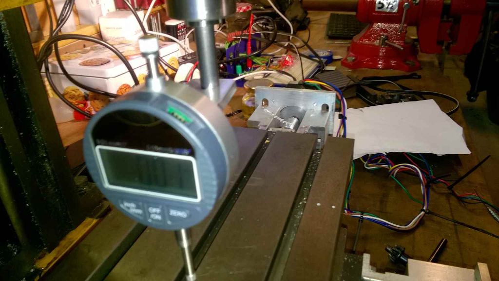

                        I setup a dial indicator on a stalk attached to a 10 mm rod held in a collet.
                        I swept the indicator round to the 8 cardinal points (more or less – I wasn't bothered about millimetric accuracy).
                        The diameter of the circle is about 12cm and as you can see, left right it's as good as it's going to get. Front back it's about 0.24 mm out with the front of the circle higher than the back (a bigger gap) – the spindle/riser is leaning back.
                        When I measure the fall of the table (by moving the table), I see around 0.13 mm fall over the same distance.
                        So if I corrected the table fall with a shim or scraping the rear way, the tramming would be something like 0.11 mm out front to back (over 120mm).
                        So to fix this I would need to shim the *back* of the riser up by around 0.05mm (2 thou), assuming that the block is about 60mm front to back (not measured this – I'm just trying to establish the principle.
                        Does this make sense? Should I shim or scrape? Frankly, both seem a tad challenging. Where can I get fractional though shims? My feeler gauges go 0.05, 0.10 and so on.
                        Do I really want to scrape this (or the ways…).and are there any tutorials / videos?
                        Also this implies that there will be around a 0.01 rise from the back of the cutter (10mm) to the front which is likely enough to explain the pattern on the 'good' cut.

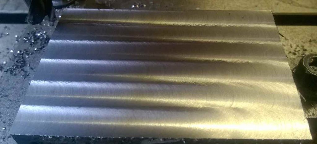

                                        Then mounted my test block and faced it. 10mm carbide cutter, approx 0.1 depth of cut, 2000rpm and around 4mm / sec feed.
                                        Although the picture looks a bit imperfect I was quite pleased. The metal feels smooth with the ridges in the front back direction barely discernable by touch. a dial indicator gives a tick of about .003 / .004 mm when it runs over them. The piece (50mm x 80mm) was level across the short face, but rose about .07 mm to the right, which is more or less consistent with the tramming results

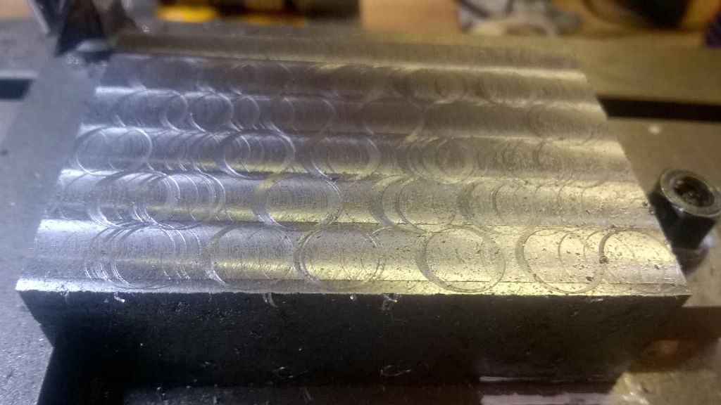

                                        Then i tried the same cut (0.1 mm) in the other direction. This was a disaster!
                                        Before I panicked entirely, I re-did the face with the original direction and got the good results I had the first time,

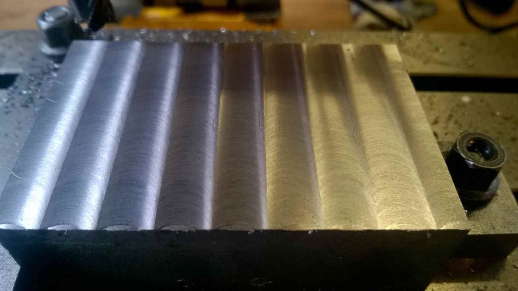

                                                    Here is the result
                                                    Not great. So I decided to do the opposite of some of the advice here and I slowed the cut down from 2mm/sec to 1mm / sec (60mm/min). With this as the result.
                                                    I was rather happy with that. It's actually better than the photo makes it look.
                                                    Finally I tried the other Axis. This is the one which was better before. Not now!
                                                    It's not quite as ragged as it looks (the left hand edge was started at 2mm ./ sec which is why it's a mess).
