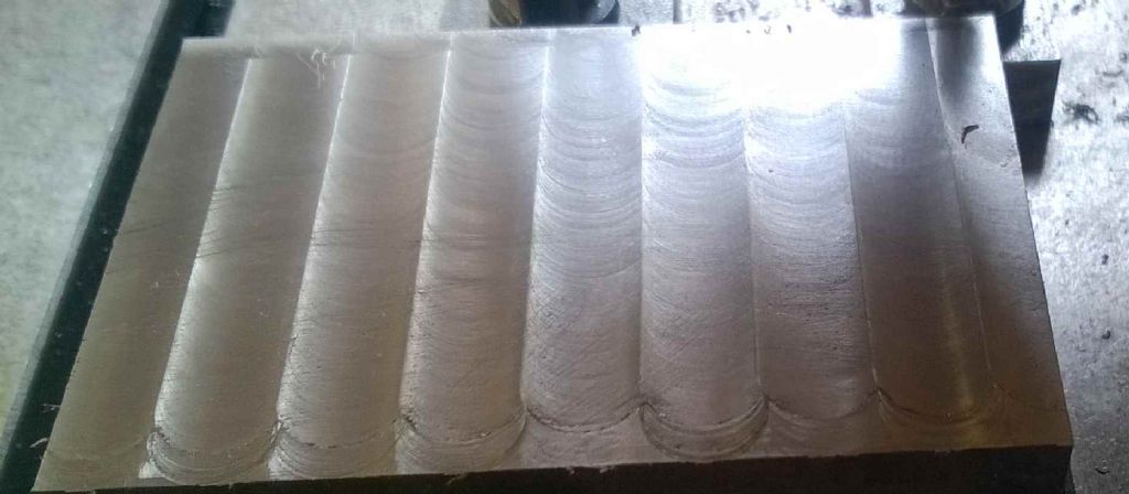

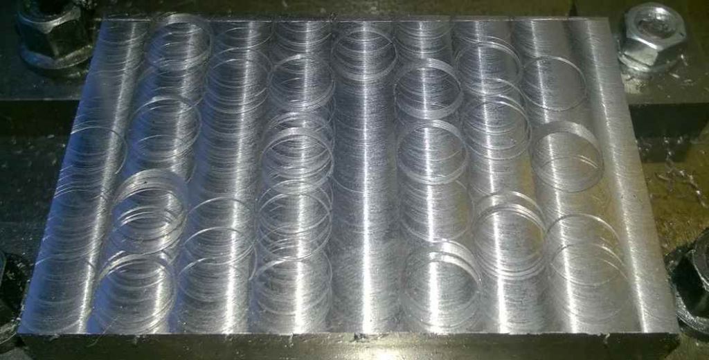

      Why do I get 'crop circles' when face milling?
      Mill is a CMD 10. tool is a 10mm carbide mill from ARC depth of cut about 4 thou / .1mm. The first picture shows the result of a manual cut.
      The crop circles are plain.
      I'm in the process of converting the Mill to CNC (of sorts) so the next picture is with the same piece of metal with a power feed (about 4mm / second and whole stop at 100 steps / mm)
      Dissapointing, eh? then I switched to 1/4 step (should be much smoother – and certainly was by sound) and down to 2mm / sec.
      This one seems much better (the ridges are the subject of my other question).

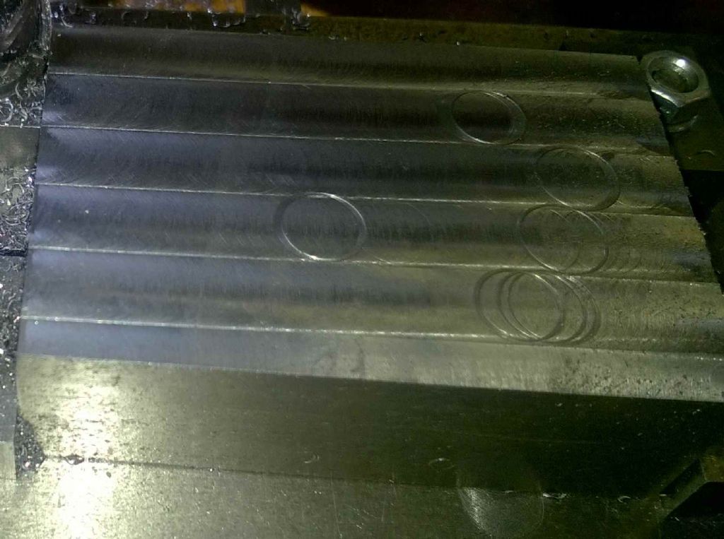

      However, here is a second run at the same spec
      So what causes the crop circles and how can I adjust the mill to avoid it.

          I've been milling aluminium and steel with Arc's 10mm carbide endlmills today ai I haven't had any problems like that at all. I was going to say lack of rigidity somewhere and have just seen you 'spindle not locked' comment. yes that will cause this, the spindle only has to be dragged down by a fraction of mm to make a 'crop circle'.
          You need to completely lock out any up-down movement when facing, there's a surprising amount of force pulling the cutter down into the work, even on light cuts.
          Can you feel the ridges? If so, you may need to shim the column very slightly, you may also get better results if you overlap each cut by a bit more, but you will always be able to 'see' the pattern.
          #241407
            At 4 thou I would say your cutter is riding up on the surface and then every so often the cutter is forced back down and the whole thing starts again. Hand feeding gives the cutter that momentery pause where it can drop back into the work.
            You say its one of ARCs carbide cutters but how much work has it done previous to this? If there is slight wear on the tips then it wil make matters worse.

              Interestingly, I've run the cut the other way as per below.
              Which is much worse.
              As far as locking the spindle is concerned (CMD10), I'm not right sure how to do it. there's a hint I saw somewhere about a locking bolt on the bottom right face of the headstock, but if that's the way you lock it, then it's pretty damned stiff and seems to have not much effect on the spindle.
              The Z axis (the riser) IS locked – that's one I have learned.
              The ridges are caused (I think) by the table being out. See my other post…

                Your first few photos look like there's relative Z axis motion from somewhere. Could be anywhere. Something is jumping up and down.
                The last photo "Which is much worse." adds additional information that looks very much like chip welding. Put the two together and ……
                Cutters for aluminum need to be razor sharp and have a good rake like 10* or more. That and a cutting lube to stop any hint of chip welding will, given a rigid set-up, yield a good surface.
                That's my experience anyway….
                Pete
                EDIT: I just looked at the earlier photos again and I see no evidence of lube. Were you using any??

                  Your end mill is not cutting across the centre, so it cannot have the long over centre cutting edge or you are picking up a bit of ali right at the tip – is there a bit welded on? Have you tried using WD40 as a cutting fluid?

                      Third photo where the cutter is still turning in the top left suggests you are climb milling which is not ideal on a less that rigid machine.
                      The last photo in your opening post also looks like there is a lot of movement somewhere as the line of the cutter seems to curve up towards the right hand side of the block

                          At the moment, my best guess is that the Y gib is a bit loose – I softened it up to try and see why I was having trouble with my CNC conversion and I've not reset it. I shall have a look that tomorrow.
                          The mill has done little other than face this 3 x 2 a dozen times – which is early in life for a carbide mill – at least I hope so at those prices!
                          I've been using paraffin as a cutting fluid.
                          I'm not entirely sure what 'chip welding' is, however google seems to think that a cure with carbide is to speed up. This piece was done at 1000rpm and the other pictures at 2000 rpm. However a previous run at 2K cutting along the X axis was not this bad.
                          I will check the gibs and end mill tomorrow and also try a deeper depth of cut to see if that helps. Mind you I'm trying this out as I want to take about .1 mm off my tailstock which is high, so it's sort of a practice run. But that's another 'how do I…'

                                          First Prize to Neil, Jason and Dave.
                                          The (main) cause is that I'd loosened the Y gibs and not re-tightened them. I'd forgot I;d done it.
                                          I tightened up the Y gib and put the speed back up to 2K rpm and this was the result.
                                          Although it looks like I've actually carved semi-circular runnels in the metal (mild steel from m machine metals), it's actually pretty flat. my dial indicators shows a few microns clicker as it passes over the mark.
                                          I will take a look at the tramming of the spindle next I think and also a bit more on the levelness of the table.
