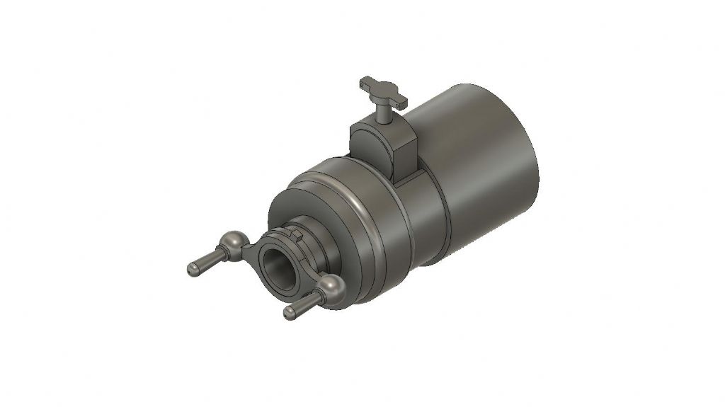

                        Posted by Buffer on 21/01/2021 09:59:59:
                        … I did try importing an image into solidworks and possibly Autocad but when it was set to the scale I needed the lines went really thick. So when tracing you had to try and guess where the centre of features were and then of course dimensions started to get out of hand …
                        Not big into model making myself, but I've done a little scaling. It's not easy! I had a go at an Armstrong 16cwt breechloader of 1855. There are various sources of information on the web, including dimensions, photographs and some original documentation.
                        Bringing it all together was hard work and I ran out of enthusiasm when I got to the carriage, of which there are various types, none of them clearly described in my sources. I decided the best way forward was to visit Portsmouth to take photographs and measurements on HMS Warrior and at Fort Nelson. Not had the opportunity yet!
                        I used 3 software tools to help.
                        Photographs often have serious perspective errors and contrast issues. I used Gimp to correct angles and to highlight features of interest, for example by removing colour and emphasising edges in various ways. Same thing can be done in Photoshop. Ideally, I would be able to scale and relate a photo to a plan or known dimension. Although measurements can be taken manually and massaged, I found Gimp simplified the process, for example by establishing the scale and minimising camera distortions. On the downside, having to learn a complex photo-editor may be more trouble than it's worth!
                        As others describe, I use a 2D drawing tool, to trace photos, and to clarify drawings. My favourite is QCAD, but many others have the similar functionality. Sometimes the process is dead easy, other times I had to 'join the dots' because dimensions refused to match cleanly. Items made from stock materials usually resolve into standard sizes, but many manufactured items don't, or only do so partially. QCAD and squared paper are both helpful, and I nearly bought a Proportional Divider.
                        When the dimensions are reasonably well established, I switch to Fusion 360 to bring everything together in 3D. Unless working from a good plan, this stage is likely to highlight mismatches and mistakes, causing rethinks! I've also found errors in original Victorian Drawings, probably because they're from Manuals rather than workshop drawings.
                        At first progress was very slow, but I gradually speeded up as I slowly got used to doing the translations. I suspect someone who specialised and practised would work several times faster than my fumblings. One trick is to spot patterns across the design; it's sometimes possible to pin down several features in one go rather than work them all out individually.
                        The breech in Fusion 360:
                        After looping round the dimensions a few times I was able to model the Armstrong's breech and barrel successfully – it animates – but have so far failed to get anywhere with a carriage, because dimensions and important details are missing from the 3 alternatives. (Shipborne, fortification and field carriages, all different.)
