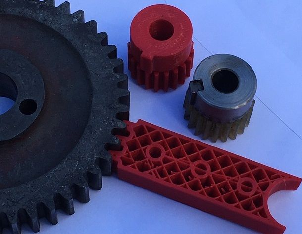

                  Ok I just joined the Ender crowd and printed another 30 tooth mod 1 gear using the as supplied slicer with default settings.
                  The brown one is the original injection moulded one, the grey the one on the Ultimaker, and red still on the Ender magnetic sheet. They mesh together well but the original is possibly just a little thinner on the teeth as it 'fills' a printed one's tooth gap but the two printed ones when pushed together do not quite go full depth
                  With 20% infill it was looking a bit empty as it printed but finished with a flat top of course hiding whatever was inside, or not inside and it feels strong enough. The hole was about 4 thou undersize using callipers which isn't very accurate. To ease it down I wrapped sandpaper round a rod, put it in the gear and ran it against another gear in the transmission while running the lathe probably at about 200 rpm. It quickly took it down to size and I could feel the gears were meshing smoothly.
                  The worst bit, a bit worse on this latest one was the key slot which seemed a bit tighter than the grey one. A few seconds with a file sorted it.
                  The Ender kit. I checked a youtube video from about a year ago and the packaging had changed ever so slightly but assembly was the same and quite quick. Except for an initial delay. I found the levelling screws just spun – not secured into the plate. Saw one other mention of this on the web and rather wonder how many people don't realise they have a problem, Anyway a bit of epoxy, a washer and a nut secured them I hope adequately. The washer was necessary as the thread does not allow the nut to go right down.
                  The kit had some spare nozzles, spare feed tube ends and a little brass bush with no obvious use. I think it might be an insert for an extra filament guide that the youtube video showed being printed and fitted.

                    Continuing with gears.
                    Next to the original plastic gear with 20mm dia steel boss is a printed 1 Module 20 tooth gear with integral bush and even the key though that needed a few strokes with a file to fit. An existing gear went straight onto the bush. It certainly feels tough enough.
                    The 20 is only used for fine feed reduction mated with a 75 in the gears provided in the train 30/75+20/100. So I have been thinking I could print a 19 instead to avoid being an exact division of the 100 and make it integral with say a 91 again to spread the wear and make the feed even finer. They would be no use for screwcutting just for the feed but I can afford to do that if they print easily.
                    Then I went up a jump to a test piece for Drummond 14DP 63 tooth printed as 3 edge layers which pretty much fills the tooth with solid plastic and 20% fill for the body. I stopped it doing the top layer to see what the infill looked like. It has some funnies in the infill pattern due to the slicer (Creality's simple bundled version of Cura) and I had wondered about the possibility of filling the matrix with car body filler. But it feels strong enough and not having the top layer may weaken it more than the filler would strengthen it. Another possibility is minimal spokes for hub placement and an aluminium sheet disc to make up the body.
                    (the Lego-like holes are for mounting screws for a strength test)
