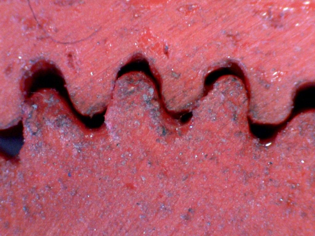

        Since my internal gear and pinion were designed as 1DP it's simple to scale to 40DP. Here are the results:
        By no means perfect, but this was using a 0.4mm nozzle. Just scale, export, inport into the slicer and use the standard settings. Plastic is PLA.

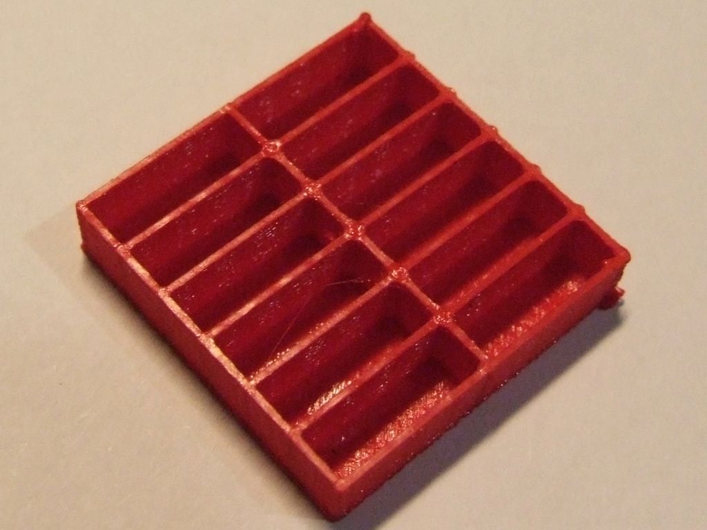

                            I've had a go at printing a thin wall box:
                            The box is nominally 25mm square and all wall thicknesses are 0.4mm, to match my nozzle. First time round without fiddling with the slicer the walls weren't printed. Should have spotted that in the slicer before printing. embarrassed On the second go I set the wall thickness to 0.4mm in the slicer – and the walls were ignored. So I set it to 0.2mm and got a snotty message saying it was smaller than my nozzle setting. So I set it to 0.39mm and the message went away! Even better the walls appeared in the slicer representation. In practise the walls are 0.52mm, as measured with a groove micrometer.

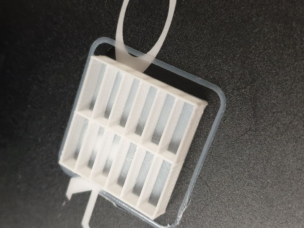

                                Andrew, I just had to have a go with my Aldi printer!
                                I drew up the same 25mm square with .4mm walls.
                                My Cura slicer (3.4.1, I'm happy with this version and have resisted updating), would not print the walls (I checked the layers, before printing).
                                I tried your tip of 0.39 wall and it worked! I have a wall of 0.4 to 0.5 thickness. Quite impressive for a printer that cost £150 (this one is Aldi's black Friday sale one, my other was full price).Printed with PLA filament (cheap stuff- see below)
                                I have found that filament is the biggest factor in getting good prints. I have bought some packs of 25 different colour samples of PLA (10M long, so good for most prints) and not had any problems. Some filament from 3DQF was that bad it went in the bin. I can recommend 3Dfilaprint for good quality PLA.

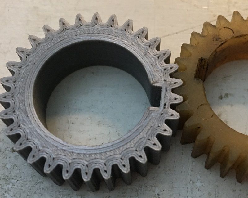

                                          The grey one is a Mod1 20 degree 30 tooth changewheel printed in PLA on a Ultimaker Pro 3 (as an obviously necessary test piece for the printer at work) which is about £1600. 25% density took 50 minutes. The other gear is the original injection moulded Hobbymat gear in perhaps nylon.
                                          The hole is 20mm and with a slight sandpapering to smooth the layers inside fits snugly on the mandrel. You can see that each tooth is two layers fitting tight together then a third not quite going up into the whole of the tooth leaving a small void. The fit with the originals is 'perfect'.
                                          The design was done in Freecad and the outer across teeth diameter measurement is just 7 thou greater than the original.
                                          I haven't done a strength test yet.
                                          In use they fit on a steel bush with a key to join two together with a 8mm hole to go on the banjo stud. I might try a printed bush or even a fully printed pair of gears to reduce the effort of setting gear trains. The possible drawback of running plastic on the steel stud is dirt and swarf pickup making a grinding lap. Perhaps a thin brass tube would help that.
                                          The 20 tooth gear in the set is too small to have a 20mm hole so it has a special bush. This is the first target for printing as a whole. I have limited access to the printer but watch this space.

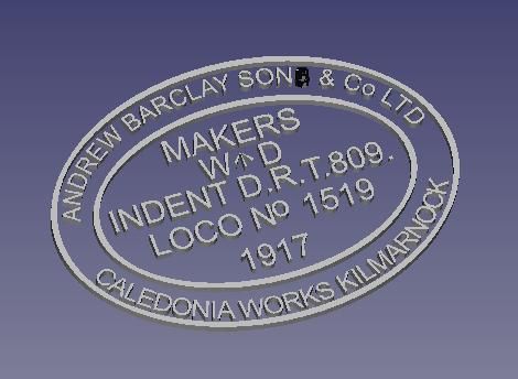

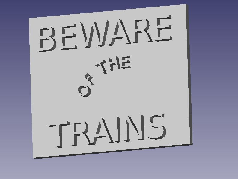

                                                  Ages ago I started a MEW article on producing model signage in software and abandoned it because the draft read like a knitting pattern, only less interesting! Great images, terrible text. The idea was to print the results on a 3D printer, either to make moulds or actual signs. At the time I didn't have a printer.
                                                  Now I've got one, my target is signage again, and it's not as straightforward as expected. I've hit trouble converting text and paths drawn with Inkscape into a printable STL unlike this mangled engine plate which upsets the slicer:
                                                  In the ELS thread Rockingdodge showed a 3D printed box he'd designed in Inkscape and Fusion360 using a method I'd completely missed. While Fusion 360 is also a little tricky with text its much easier to use than other methods I've tried, and I got this STL from it yesterday:
                                                  Not tried to 3D print it yet, but the Creatility Slicer loads it OK.
                                                  Although Fusion360 simplifies working with Inkscape text, converting to STL is done in the Cloud, which takes age. Also, I prefer Linux to Windows, and Linux nearly works. So at the moment I'm experimenting Rockingdodges method with FreeCAD: at the moment complicated and unreliable, but that may be because I'm using the wrong combination of tools.
                                                  Another time-waster: my nephew asked me to print a statuette representing the head of North Korea's Great Leader on the body of Rodin's "The Thinker". This involves editing two STL models available on the web and merging them together. Though I'm sure it can be done, I'm struggling to make it happen!
                                                  In short, I'm Lost In CAD mainly because I'm trying to walk before I can run. I suppose it's obvious in retrospect, but I was expecting setting up the printer to be more difficult than designing in software, actually it's the reverse! Once you know roughly how they work, quite easy to model simple 3D objects like boxes in CAD. Much harder using two or three software tools in concert because they all have to be mastered.

                                                  #449835

                                                    #449845
                                                    IanT
                                                      @iant
                                                      Dave,

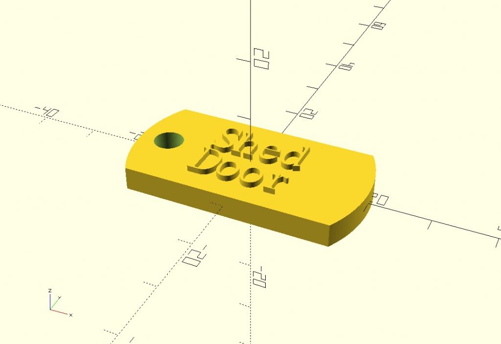

                                                      I have nothing else to compare my Sovol with but basically it comes mostly assembled and can be up and working in about half an hour. I knew (know) very little about 3DP but I had my Sovol working very quickly and it seems to have some of the desirable 'upgrades' that I've seen mentioned in the many Youtubes I've watched – such as the heated glass bed, stiffer bed springs and a direct-feed extruder (apparently better for flexible filament types).
                                                      I never got too far with Fusion 360 myself, so again I don't know how Fusion 'text' works but here is a simple Open SCAD example that I've just 'cut-n-pasted' from a G1MRA tutorial on SCAD by Adrian Johnson (G13DCircle – see Groups.io)
                                                      $fn=180; length=20;
                                                      difference(){ intersection() { cube([length*2,length,4], center=true); cylinder(d=2*length, h=8, center=true); } translate([-0.75*length,0,0]) cylinder(d=5, h=8,center=true); }
                                                      translate([-0.4*length,1,1]) linear_extrude(2)text("Shed", 6 ); translate([-0.4*length,-6,1]) linear_extrude(2)text("Door", 6);
                                                      This copy hasn't formatted very well to here I'm afraid but most of the 'script' is actually involved in the 'keyfob' shape itself (e.g. the rounded edges & hanging hole) – and the actual 'text' part is pretty simple. It probably looks somewhat complicated but actually the script breaks down into a few simple commands that define and merge a few basic shapes. When I first looked at SCAD I was more than a bit doubtful about using it but if you start with a few simple objects then it is something that can be learned in stages whilst still getting useful results.'
                                                      In this example – I just copied the text from Adrian's PDF example and pasted it into Open SCAD to immediately get to this image (which I could print if required – the text being easily edited:
                                                      Hope this helps
