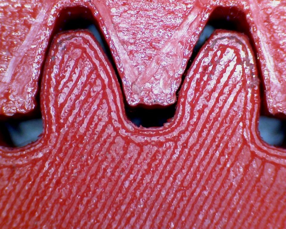

                              #444224
                              Anonymous
                                This is a magnified view of my 10DP internal gear and pinion:
                                The involute curves are a fair representation and the gears mesh smoothly, and just as well as the final metal gears.
                                Andrew

                                  Hi Bill,
                                  Experimentation is only really required to achieve higher accuracy, default settings will in most cases produce a useable part. As you suggest solvent vapour can be used to reduce/remove layer lines on ABS prints, but at the expense of softening sharp edged features. PLA printed with a shell of several outer layers and >20% infill density feels almost indestructible when there are no slight features. I have found that PLA wood filament printed at 0.1 mm layer height results in layer lines that are invisible a foot away – see this 13 cm high rendering of the Gayer Anderson Cat (a standard test of printing overhangs)..
                                  Andrew.
                                  #444228
                                    Looks pretty darned good at 10DP, Andrew [Johnston]
                                    … trouble is, I want that quality at [say] 40DP sad
                                    Edited By Michael Gilligan on 01/01/2020 21:12:50

                                    Andrew Entwistle
                                      @andrewentwistle
                                      Hi Michael,
                                      The 57T Meccano gear is 38DP, I am sure dropping the nozzle to 0.3 mm or 0.2 mm would yield the same quality for 40DP as Andrew's 10DP (at least in the areas where meshing occurs).
                                      Andrew.

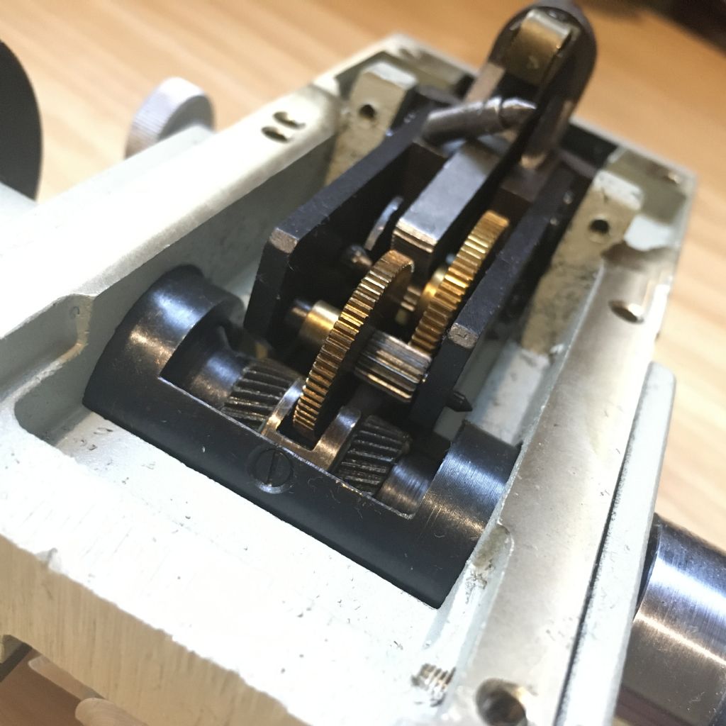

                                      #444232
                                        Posted by Andrew Entwistle on 01/01/2020 21:39:35:
                                        Hi Michael,
                                        Andrew.
                                        We’re certainly heading in the right direction !!
                                        Truth is … I was originally going to ask for that quality at 100DP but reined myself back.
                                        Perhaps it’s a realistic proposition for next Christmas.
                                        … I shall watch progress with great interest.
                                        This [the fairly agricultural focus mechanism from a large Russian microscope] is the scale of gears that I tend towards:
                                        Edited By Michael Gilligan on 01/01/2020 22:02:23

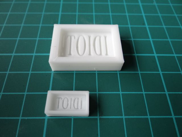

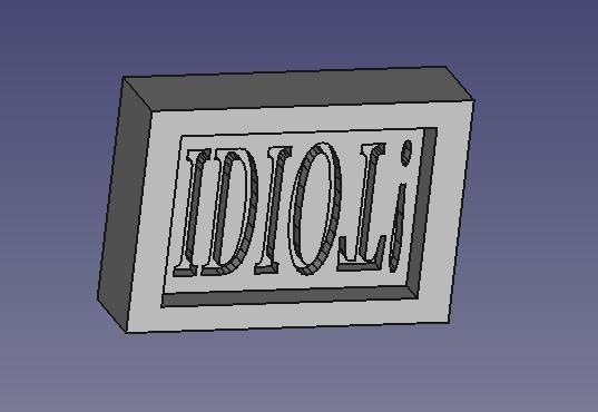

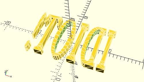

                                                    Now that I understand the limits of this machine in respect of gears, thanks everyone, I'm experimenting with moulds. It's apparent that the software is as important as the printer, and I'd be grateful for suggestions!
                                                    My daughter, who manages a team of young people and the quality of their written work, asked if I could use my new toy to make her a rubber stamp containing the word 'IDIOT!' Being a Linux Fanboy, the following is based on Open Source software.
                                                    I used Inkscape to draw and invert the text. Inkscape is a 2D Vector Graphics editor, ie drawn objects are represented mathematically, not constrained to any particular size or media. Everything is editable and scaleable without loss of resolution. It can rotate, invert, and perform many other graphical manipulations. Excellent for developing 2D layouts thus:
                                                    So far so good, but rubber stamps are 3D objects. I used an extension called 'Path to OpenScad' to generate a 3D STL file. The extension traces the paths representing the text and boundary box and extrudes them by a standard amount. The result is a 3D mesh, displayed in OpenSCAD:
                                                    OpenSCAD is just used to save the file in a format FreeCAD can read (*.csg). FreeCAD is used to add the moulds base and sides to the letters:
                                                    FreeCAD can output the mould object as an STL file, for slicing and printing, oh dear!
                                                    The whole job had to be done twice because the first print came out far too small. (The lower idiot.) Turned out to be a limitation of the extension 'Path to OpenSCAD', which – unlike Inkscape – assumes pixels (dots per inch). As my Inkscape master was defined in millimetres, the result is 25.4/90 too small. There are quite a lot of other tripwire details to get right using this software combination, and I may be overcomplicating the process due to ignorance. Is there is an easier way?
                                                    However, it worked. The top idiot is good enough for this idiot and his daughter! Next post describes a more complex mould using the same method, which – so far – is a failure, cause obscure.
                                                    sad

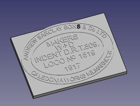

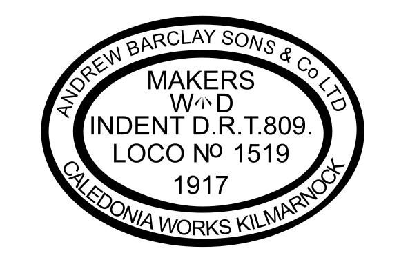

                                                    #444298
                                                      Confident of success, I moved on to a more advanced mould, the original pinched (if my memory can be trusted) from Terrance Holland's ME series on 'The Barclay Well Tanks of the Great War'.
                                                      As can be seen Inkscape can bend text around an oval (actually text can follow any path), alter font size, and draw specials like the government Broad Arrow. Slight flaws in the drawing are due to me experimenting with the shape in hope of fixing problems found later.
                                                      When the engine plate is exported to OpenSCAD, a problem is detected when rendered.
                                                      The 'S' in SONS is mangled. I managed to fix that in Inkscape by tweaking the 'S' paths nodes, but found no obvious error.
                                                      More trouble followed. I've not been able to combine the engine plate in FreeCAD with a separately drawn base. This is the closest I've got, but – although it looks right – the object is illegal and can't be printed. Likely cause is still something wrong with that pesky 'S'
                                                      Although I'm comfortable with computers and like learning new software, this is starting to bug me!
