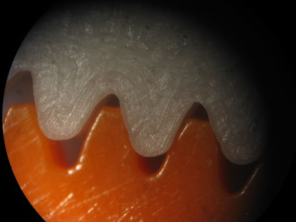

              My results with a 0.4mm nozzle and Cura set to 'Super Quality', claiming 0.12mm drops. First, a close-up of a few involute gear teeth as drawn by FreeCAD's PartDesign Tool: (Blue is background, spur gear is yellow.)
              Second a close-up of my printed gear meshing with a modern orange plastic Meccano gear:
              Sorry about the photo-quality : I've forgotten how to set the camera and microscope up! But the printed teeth are  considerably better than Michael's examples.
              The printed gear is about 2mm oversize partly because I made a mistake setting the modulus. Meccano gears are 'close to' 38DP or 0.7, one fairly convincing theory being they are intended to mesh with a worm cut with a 1/2" BSW thread.  The gears though, irrespective of gear diameter, were all made with a 38DP cutter. Not very scientific, maybe but an impressive practical compromise – meshing is as good as it needs to be at minimum tooling cost. However, a CAD tool has a brain the size of a planet, and it calculates gear diameter correctly from the modulus and number of teeth wanted, and thus draws Meccano gears slightly larger than the original. Next time, I'll reduce the Modulus to 0.65 and should get a better fit. A 3D printer isn't constrained to standard cutter sizes, it can make any gear wanted, including a mild weirdo like Meccano.
              FreeCAD's built-in gear generator only does involute spur gears. However, there's an add-on Workbench (easily downloaded) that does Cycloids, bevels and crown wheels as well, with more control over the accuracy of the curves. Not tested it fully, but it does spur gears OK.
              Printing this replica Meccano 27A gear (57 teeth) took 1 hour 10 minutes. The 4mm hole left for the axle is 3.8mm and will have to be reamed out. Should be able to lash up a motor tomorrow and break it!

                That’s much better than I expected, Dave star
                Very encouraging

                  It''s pretty good for a printed part, but not nearly good enough for me to consider it an involute tooth gear. The moulded Meccano gears are far better in that respect.

                    Agreed, Pete … My ‘very encouraging’ means ‘maybe in the next few years’

                      I would be more interested in 14/16DP. 38DP is a bit tiny and accuracy of the involute form must be compromised as tooth size reduces.

                        Yes, I agree. The CAD image shows what the printer was supposed to do while its approximation of the involute is outed by the photo! Better than Michael's 2017 example though and I wonder how much closer to an acceptable curve a 0.2mm nozzle would get on this basic printer?

                          If accurate tooth form gears are needed from an FDM 3D printer I'd suggest increasing the size of the gears. Teeth say 4 mm width will FDM print nicely at 0.1 or 0.15 mm layers / finest resolution. 1 mm wide teeth, not so much.
                          As with any technology in the workshop, process to be used needs to be selected that will deliver the required accuracy and precision. For high precision small gearing, injection moulded plastic gears as Pete mentioned, or machined metal or plastic cut-tooth gears, are probably still best.

                                    SoD: That looks a rather weird gear tooth shape? It almost looks like two straight lines joined by an arc. I'd expect the involute function to be a smooth curve. Once I've sobered up in the New Year (!) I'll have a go at printing some more (smaller) gears and also thin wall features.

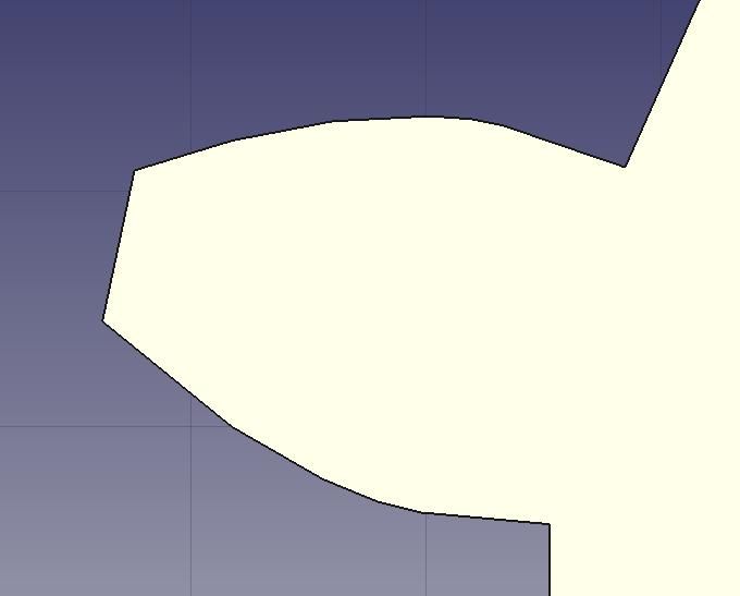

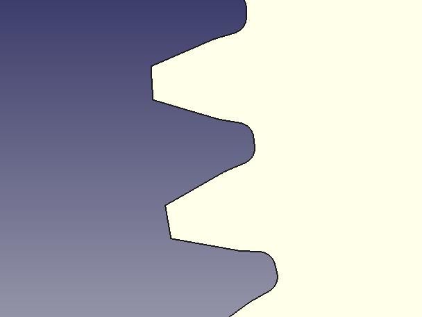

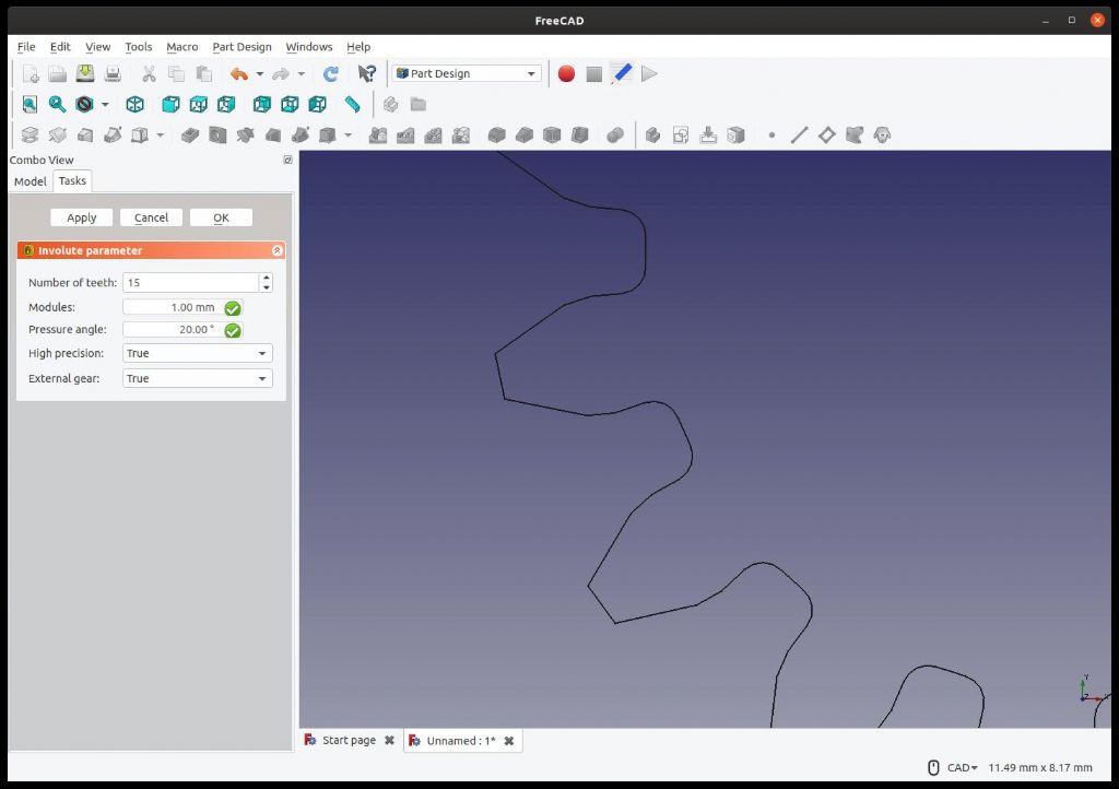

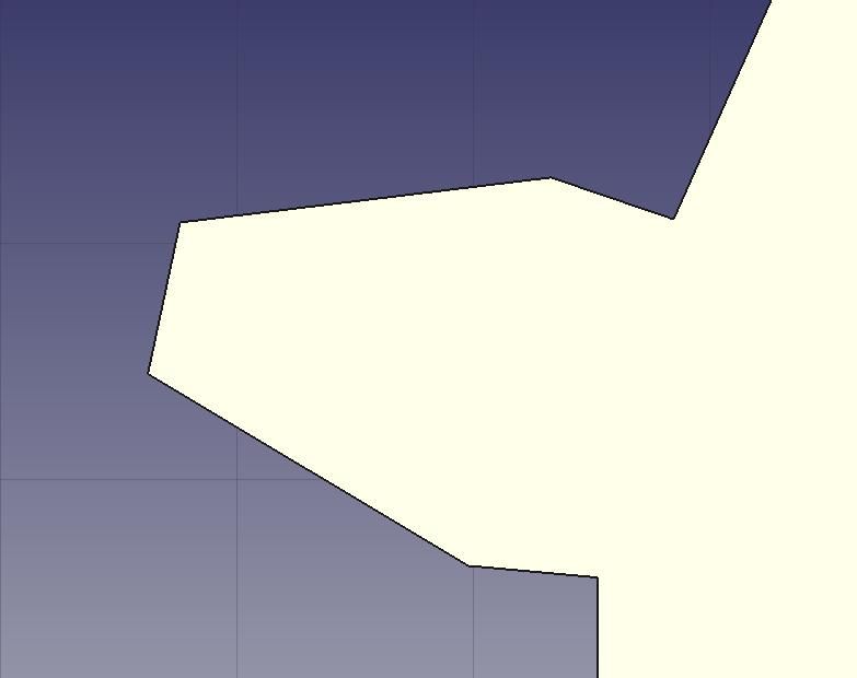

                                            Yes, another interesting diversion into how accurately does FreeCAD render an involute curve?
                                            To print the replica Meccano, I generated the gear with Part Design's built-in Gear button in default high resolution.
                                            Images following are all of 15 toothed Module 1.0 gears.
                                            No 1: Standard Gear button in High-resoultion mode. (Not very!)
                                            No 2. FreeCAD's Gear Workbench (an Add-on download), with the involute approximated by 2 points, very crude:
                                            No 3. FreeCAD's Gear Workbench, with the involute approximated by 3 points, better:
                                            No 4. FreeCAD's Gear Workbench, with the involute approximated by 6 points, good:
                                            Of course, these are all approximations and I've not been able to find a true involute curve to compare them with. Yet another challenge: how would one draw an accurate involute? My head hurts!!!
                                            Although I don't expect to draw accurate gears on a basic 3D printer, the point at which it fails is of interest. I think it would certainly produce an acceptable profile as Engine Builder describes for a Myford-sized 63 toothed gear because, shades of Nyquist & Shannon, the errors are low compared with the size of the gear. Not so with Meccano, because the errors are large compared with the size of the teeth.
                                            In order of increasing pain, with the last two causing most problems, I suggest the errors are due to:
                                            1. How approximate the CAD package's involute curve is.
                                            2. Vibration, stepper motor resolution, backlash, belt-drive indexing and the motors losing a few micro-steps. (Presumably a better printer would be fitted with servos.)
                                            3. The melt and smear characteristics of the plastic.
                                            4. The size of the nozzle and feed errors (too much or too little plastic)

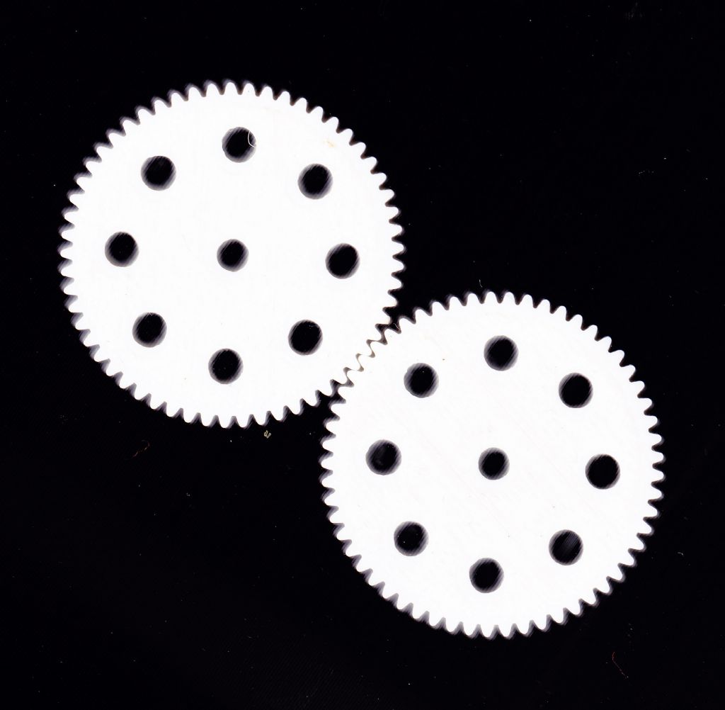

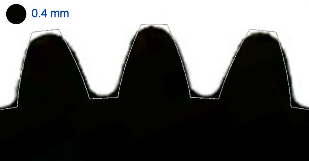

                                                      Hi,
                                                      I printed a couple of 4mm thick Meccano style 57T gears, modelled using the CAMBAM involute gear generator using a quite old 0.4mm nozzle. The first image is a scan of the gears, top face towards the scanner glass. The second image (inverted) shows the deviation from design profile, along with a 0.4mm circle for scale. Material is PLA, 0.1mm layer height.
                                                      57T Meccano gears
                                                      57T tooth form vs involute
