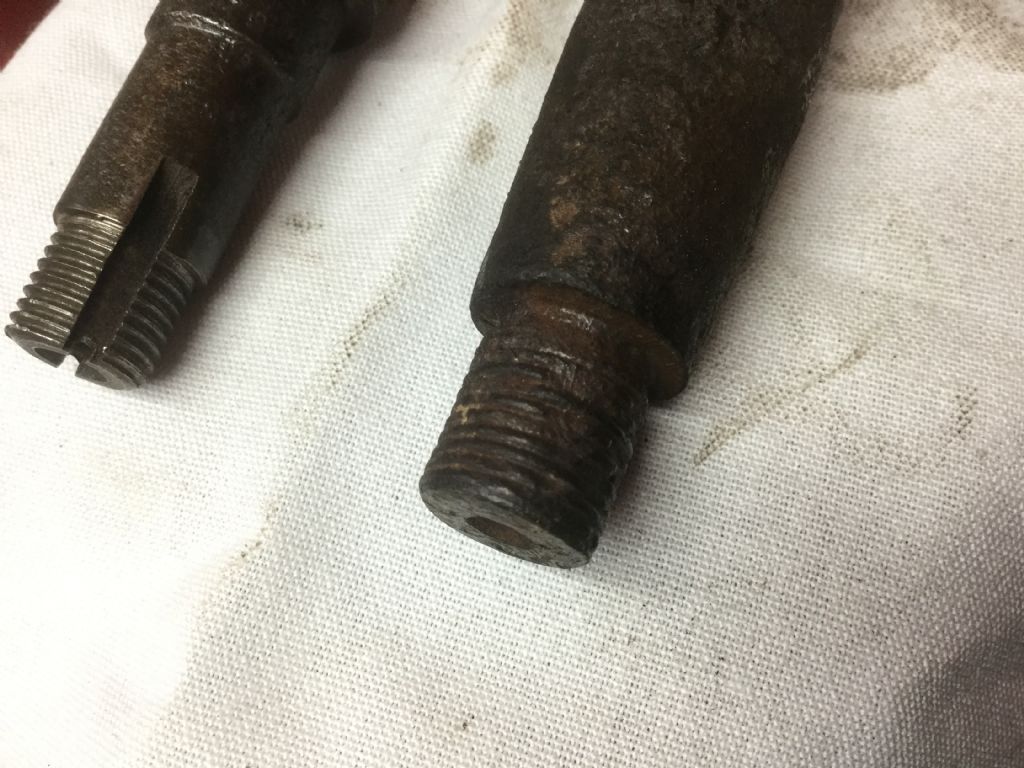

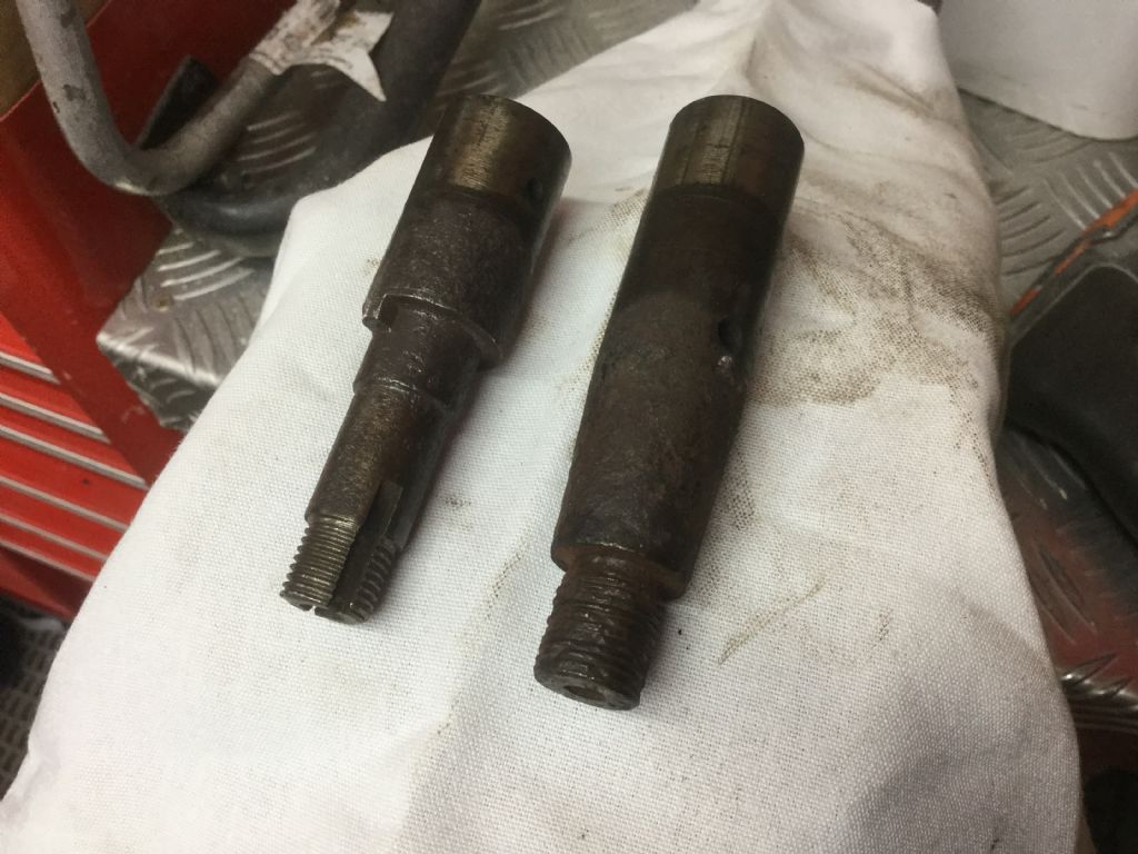

      Started restoring an old Velo engine today……pulled the crank apart and it’s in a pretty sorry state. As far as i can make out the Timing and Drive side shafts are not available as spares, so aside from searching for another crank i reckon there are two options.
      1- Try and repair the original shafts (which are ravaged by rust to varying degrees.) This would probably mean building up with weld and then turning/threading back to spec.
      2- Attempt to make two new ones from scratch.
      A web search reveals that veloce made the shafts from 3% Nickel Steel whatever that is ?
      What do you reckon ?….Thoughts on a postcard please92beebb7-2e51-489c-b984-035121b5c967.jpeg

          Doesn't look that difficult to make new ones, mostly turning and screwcutting with some keyway milling. Try using EN36, a 3% nickel case hardening steel, which would be a useful characteristic for a crankshaft

            Making new is probably the easiest solution but Norman Hyde used a submerged arc welding process to stroke the Trident crank for his 1000cc conversion. The Trident crank is a one piece forging though and minimising distortion was a priority. If you don't feel like taking the job on I am sure the Velo club could advise on a crank restoration specialist. It would be very satisfying to fix it yourself though but cocking it up could total the engine and it would be game over I suspect.

              Mmh i would agree that on the face of it making from scratch looks fairly easy, but the tolerances need to be quite tight, the shafts are a press fit into the crank, with no shoulder to press up to.
              Supposedly tapered 8 thou per inch, however when i quickly measured them today i didn’t find any evidence of that, although due to the condition they're not the easiest things to measure accurately.

                  Hi Alan, I would make new and suggest EN24T condition T is in the heat treated condition but still machinable, very tough material and should be ideal for the situation. Depends on what machine you have to decide on the best tooling HSS or carbide, coolant or not.
                  I see you have pressed them out of the flywheels, what did you use? Whatever it was it should be capable of pressing new ones back in and you can get a good measurement for this from the originals by the look of your photo.
                  Maybe to Velo club or a member will have drawings or maybe someone will come to your aid with a good crank you can measure up, even so I think you should be able to obtain suitable measurements from your old ones, most sizes will probably be a nominal imperial size or you will know what they are to fit into.

                    Alan i will be following this thread with interest, as i am into old motorcycles too. But am more of a BSA and Triumph man, but have lusted after a Velo for years.
                    I would agree with JohnF, en24t is easily available, very tough, and yet not too difficult to machine. I made a new central flywheel for a Norton commando crankshaft out of it years ago, to replace the original cast iron one, and really liked it.
                    Also consulting the fabulous book "The vintage motorcyclists workshop" by Radco, he says its suitable for shafts, spindles, connecting rods etc, and has good resistance to wear and shock loadings.
                    You should have a go at making the spindles, i think i would.

                              Agree that making new ones is quite practical. One nice thing about Velos is that all the taper fits are largely self gauging. Final position is flush with the inside end so if the initial insertion distance is correct the press fit will be too.
                              Be wise to verify the size of the hole in the crank webs as such have been known to stretch over the years leading to inadequate grip. Classic example of this is the BSA Gold Star which has a plain shaft with almost no nip held in by a riveted flange. Fine on the cooking M series, B 31 and B32 but frequently hammered loose by the more powerful B32 and B34, especially D series and especially if the RR gearbox is used on the road.
                              Fortunately opening up plain taper a touch to restore roundness is nearly trivial.
                              If you intend to press it it with an ordinary press you will need a proper guide tube to keep the thing dead straight. If it cocks slightly it will stay cocked.
                              Back in the day the butcher brigade were known to advise welding in place. Which works, or rather doesn't work, about as well as similar efforts on Goldies.

                                  I wouldn't even think about welding, the heat would do all sorts of unpleasant things to the base material. You would still have a lot of machining to do, make some new ones. As others have said, EN24 is probably a good start, not quite as strong as EN27 (3% Ni) but I doubt that would be a problem, at least you can get hold of it fairly readily

                                    Thanks for all the suggestions, reckon i may as well have a go, no point in having the machinery otherwise……….need to find a supplier for the main bearings first though, which at a quick glance are roughly £100 a piece disgust

                                              Yes i think you are correct about the slow taper. The mainshaft bearing is described as having a 1 thou to the inch taper, which is probably why i struggled to measure it from the old shafts. Incidentally that single bearing is £185 + vat
                                              This got me thinking, if im going to the trouble of making new shafts in modern material, then why not modify them to try and improve location. Your solution of adding a head and counterbore had crossed my mind, however i did wonder if this might weaken the crank halves and should they too be remade in EN24t.
                                              if i did go down this route, i wonder if the shafts could be made plain with no taper, just an interference fit and tig welded on the back side, then a more common bearing used, (which should hopefully be cheaper ).
                                              I would be interested on your thoughts.

                                                    Effective though press fits are you need very careful control of sizes and surface finish if full grip is to be achieved. Its very easy to scrape things a touch or even, god forbid, start things slightly out of line initially stretching the hole as the shaft goes in.
                                                    Slow tapers give almost identical grip for the same pressing loads but the actual pressing distance is far shorter and they are mostly self aligning. Its much easier to to do a good job.
                                                    Testimony to the potential issues with high strength press fits are the various patent expansion techniques, such as the SKF oil injection process, intended to sidestep potential issues with surface damage whilst obtaining the maximum retention forces. The BSA riveted flange construction was devised to allow a light press fit sufficient to carry basic crank loads to be used with the riveted flange handling dynamic peaks and ensuring that the shaft couldn't pull through. As with most complicated efforts failure results in a really sorry mess!
                                                    If going for parallel press I'd be inclined to cool the shaft to make fitting easier. But in a normal workshop you have condensation issue to contend with.
