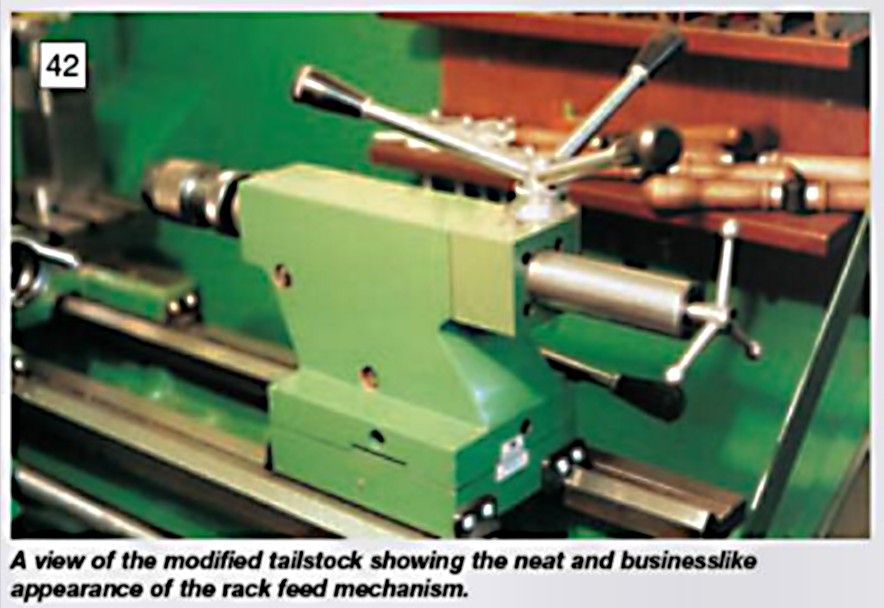

                  Hi Bandersnatch and others,
                  Sorry to be a bit tardy replying – you asked about the rack and travel of my Cowell. It's 8 teeth to the inch and one revolution of the spider gives 3 inches (can't use the double quotes character) of travel at the chuck. I've put a rather poor photo in my album.
                  Well, this all started with me asking about swapping ML7 and Super 7 tailstocks to maintain my Cowell attachment on the Super 7 I've just aquired. Perhaps I will make one for the Super 7 from the soon to be published article.
                  I've already got 3 spider arms and knobs off the mill which are never used.

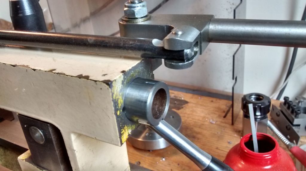

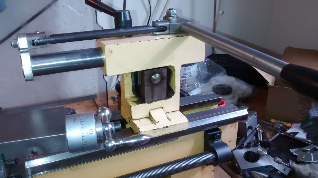

                                  I've done a similar mod to my Mini-Lathe.
                                  It all works very well and I would not be without it now.
                                  I made a longer barrel to give more support when extended and have around 75mm of travel for deeper hole drilling, without the need to reposition the tailstock
                                  A few more pics are in the album.
                                  Martin.

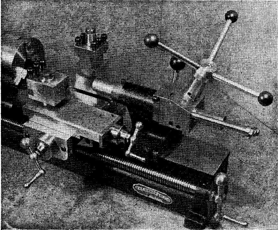

                                    The pictures for the Martin Cleeve articles really won't stand republishing on paper, so instead I have taken Michael's invitation and created an article with links to pdfs of the Martin Cleeve articles HERE.
                                    If anyone does make one, please share it!

                                          Thanks both,
                                          JS is busily working on his prototypes! I have a small cube of metal with a hole and cotter in it as physical evidence!
