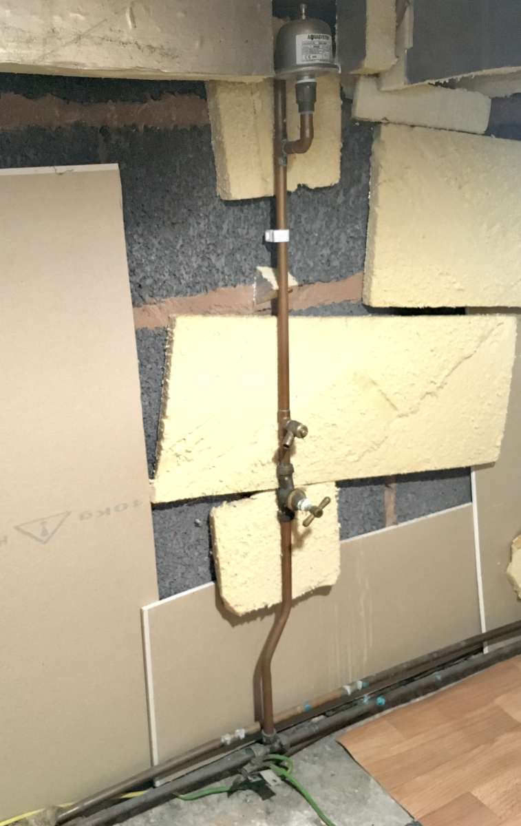

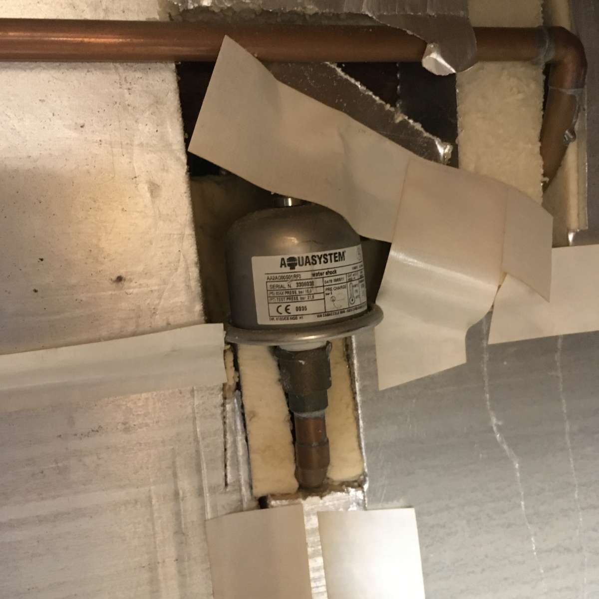

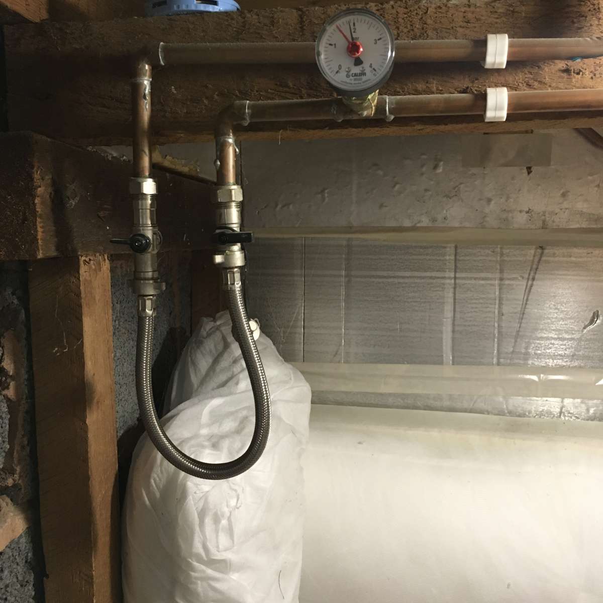

            It’s predictable that this discussion has focussed on the Electrickery, because that’s what I illustrated … but maybe it’s time for me to show you the “insulation” that started me on this journey:
            In order of discovery:
            First,  there was the foam [cushion inserts from a settee]
            Second, a layer of Kingspan offcuts, taped together [some of that tape is carpet-fitter’s double-sided, complete with the backing layer]
            Third, more Kingspan offcuts, wedged in place [perhaps this was easier than putting sufficient proper clips on the pipes]
            Observant viewers will note several ‘interesting peculiarities’ in this installation.
            Please feel free to discuss, if it amuses you.
            IMG_9604.
            IMG_9608
            IMG_9607

              Not a pretty sight Michael, it is a pity they had not used the correct aluminium tape to cover the joints. I think I need to buy shares in the Company supplying these people with solder.

                  The Insulation was done by a skip diving previous owner.
                  At least the wood hasn’t been torched by the plumber.

                        Regarding your first picture…
                        At least there were a couple of plastic pipe clamps used!

                          On derek hall 1 Said:
                          Michael,
                          Regards
                          Derek
                          You might appreciate this shot of the Aquasystem stack, Derek
                          IMG_9626
