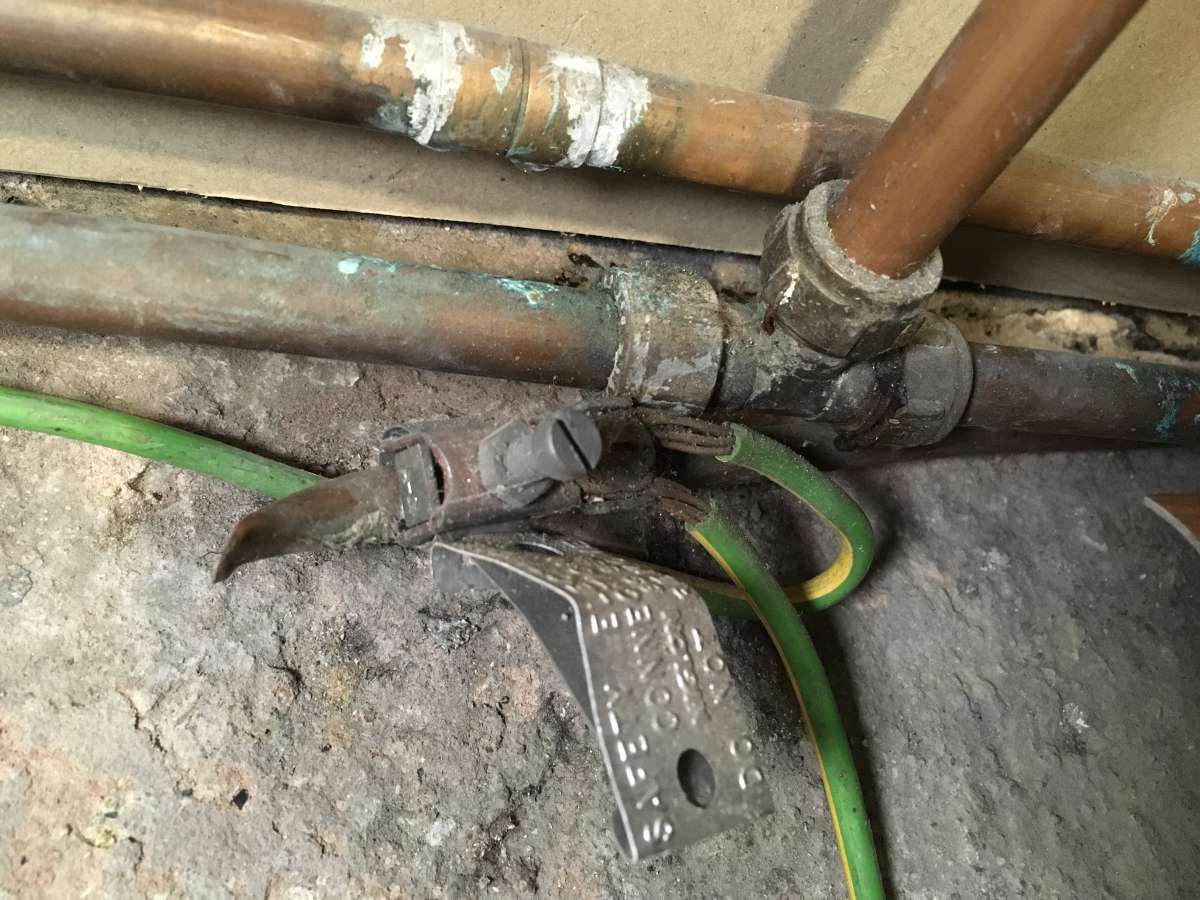

      My related hobby at the moment is attempting to make-good some of the work previously done on the little bungalow.
      I thought I must share this one … today I removed some very shabby insulation in the  under-stairs cupboard, to see what lies behind, and found this:
      IMG_9613
      The Mains Earth is clamped to a small-bore pipe, which has been cut and squeezed closed. So far as I can determine at the moment, this pipe runs through the external wall and is also cut at the other end … it is, I believe, the oil feed pipe for a long-removed central-heating boiler.
      Tomorrow may tell.

      #729429
      Pete Rimmer
        @peterimmer30576
        Is it stripped back and folded or two cable ends in one connector? I don’t think you’re allowed to have a joint in an earth bond not like that anyway.

            #729437
              Two cable ends … one goes into the Kitchen, the other to the towel rail in the WetRoom.
              My main concern being that I think the idiot that connected it presumed the little pipe was ‘Earth’ whereas it’s actually flapping loose … so yes, it’s just acting a connecter block.

                    #729457
                    Wink Hackman
                      @winkhackman25989
                      If it was an equipotential bonding connection to the oil feed pipe then nothing wrong with that. It’s not to be confused with the main earthing conductor.
                      #729461
                        Thanks for that, Wink … I may sleep a little better tonight
                        … I had a nice long shower without being electrocuted, so the investigation will continue tomorrow.

                        Robert Atkinson 2
                          @robertatkinson2
                          Wink beat me to it. It amost certainly equipotential bonding not a main earth.
                          Infact recent revisions of the requiements for electrical installations (BS7671) no longer require equipotential bonding if RCCD(s) are fitted. This is related ot the use of plastic water and gas pipes.
                          Robert.
                          #729468
                          Martin Kyte
                            @martinkyte99762
                            As my gas feed is in copper it is bonded as it should be.
                            Totally agree as to the equipotential bonding of the now defunct oil feed.
                            regards Martin

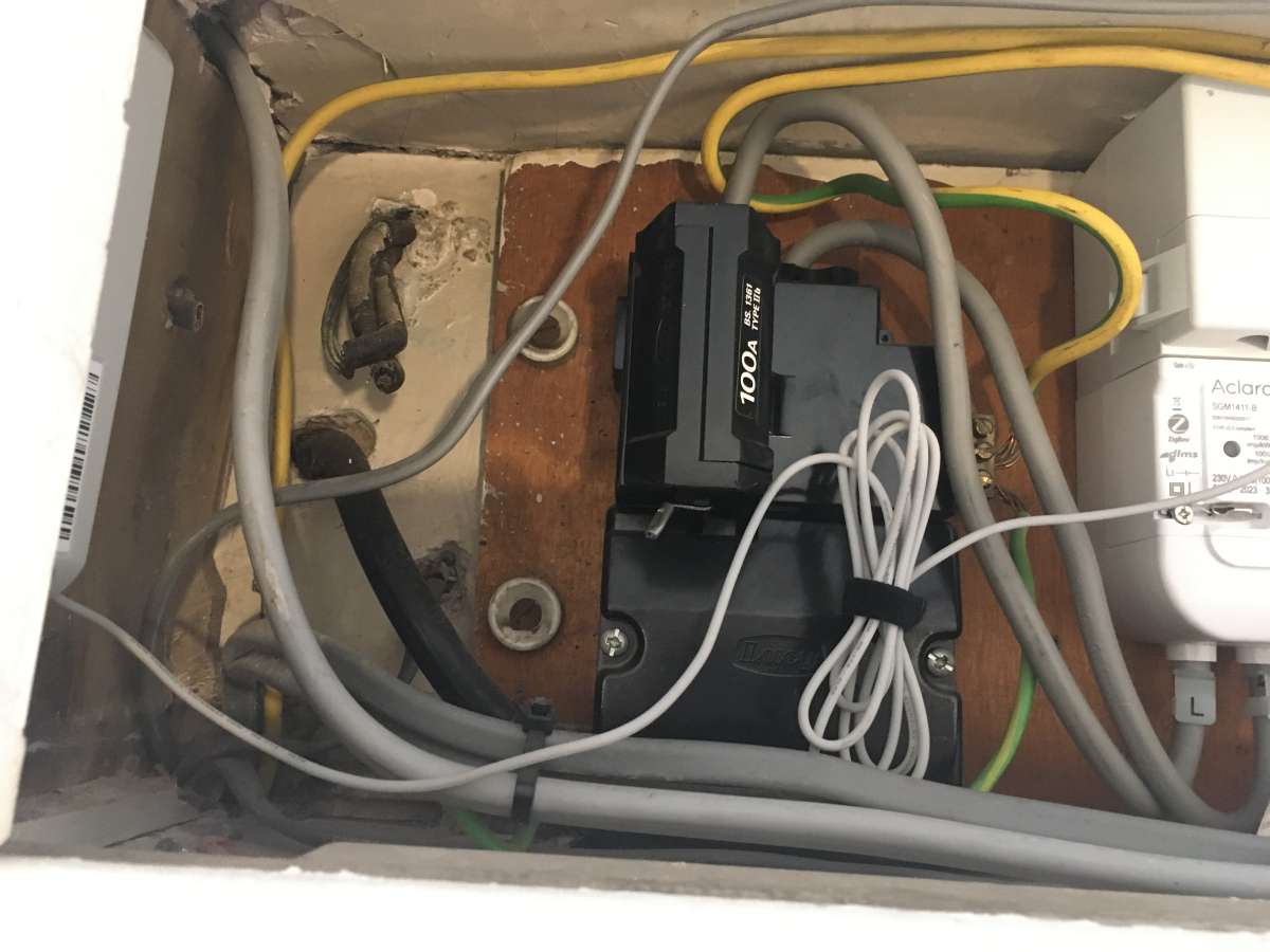

                                A photograph of the service head and incoming mains supply should show whether you have an suitable earthing conductor. If the supplier does not provide a means of earthing you may have to rely on your own earth electrode.
                                It may be worth asking someone with a suitable instrument to carry out a Zs measurement from one of the sockets.
                                RT

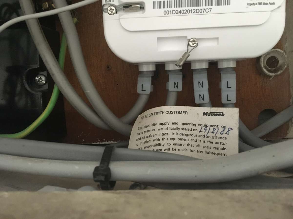

                                #729501
                                  Thanks, RT
                                  Here are a couple of photos:
                                  IMG_9615
                                  IMG_9616
                                  Like ‘most everything else, the meter box is an unholy mess of archaeology  … but when the Engineer from SMS installed the SmartMeter the first thing he did was check the feed for safety … he was happy with it.

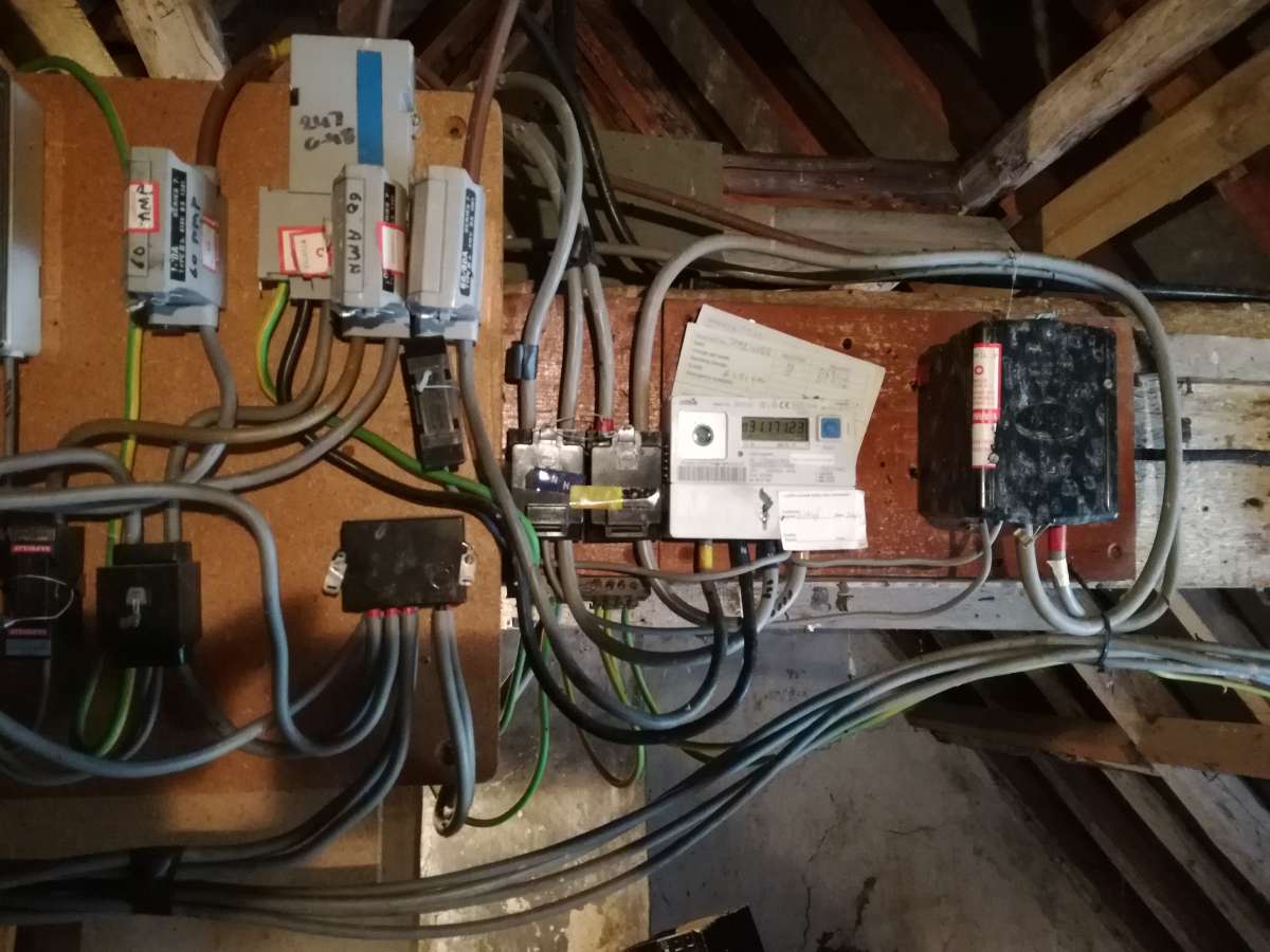

                                      Nicholas Farr
                                        @nicholasfarr14254
                                        Hi MichaelG, I know what you mean by your unholy mess, but I don’t know what to call mine, but it is all due for a retest in July next year.
                                        Electrics
                                        That’s only the half of it, the MCB box is on the other side, and the wiring from that is like spaghetti junction.
                                        Regards Nick.

                                        Master of none
                                          @masterofnone
                                          Hello Michael
                                          It looks from the size of the earthing conductor that you have a TT supply (possibly from an overhead supply), so you will have your own earth electrode.
                                          It is reassuring to know that the meter installers checked the supply for safety.  The connection to the earth electrode should be accessible and the earth electrode resistance should be less than 200 Ohms.

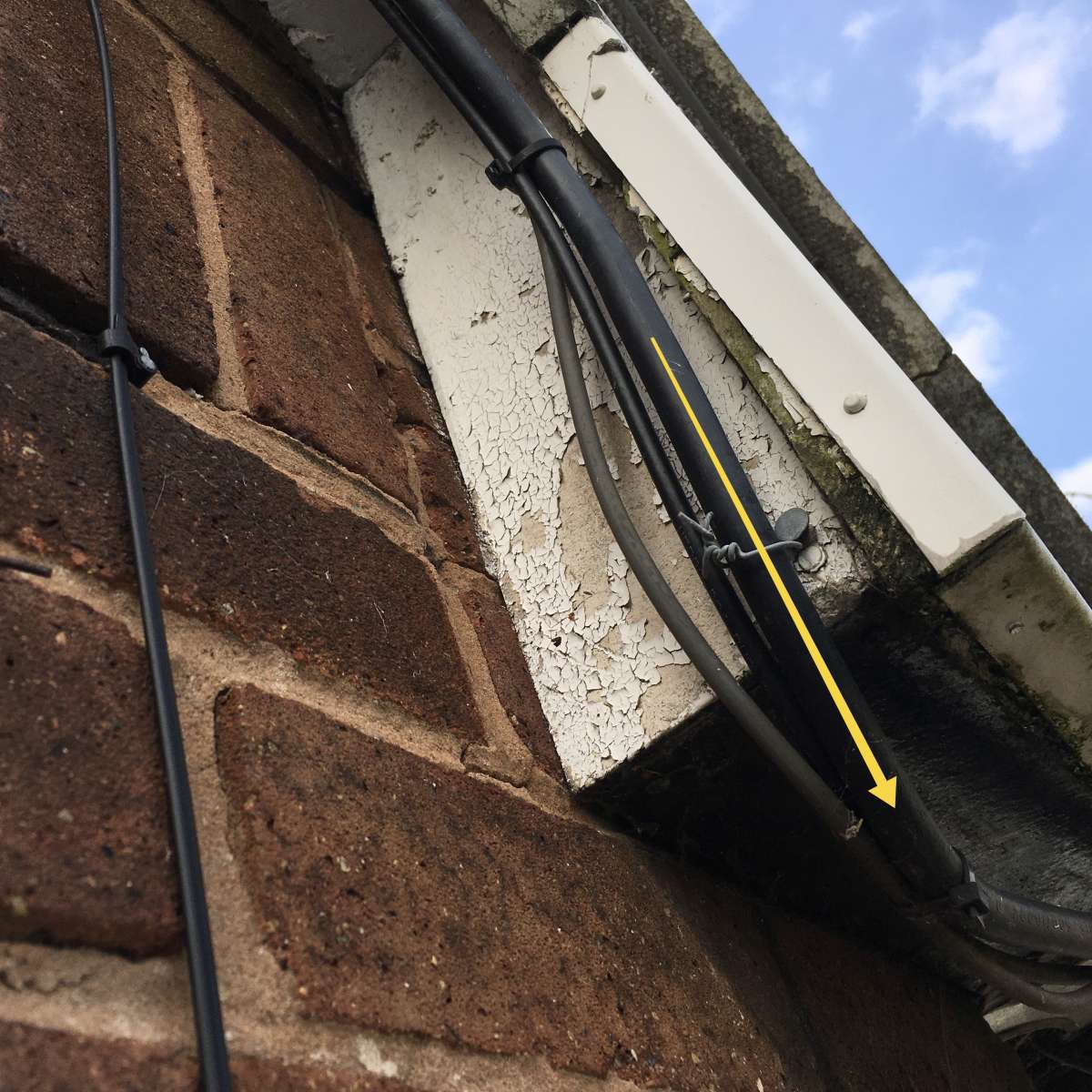

                                              On Master of none Said:
                                              Hello Michael
                                              Definitely from an overhead supply
                                              It runs from a wooden pole across the street, to near the apex of my roof … then down, and half-way round the building … to finally land at that box [which is above the door into the conservatory]
                                              My yellow arrow indicates direction of travel.
                                              IMG_9619
                                              Today has been consumed by other matters, but I hope to continue the Earth-hunt tomorrow … To the best of my knowledge there is no visible rod.
                                              #729581
                                              Emgee
                                                @emgee
                                                Michael
                                                I think you need to have an electrician to check on the earthing arrangements, not possible to see if the earth block is part of the cutout or a loose block screwed adjacent to the moulding.
                                                If part of the cutout it may be a PME system although usually that is indicated by a PME label and I can’t see one on the moulding.
                                                If the supply is not PME and no supplier earth provided you need an earth electrode fitted outside the property and accessable for testing purposes, I think I remember you mentioning your incoming control as an RCD (RCCB) which indicates a TT supply so will need a stake.
                                                Emgee

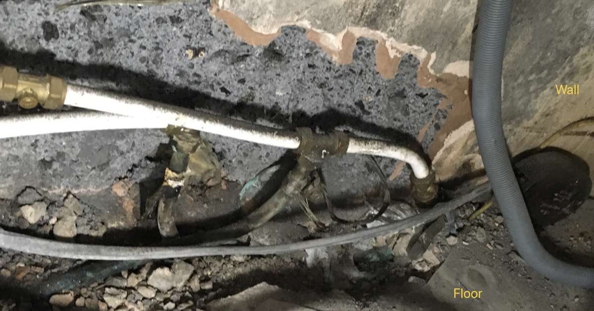

                                                  #729599
                                                    To give you a rough idea of what I am facing … this is what I found under the base-unit after removing the kick-board [with its fancy, but very badly installed, LED lighting] … The Earth Wire is just visible, as I think is some ancient Earth connection.
                                                    Apologies for the photo quality, it was the best I could get at the time.
                                                    IMG_9480
                                                    Image should open a little larger if you click it.
                                                    Analysis and Speculation welcome !
