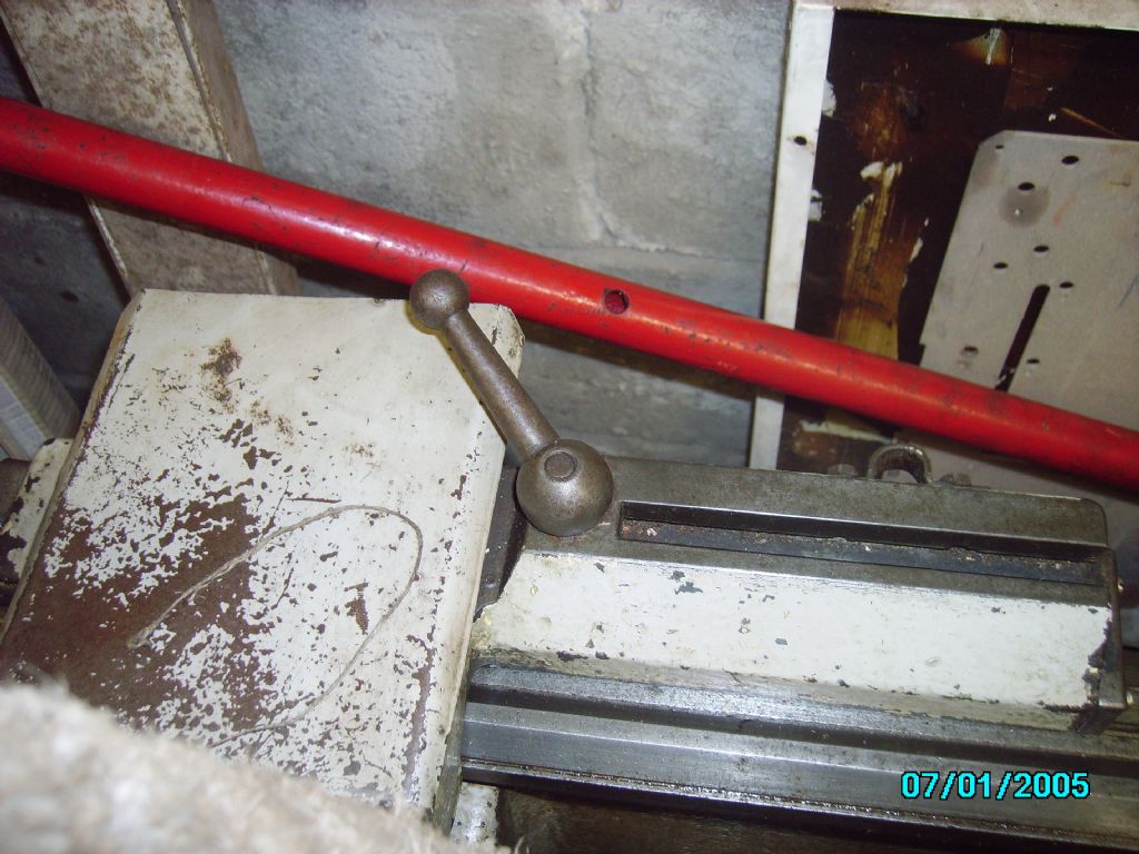

                    Nice one Brian, also there is a ball handle at the back of the saddle next to the single T slot, this is the carriage lock.
                    Phil

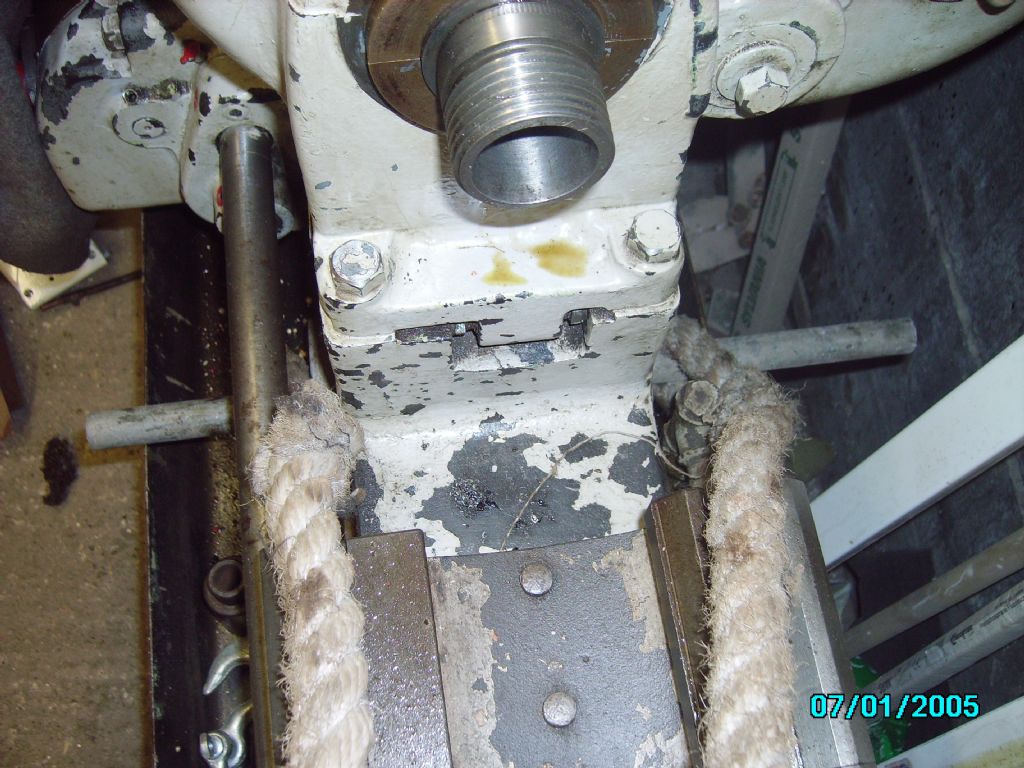

                                        Evening all, I have been taking pics again, first the carriage lock, tighten it down once you have closed the half nuts.

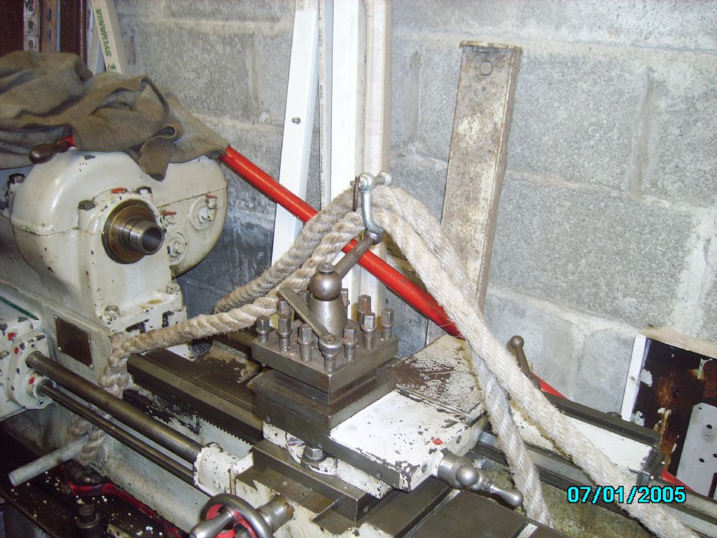

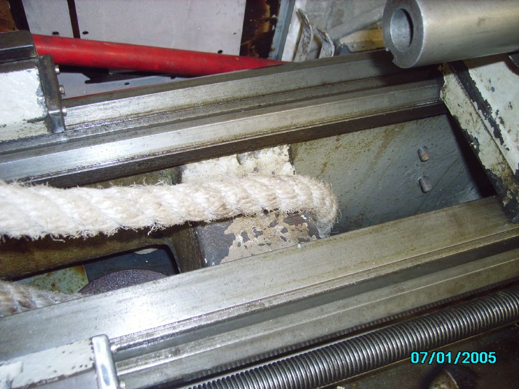

                                        then I got my best rope strop and mocked up how I would lift the bed once the headstock was off
                                        and finnally the lifting point, putting the hook of the crane where the shackle is, just above the tool post.
                                        you can then try a lift to see if it is balanced and move the carriage either way to achieve this, then lock it .
                                        My order of the day would be;
                                        Put the leg bolts back on, or when you try to lift the headstock it will lift the whole lathe if the headstock is stuck with paint.
                                        Remove the headstock, pallet it and trundle it away.
                                        free the legs from the concrete.
                                        Try a lift on the bed, get it balanced and lift the bed just clear of the legs. (now it geta "hairy&quot
                                        take out the legs and place the bed pallet over the legs of the engine crane, blocked up on timber baulks so the crane is not trapped under the pallet.
                                        Lower the bed to the pallet and strap it down.
                                        If you need to go out of a doorway to exit the shed, use the crane one end at a time to remove the baulks and lower pallet and bed onto rollers.
                                        once outside you can pick it up again and place it across the engine crane legs, leaving some weight on the crane, and trundle over the plywood sheets to the road.
                                        If you do it this way, you will not have to move the engine crane with the bed at height (ie to clear the legs) which is very risky.
