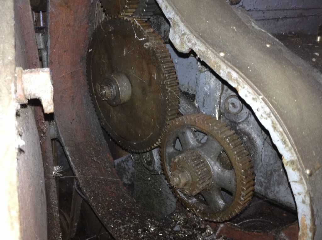

      CHRISTOPHER MILLS 1
        @christophermills1
        Brian,
        Here are the CovMac's back gears.back gears

          Hello Phil and Chris,
          Phil A busy man indeed, how do you find space to work with machines packed in as densely as that?!
          Chris Another picture to ponder over, thank you. It is a bit hard really to make out details, but one thing you could confirm perhaps is that there is only one intermediate change wheel stud between the gear from the reverser cluster and the gearbox input.
          I take it that what the picture shows is a partial view on a 30T gear from the cluster, there is another gear behind it which should be a duplicate of the gear size off the spindle, meshed with a 90T gear on the intermediate stud and that in turn is meshed with a 60T gear, the one with the spokes, using a smaller gear as a spacer. Is that the input shaft into the gearbox they are both mounted on?
          Below all that seems to be a wilderness of spider webs and sundry rubbish.
          This machine is gradually revealing itself rather as the dance of the 7 veils!

            Thanks – Yes, the gearwheel with the spokes is mounted upon the shaft leading into the screw-cutting gearbox.
            I am not sure what you mean by "intermediate change wheel stud"?
            There are five wheels present in the picture.
            I have removed the biggest, and dropped the banjo, to get at bolts holding the headstock on. The nut holding on the banjo is the largest on the machine – it is a real whopper, bigger than any of the Whitworth sockets we have to hand. I had to use a big monkey wrench.
            The gears seem in really nice condition, and have been well lubricated all their lives, I think. I have a few spare gear wheels, also, but I do not think I have the metric conversion 127 t. That would be a really big one, if the big one in my picture is 90 t?
            I will be interested to know more details on your view of the CovMac's screw-cutting gearbox as being "unusual".
            As I begin to understand more, I am the more thrilled with this lathe. I had been watching lathes for 18 months, before taking the plunge with the one I really wanted – this CovMac.
            I am also now beginning to sit with you, on leaving the carriage on the bed for the move. I think a 2 ton engine crane should easily cope with the 6 – 700lbs which I estimate bed, carriage and screw-cutting gearbox may altogether be.
            So, I will only have to remove the headstock, and remove the plinth and legs from their concreting, and then we can move the beast.

                  Chris The intermediate change wheel stud is just a name for the short carrier that holds the big wheel in your photo, there is room to fit two gears on it for a compound drive. More up to date lathes have two such studs, which add a great deal to the possiblities of the output from the screwcutting gearbox. As I think yours is arranged, there are few useful alternative arrangements and the results will be very limited.
                  The gearbox is unusual in that there isn't another choice of ratio change from A or B. The B choice halves the output from the box and gives finer pitch screwcutting. More modern lathes also have a C choice which gives x2 the output. The CovMac has to do that by swapping the gearing down from the headstock and it is all very manual since other useful arrangements do not have space left in which to set them..
                  Have a look around for spare wheels, there is one lying in the swarf tray under the gearbox. If you can find a 127T it will be a bonus; there should also be an 80T and a 40T to make up the set supplied. It wouldn't be hard to lose things like that in the general clutter.

                          To help with our friend Chris' education in lathe things, these gears are not the back gear, but the screwcutting gears. Just to avoid any later misunderstanding wink
                          Regards, Frank

                              Many thanks – where, and what are 'back gears', then?
                              I had imagined these were the back gears, because they were at the back of headstock.

                                  As I am replying on a number of things I will explain back gears as well. They provide a further spindle speed reduction on the smaller hobby lathes and some others where the lowest spindle speeds generally available are just too fast for screwcutting or the machining of large diameter workpieces. With the range you have built into the headstock gearing, there is no need for this lathe to include that refinement. What you are short of are the higher speeds for turning smaller diameter work, the range is 23 rpm to 450 rpm in 8 steps and 450 rpm will not give a decent finish on stuff smaller than 3/4 inch or so in diameter. Horses for courses I'm afraid. This machine was built for larger work and would do that superbly.

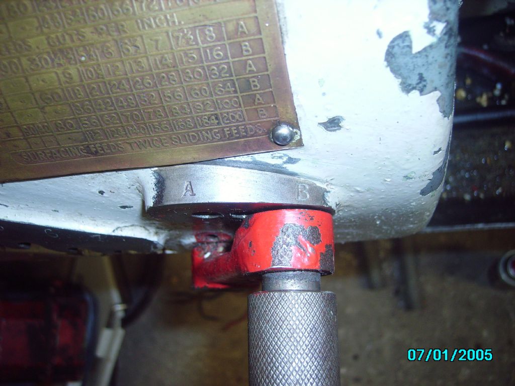

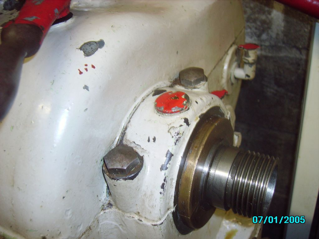

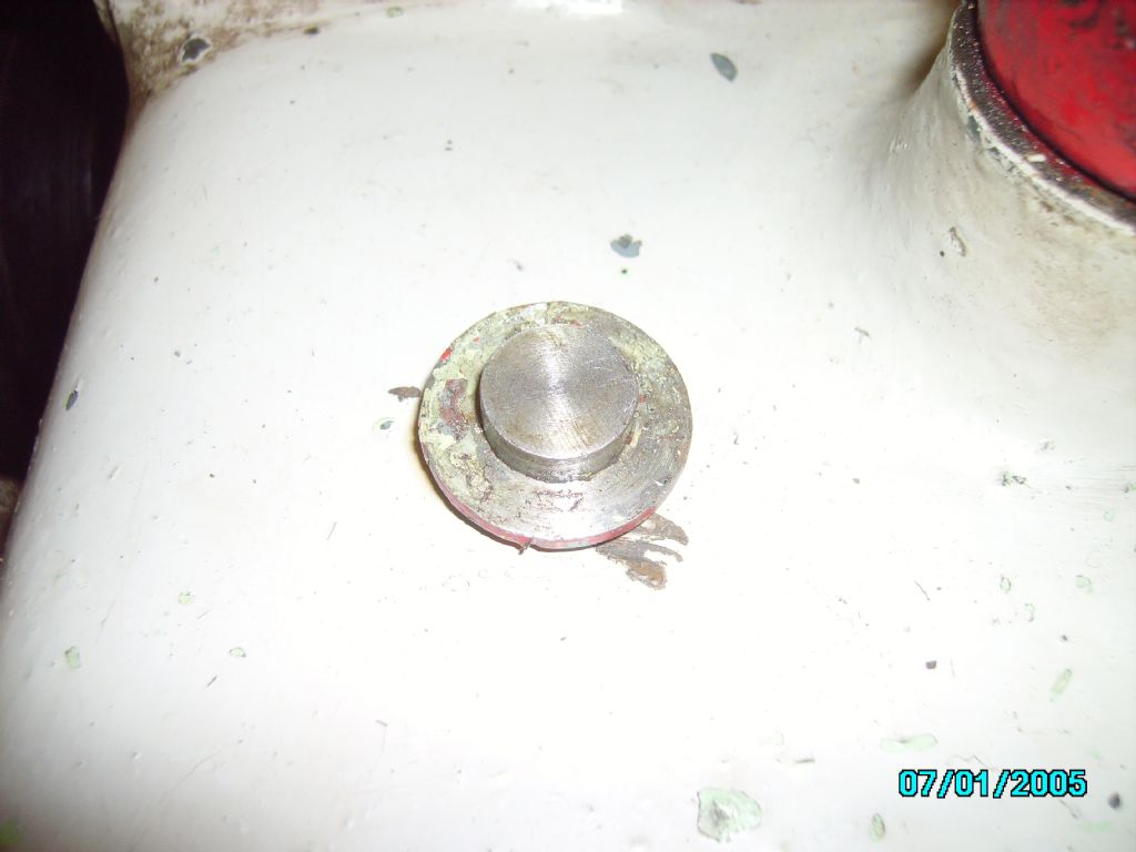

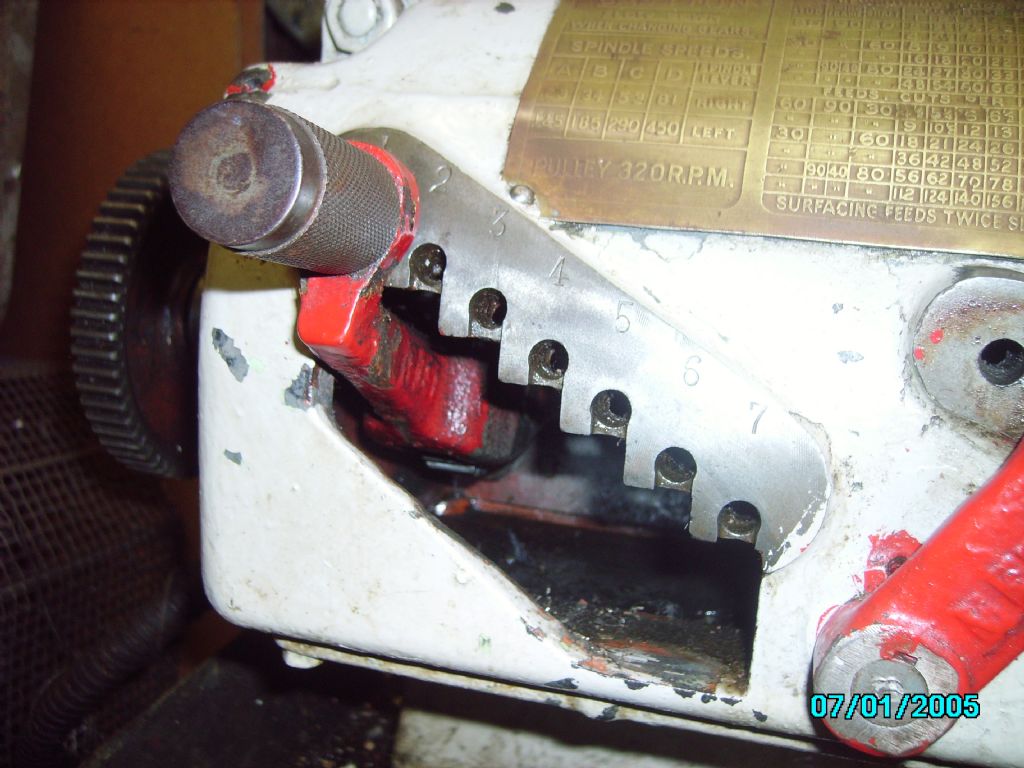

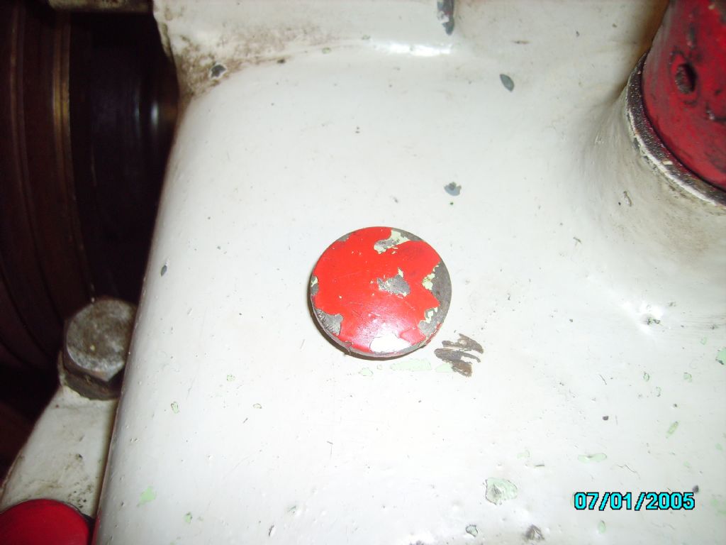

                                          Hi Guys, here are the pics as promised, Chris, top and bottom view of the oil cap from the main bearings, Brian pics showing the position markings on the screwcutting gearbox. Looking at pic 5 it looks like the cover will come off without disturbing the bearings.( I think this is what you wanted, if not ask away) I got the Varnish on, rain arrived early evening as you predicted. Probably at the shop tomorrow, then again friday, Thursday it's back to Jims as he has screwed his central heating, and I have to fix it, so if I am good, and it doesn't take all day, we might get a play in his workshop.
                                          Phil

                                            Smashing – many thanks for all of this. I am missing at least one of these main bearing oilers, definitely.
                                            On the main spindle, where it exits the headstock, before the spindle threads, there is a substantial brass collar, which looks as if it is in two halves – are these the actual main bearing shells?
                                            It might seem that replacing CovMac spindle bearings might be at least a job easily accessed, if need be?

                                              Hi Chris, Yes they are the spindle bearings, they will be some sort of bearing bronze. Yes very easy to replace, but quite a bit harder to scrape to size and get the spindle running right. The great thing about these machines is that you can make most of the parts that wear out in a basic machine shop.

                                                Thanks for the gearbox slot picture, it is as I expected. Did you get a pitch for the leadscrew?

                                                I would leave the spindle bearings alone certainly for the time being; I think you have plenty to do without adding those to the list
