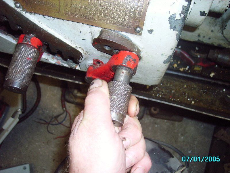

      Hi Chris, Is the knurled knob on the right hand scewcutting lever able to rotate? If it isn't and the knob won't pull out against the spring, the pin will not release from the hole, and it will not move, I am going to my workshop later, I will check on mine.
      Phil

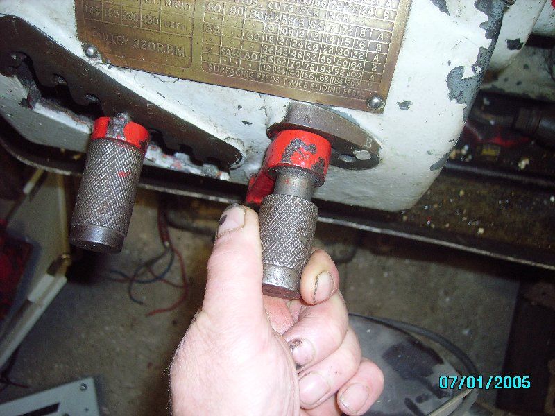

          covmac 016.jpgHi Chris, Is the knurled knob on the right hand scewcutting lever able to rotate? If it isn't and the knob won't pull out against the spring, the pin will not release from the hole, and it will not move, I am going to my workshop later, I will check on mine.
          Phil
          OK, I Bin an gon an Dun it!
          here are a couple of pics, you can see the amount it needs to pull out to disengage the pin from the casing, mine moves freely between the three positions without having to turn the gearbox over, but yours has been stood a long time and may need a turn to free the gears, The knurled knob should rotate freely, and pull out approximately 3/4"

          CHRISTOPHER MILLS 1
            @christophermills1
            Phil,
            Many thanks for going to this trouble – I had not realised until I saw these pictures that there are three positions, A, B and, presumably, a neutral in between.
            I will get the Plus Gas onto my lever!

              Blowing up Phil's picture which also shows the brass plate on the gearbox, the A and B selector positions are clearly visible and relate to thread counts on that plate.
              I can't figure out yet what the central position between A and B was for, a neutral possibly as you think. It is odd.
              That is normally achieved from a mid point in the reversing cluster down from the gear on the end of the headstock spindle; you will see that bit inside the door covering the change wheel enclosure.
              Good luck in getting that bit freed off again, it will behave eventually but might need some heat and a good soak in Plusgas to show it who is boss.

                    In Chriss' last photo, the RH handle looks bent. In the first photo in the greenhouse it doesn't. It may just be the perspective of the wide angle camera but if not, could the handle have been damaged in transit? That would possibly explain why you can't pull the plunger and release the arm.
                    Murray
                    #164145
                    CHRISTOPHER MILLS 1
                      @christophermills1
                      Dear Murray,
                      Many thanks, but the two photographs were taken same time, different angles – the lathe has not been moved yet.
                      I feel the lever is rusted up. Phil supports the view.

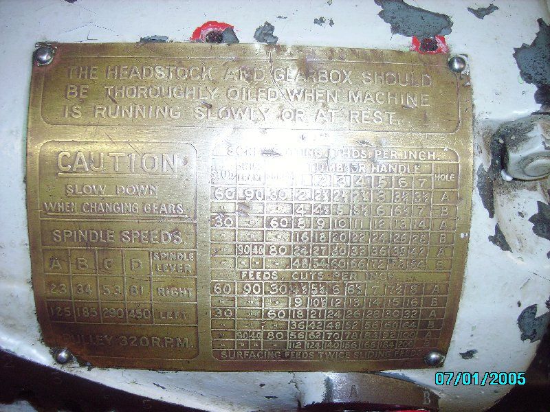

                          Many thanks for the close up of the Covmac's brass plate on the screw gearbox. I am beginning now to understand the controls.

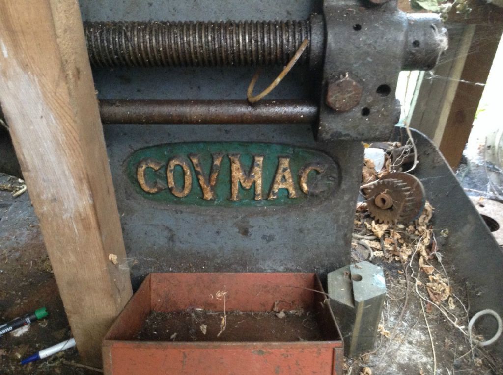

                                  CHRISTOPHER MILLS 1
                                    @christophermills1
                                    detail
                                    Thanks Ady1 – this lathe is indeed very dirty, and you are right it needs a thorough clean. Some of the little oil filler caps need replacing, too. And it looks like it is missing two big oilers on the top headstock main bearings.
                                    Brian, I am glad you like gearboxes, as my acquiring this lathe has partly been prompted by deep curiosity about gears. I would really like to know how a gearbox works. I drive automatic cars, and once tried to imagine how an auto gearbox works – had to quickly stop thinking about that.
                                    Attached is a close up of the fixings for lead screw and power shaft on said CovMac.
                                    It looks to me like there will be nothing fixed on the bed, lug-wise, once that bracket holding the two rods is unbolted. The three drilled holes in that bracket, are they for oiling?
                                    The sleeving to the end of the lead screw might also need removing.
                                    You are probably right about leaving the carriage on the bed, but it will be the first time I have ever used an engine crane, and I am a bit nervous about it. I am going to have to remove it anyway, for the restoration, and if it just slides off, as I hope, I think I may do it.
                                    Using a steel rod through the eyehole, under the headstock, and one to the right, using the step to the bed, where it steps up towards the tailstock, I think we will balance it there, on twin chains. I will have to be careful the chain does not impinge on lead screw or power rod.
                                    Reading information on Phil's brass plaque, regarding spindle speeds, I just don't understand – it seems to suggest that any chosen set of positions, for the two spindle speed levers, gives two different speeds? How can that be?
                                    It clearly says (seems to me) that with both levers each set to position "D" it gives either 61 rpm, or 450 rpm. I am clearly missing some thing here – but I think I am personally still a few sandwiches short of an engineers' picnic
                                    What do you make of that?

                                                  4 Your interpretation of Phil's plate Well yes, I agree with you, the gearbox would crash, so I'll look at that too and try to unravel it; it can't be as you are reading it

                                                    The Spindle speeds all make sense if you look at the setting for the lever called 'Spindle lever' This is the right hand lever that moves the dog clutch inside the headstock.
                                                    You have 23, 34, 53 61 rpm with the lever to Right and 125, 185, 290, 450 with the lever to Left all respectively for the selector lever positions A, B, C and D
                                                    Does that help?

                                                      Tomorrow, I am going to sit down with your words on one side, exploded view of the Covmac headstock, showing gears, on the other side. And I am going to study….
                                                      Your levers take makes sense if the right hand lever has only two positions, but I sort of think it has four, like the left hand one. (May be wrong, here, though, and I am nowhere near the lathe to check.)
                                                      And on Phil's – both left and right levers are shown as possessing four positions A,B,C,D each, if you take each line as positions possessed by the lever. Each do seem to have four positions A,B,C,D.
                                                      I think there is some key we are missing, so far, some occult device.
