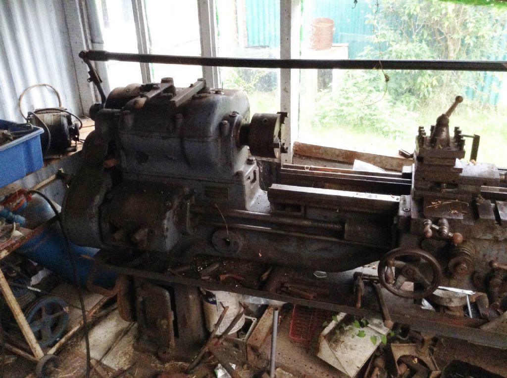

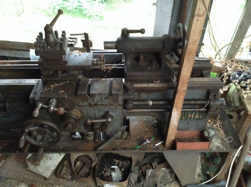

              CovMac 13 (2)CovMAc
              #163865
              CHRISTOPHER MILLS 1
                @christophermills1
                There is a visual of my CovMac lathe, still concreted to the floor. Beneath the grime of years, I think it is in good shape. Needs cosmetic attention, and a thoroughly good clean.
                Chris.

                  It suddenly occured to me today that when you have the lathe bed supported by the engine crane, you might find the bed is long enough to bridge the wheel forks, in which case I would be tempted to lower it onto those, retain some tension on the crane to ensure it remains upright and use ithe crane like a wide wheel base trolley.
                  It will save all the lashing etc I mentioned earlier. I am also inclined to recommend the hammer drill route to break up the concrete, in preference to my earlier suggestion.
                  Looking at your pictures, it IS a big beast isn't it, but I'm sure it will sparkle in a new home

                    #163908
                    Phil Whitley
                      @philwhitley94135
                      Is that piece of wood a roof support? I want to go there and tidy up! I looks like he has lots of interesting bits and bobs I could put to good use.
                      Phil
                      #163919
                      CHRISTOPHER MILLS 1
                        @christophermills1
                        Phil,
                        The wood strut is indeed holding up the roof. It is to be replaced by a scaffold pole before the CovMac comes out.
                        There are a million useful looking bits and pieces.
                        It includes five chucks, but some are rusty. How rusty can a chuck get before it is past renovation?
                        The fixed steady, a wonderful piece of artwork, has one every rusted (solid) screw – how best to deal with that?

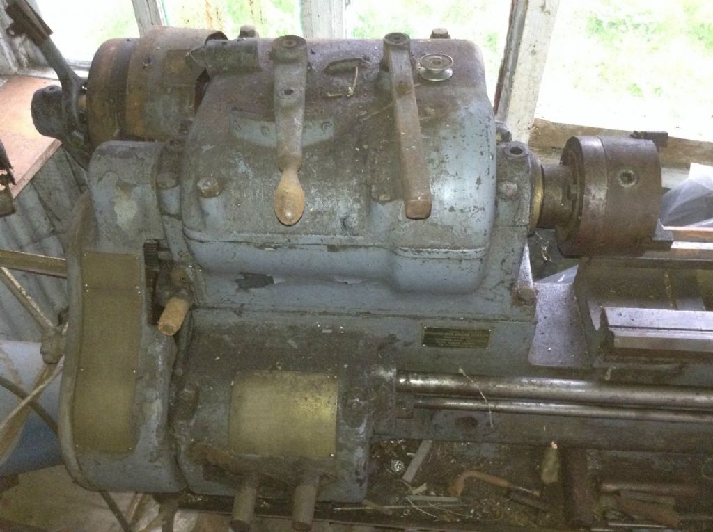

                              headstock
                              Here is a more detailed photograph of my CovMac's headstock. The right hand lever on the feed gearbox is solid. The left hand one works fine, and the gearbox turns okay, when you rotate the chuck. The lever is either a speed changer, or a reverse?
                              The patch of darker colour on the headstock, under the big speed lever on the top, is, I believe, the lathe's original colour, darker than its battleship grey repaint. I wish to restore it to that original colour.
                              Chris.

                                I have successfully cleaned up chucks and other pieces with wire wool and light oils, Scotchbrite pads are also helpful with a gentle abrasive action to polish up otherwise cleaned surfaces.
                                Michael G's tip about wicking in penetrating oil is the way to go, with or without heat to help it. You can also use a paint stripping heat gun to advantage, although flame is quicker.
                                If you can lock the spindle against rotation to remove the chuck, I would stongly recommend unscrewing it using a bar across the bolting on the back plate as a lever and shock it free with a clout on the end. Don't use the chuck key, it might work but if not you are likely to break off the square or worse, split the square socket in the chuck body.
                                I can't advise on the freeing off on the top lever that is solid other than trying gentle persuasion with a rubber faced dead blow hammer in both directions on the end to promote some easement. Without knowing what it moves internally I wouldn't go beyond that without opening up the head after you get it home.

                                        You may well find the stuck lever will move when the other lever is in one position only or once the lathe has run. Harrison's can be a bit like that. Force last resort.
                                        SteveW

                                          I have read it through. The wooden bar that puzzled you operates a clutch on the outside of the headstock, running it overhead allows the operator to use it anywhere along the lathe. So, an original feature for you to preserve.
                                          There is a very helpful picture of the open headstock with the lid off; the left hand lever selects the speeds, three of them I think, the right hand lever [the seized one on your machine] is a reversing lever, in use it operates a sliding dog clutch on the main spindle just behind the chuck end of the headstock. That will have enjoyed oil splash in running, so I imagine the handle pivot through the lid of the headstock is where the tightness lies. It should be easy enough to free off with the cover removed and access for penetrating oil from both sides.

                                            Brian – the seized lever is actually on the feed gearbox, not the main spindle gearbox. It is the lever on the right in the very bottom of the headstock picture.
                                            It seems seized, as all the others have a spring action, before you move them, and in this one there is nil spring, it seems completely solid.
