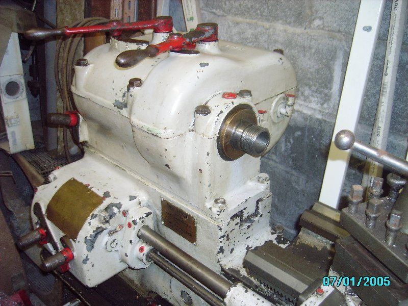

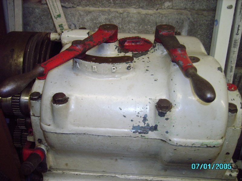

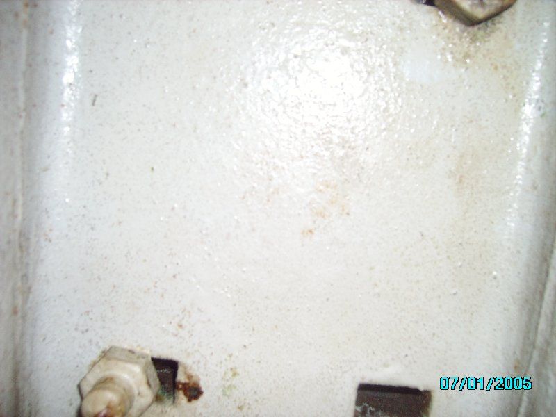

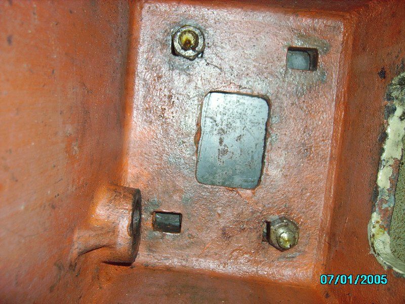

                          Hi Chris, Cut a long story short I think the Covmac is emminently stripable! here are two pics showing inside the column and the legs
                          The red one is the headstock column, there are two studs and nuts but you will note 4 holes, the other two have not been drilled or tapped It is the same at the other end, (bit of a bad pic) but you can see two studs and nuts again, and two apparently unused holes.
                          If you remove all the belt covers and gear covers, motor, motor plate, then the banjo with the gears on it, you will see these two bolt heads
                          If you remove these two, and these two under the spindle
                          Then fit a chuck or faceplate and place a sling round and behind the chuck, and round and behind the vee belt pulley, and as far as I can see, the gearbox lifts off. You will need to make careful note of the number and position of any shims that may be in there (there may be none) If you then remove the nuts from the studs holding the legs on and remove the studs (they will probably come out with the nuts) you could lift the bed assembly with a fork truck, remove the legs, and lower the bed to the floor. As I said before if you remove the saddle you will first have to remove the lead screw and the feed shaft And without knowing how they disconnect from the feed/screwcutting gearbox, this process could be simple, or complex, I simply don't know! If you do remove them, you could then remove the saddle and apron, and the feed/screwcutting box as well, leaving you with some still very heavy, but much more manageable pieces to transport.
                          The top two levers, left hand one is the four speedchange lever, right hand is the back gear, or high/ low change giving eight speeds, four in low/backgear, and four in high. Sounds complex, but it isnt.
                          Tumbler reverse lever, this reverses the direction of the feed/screwcutting gearbox, and thus reverses the direction of the leadscrew for cutting left hand threads, and any other process needing the opposite rotation.At least, that is my take on this lever, some also have a neutral position so you can operate the lathe without the external gear train and the feed box turning, which make for a MUCH quieter lathe!!
                          saddle/apron controls, from the top. Small "ball" handle operates the top slide (AKA compound slide, which can be adjusted around an engraved protractor scale to turn tapers and for screwcutting. Small red handwheel operates the cross slide, which moves the compound slide and the toolpost across the bed. Large red handwheel moves the whole saddle along the bed. Round knurled knob in the centre of the apron switches the feeds between "sliding" (up and down the length of the bed) and "surfacing" which powers the cross slide backwards and forwards across the bed. Below that is an oil nipple (not grease!) The little red three position lever to the right selects the feed direction with a central neutral position, and the ball handle just above that opens and closes the half nuts for screw cutting. Bolted to the end of the apron on the extreme right next to the two T slots is the leadscrew indicator, sometimes called the screwcutting dial, which reads out the position of the saddle in relation to the threads on the lead screw. Once again, sounds more complex that it is in reality. The golden rule with all levers is do not change gear with the lathe chuck revolving!

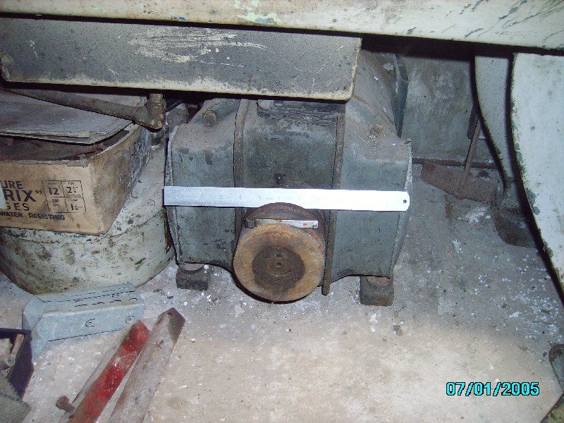

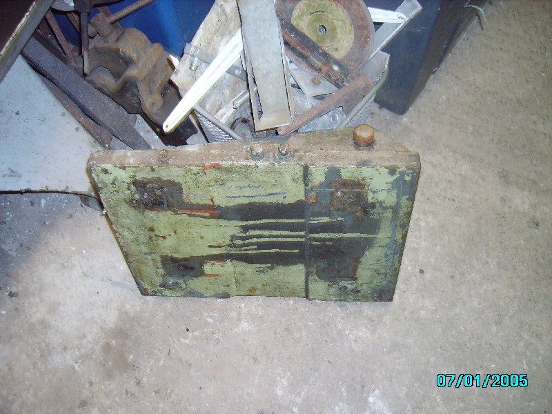

                          The motor plate, solid cast iron one inch thick, and I can barely lift it!
                          The motor, and yes, that is a 12" rule! I can just about drag it across the floor, I would guess about 2 1/2 to 3 cwt.

                              Where is the motor on your Covmac? I have just realised that the cast boss you can see inside the headstock plinth is where the bolt used to adjust the belt tension goes through. That is why the door is there, to get to the belt adjustment.
                              Phil

                                Mine has the thick iron motor plate, like yours, but the motor on mine is much smaller. Mounted to the rear base of the headstock end, it has twin 'V' belts which run up at about 60 degrees, and attach to the back gear side of the headstock. They do not go anywhere near the headstock plinth – miss it out completely.

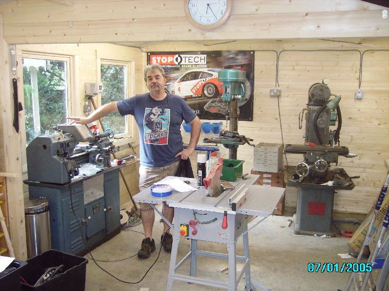

                                    Hi Chris, got your emails, Your lathe seems almost identical to mine, and the conehead of flickr although that seems to have a slightly different feed box, and no plinth with cupboard. I think your motor fixing is exactly the same as mine too, If you look inside the "cupboard" there is a large nut and thread which is attached to the motor plate, and adjusts the belts. No dismantling to do, unfortunately that is how it is at the moment, but it will be soon going back together and traveling a few yards to my "new" machine shop across the other side of the main workshop
                                    I think maybe you could remove the saddle like that, but how would you lift it clear without damage to the lead screw, it is VERY heavy. you could separate the apron from the saddle (apron is the bit that hangs down the front with the controls on it) then remove the saddle, then the apron, then replace the lead/feed end bracket. I have never done this however, so I am only assuming it is possible!
                                    The dismantling does seem to be very straightforward, as you say, the 30's/40's construction is basic, rugged but also simple and uses a few bolts to hold the whole thing together. Now I have had a good look at mine, i realise it is actually simpler than I thought, and I could have continued stripping mine if landylifts Hiab hadn't been able to lift it.

                                                  Hello Chris,
                                                  Use a decent 1 inch wide, 8 inch long cold chisel and lump hammer to chip away the grout, starting about 1 -1.5 inches away from the leg. Don't tap at it, give it some wellie.
                                                  Chip towards the leg and step the cut back away from the leg if needed to deepen it. It should come away in satisfying chunks if you work all round the leg. You might also find the leg with the deepest grouting is bolted down to the floor. If you can't shift the bolt head with a well fitting ring spanner, belt the head end, using a brass drift to protect it from bruising and try again. The shock may well have 'sprung' the thread .
                                                  If the installation is old [WW 2] the bolt head may be leaded into the floor, it was the practice in those days.
                                                  If all else fails, hacksaw off the bolt head or split the nut depending on what you find
                                                  Regards

                                                    Hi Brian,
                                                    I am happier, by reading this advice. The lathe was put into position in the early 1990s, we believe. It looks very ad hoc, and I will be surprised to find it bolted down, too.
                                                    This was an old boy, and I don't think he considered the lathe might survive him, and be worked. It has, and it will.
                                                    Whacking the 'crete hard, rather than tapping, encourages me that I will not shatter cast iron.
                                                    It is good to talk to real engineers. I feel welcomed.
                                                    Best.
                                                    Chris.
                                                    #163808
                                                    CHRISTOPHER MILLS 1
                                                      @christophermills1
                                                      Brian,
                                                      Just to clarify: We are agreeing that concrete does not have the tensile strength to break cast iron in which it sits in contact, when shattered by a cold chisel?
                                                      Best.
                                                      Chris.
