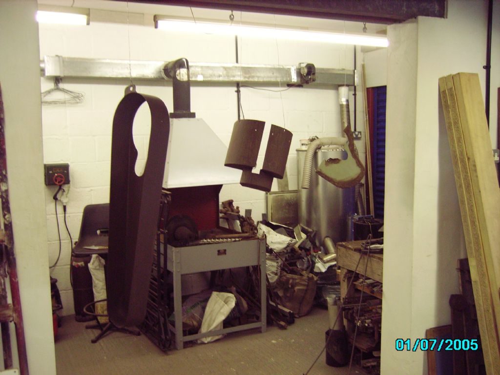

      You've answered one of my earlier questions and put 5 belts on it. It certainly looks businesslike now. Next test is to run it surely?

        yes Woody, test run………………but, I have been through my collection of starters, and found that I do not have one with overloads in the right current range, 5.6A, and they are all so old that getting new coils and overloads is virtually impossible, so I will be getting a new one, and have decided to complete the rest of the three phase wiring in the workshop, thus only having to make one trip to the electrical factors for all the bits and pieces. I did get the first coat of white on, which was a bit fraught because I realised that it is a bad idea to suspend parts for painting, then try to roller them! Obvious really DOH! anyway, I got them done, and I will assemble them, and maybe fit them to the machine before the second coat goes on. all in all, not a very productive day, but I did get a good tidy up done as well!

          Seeing those bits of belt guard hanging up rather brings home, to me at least, the size of these Covmac lathes. I have only dabbled at the edges fixing things etc for Chris Mills

              PS I agree with Phil by the way, rotating bodies, however pretty to look at, need guarding and he is making a nice looking job of it

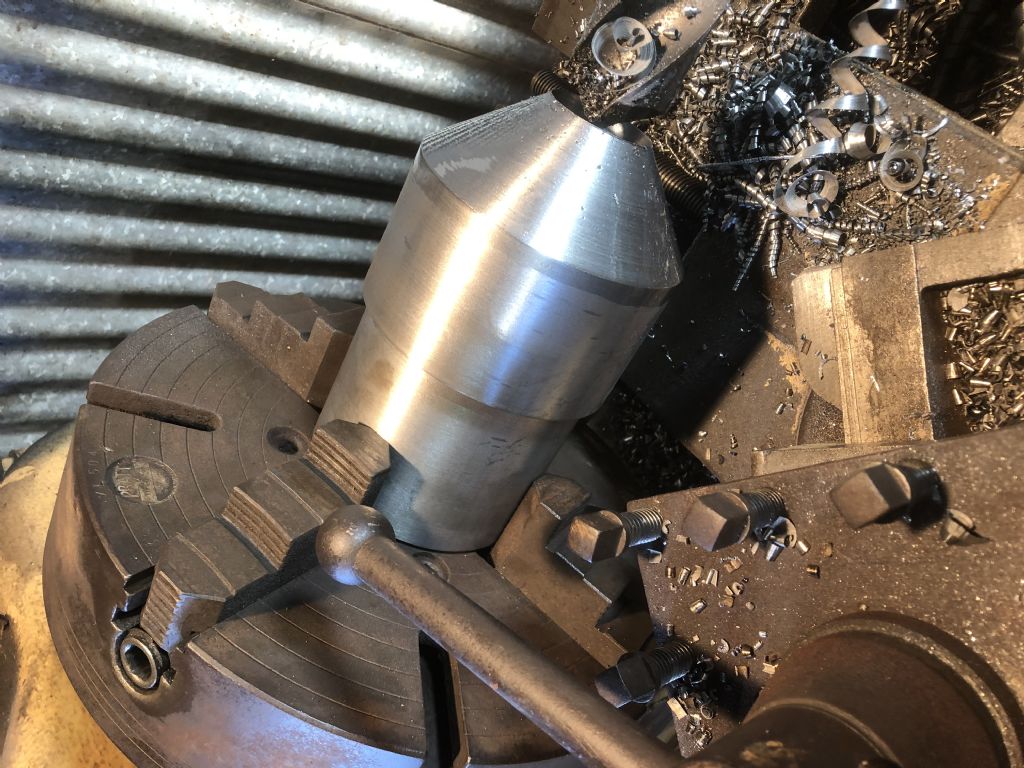

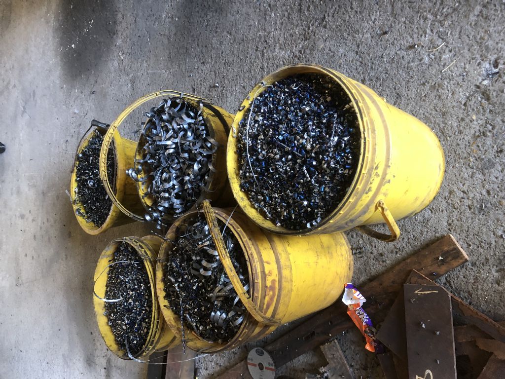

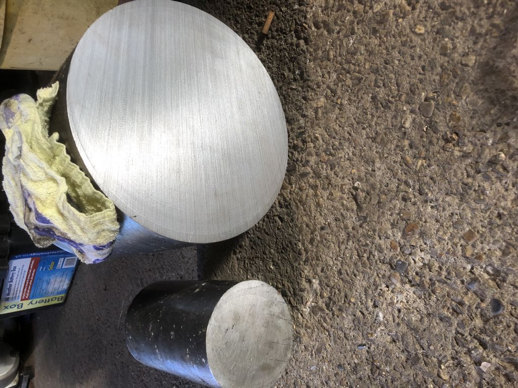

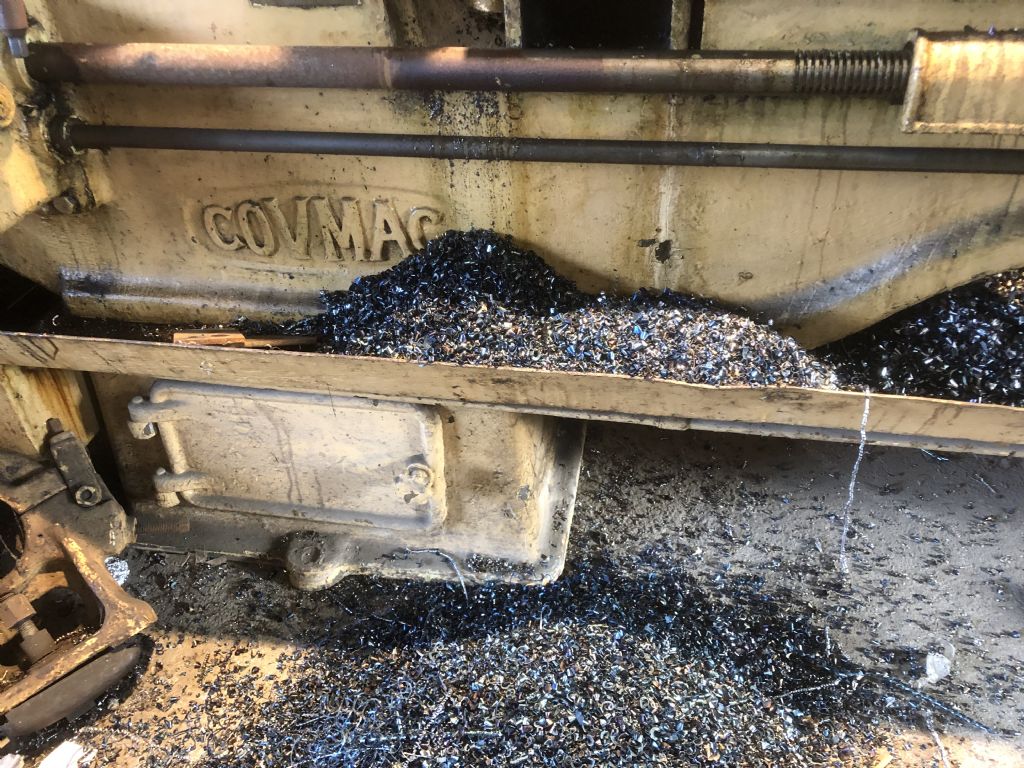

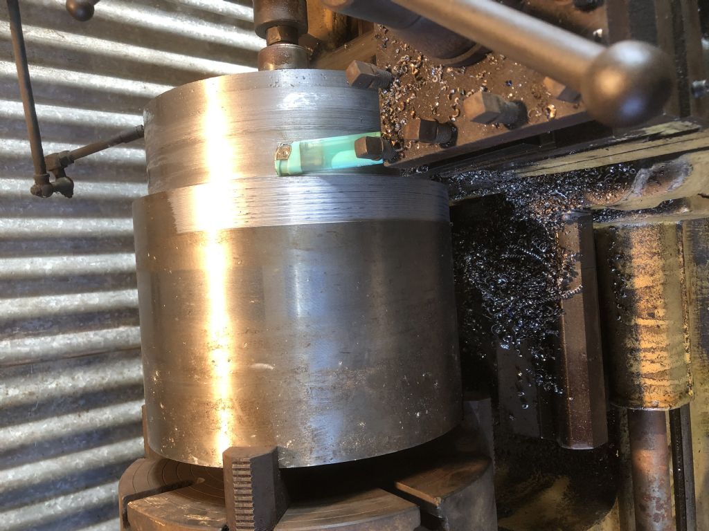

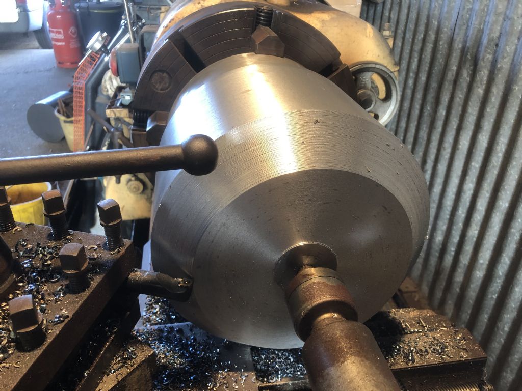

                  img_1382.jpgimg_1367.jpgimg_1364.jpgimg_1361.jpgimg_1360.jpgimg_1349.jpgHi Chaps, its been a while………..
                  However, I am uploading some pictures of my 17" Covmac working….yes actually working! The material is 300mm x 300mm bright steel. Technically this doesnt fit in the lathe over the saddle so I had to do some lathe jiggery pokery to actually machine it. You may be able to see the clearance achieved over the saddle with the finished outside diameter. The lighter on the tool post is for comparison and the last picture is self explanatory, I hope.img_1348.jpg
                  #428078
                  John Lapthorn
                    @johnlapthorn83182
                    Of course all the photos have posted last first and first last……The smaller piece of material is 150mm in diameter.
                    For those interested I do have a short video of the action but i dont think i can post on here.

                          HI John, welcome back! that is truly awesome swarf collection, I note that your Covmac is the same colour as mine, was it reconditioned by I L Berridge as well? Does it have a war finish build plate on it? I have been sidetracked by my Grafton drill rebuild, but that is almost complete, and I expect to have my Covmac running next week! (said that about two weeks ago!), also, my daughter asks, and I would also like to know what it is that you are making?

                              Yes indeed, good to hear from you again. And what a lot of swarf ! A respectable surface finish though, one big advantage of a heavy machine, it holds to the cut because of the sheer mass of the saddle/cross slide combination.
                              For Larry's benefit, these Covmac lathes were made for serious work, they weigh about 1.5 tonnes and use big tools to shift all that metal Certainly not a garden shed job!

                                I made two of these from 300mm material and they took 3 days each. The third was made from 150mm material and took about 6 hours!! The 300mm material weighed approx 166 Kg each and the swarf weighs about 120Kg.
                                They are to hold up a balcony on a house. A 50mm round bar goes in the hole and the spigot on the opposite end of the cone goes inside a 10" pipe so when complete it looks like the balcony is supported on nothing! Architects for you.
