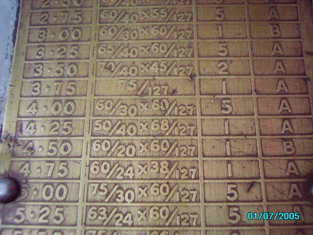

          Phil Whitley
            @philwhitley94135

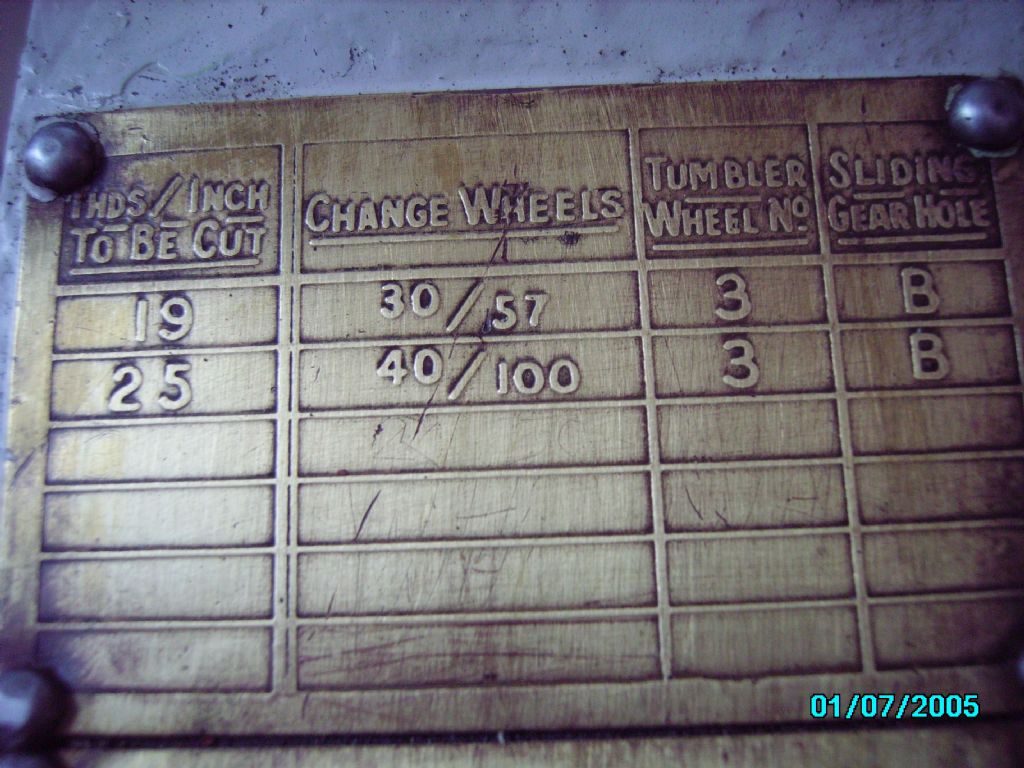

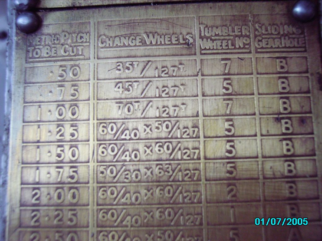

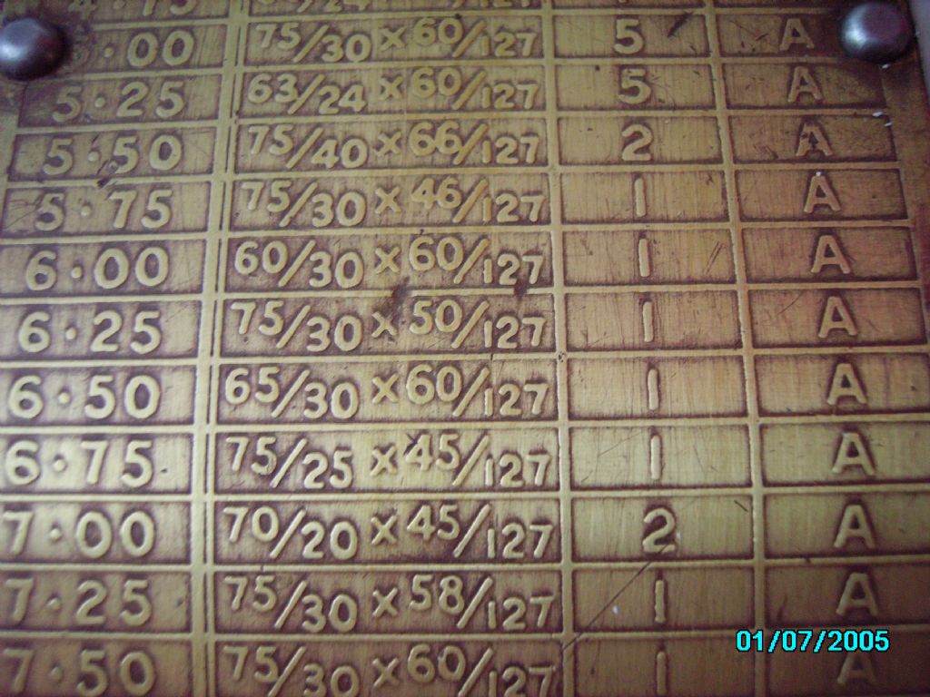

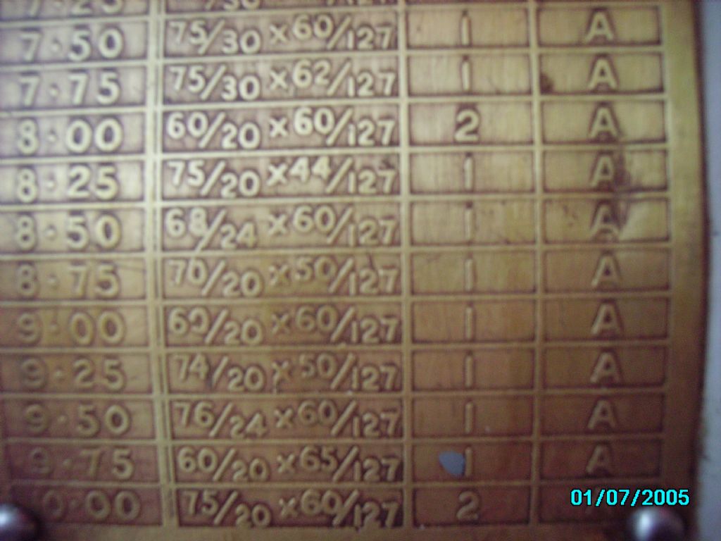

            Ok so here we go with the pics, I notice that Cris' Covmac also has the brass plate on the changewheel housing, but Georges doesn't , so for Gearge, and Woody, here it is!
            Edited By Phil Whitley on 07/07/2018 15:15:45

              Posted by Brian Wood on 04/07/2018 14:12:56:
              Hello Phil,
              10 mm pitch metric thread—-I agree with you; unbelievable!!
              What I know about CovMac lathes is what I have learned from this thread … so be please gentle with me whilst I speculate:
              Although a simple10mm pitch thread seems 'unbelievable' it becomes more credible if we consider multi-start threads … A five-start thread would be useful in [say] an actuator mechanism, and if the lathe is expected to manufacture such threads, then that might also justify the provision of the 127 tooth change wheel.
              #361137
              Brian Wood
                @brianwood45127
                Hello Michael,
                I have a feeling your logic is wrong somewhere but it is too hot here in Thirsk to grapple with the maths tonight!!
                What I do know is that Phil has shown photos of gearing set ups for single pitch threads and the combination listed would create a 10 mm pitch metric thread if the leadscrew and gearing could stand up to the loading.
                I know Covmacs were big and rugged lathes but that would be especially brutal on the way it was built if say a 10 mm pitch square form leadscrew was the item to be made
                Regards Brian

                    #361178
                    Phil Whitley
                      @philwhitley94135
                      Thinking along the lines of multi start threads of large calibre, large gun breeches were a multi start threed, and I also believe that some of the mechanisms used to push shells into large naval guns used quick action threads, and also along the lines Michael is speaking of, the mechanism to change the azimuth angle of a field gun. Gues who had his head in military engineering books during formative years!

                          The CovMac lathe is capable of traversing a 10mm pitch thread, so … if we set it to cut a 2mm pitch thread-form, and repeat for five starts we end up with a lead of 10mm but a modest thread depth.

                            I agree with that analysis but I submit it would be a very different thread if compared to a 10 mm pitch thread cut by the lathe, the helix angles would all be wrong and neither would you be able to run a 2 mm pitch die along it for the same reasons. I think that is correct!
                            It is really too hot to think clearly on these matters, despite the intake of amber coloured cooling fluid; they need testing to see what is actually going on and that could be done without wasting metal by using a Sharpie pen instead of a cutting tool..
                            The fact though remains that the screwcutting gearing on the Covmac lathe is way too ambitious in the coarser pitch screws that are greater than the pitch of the leadscrew and would be sure to cause tears at bedtime if attempted. The lathe can also be geared down to cut BA threads, but with 10 inch chucks and the problems involved in gripping work in those sizes that is also unrealistic.

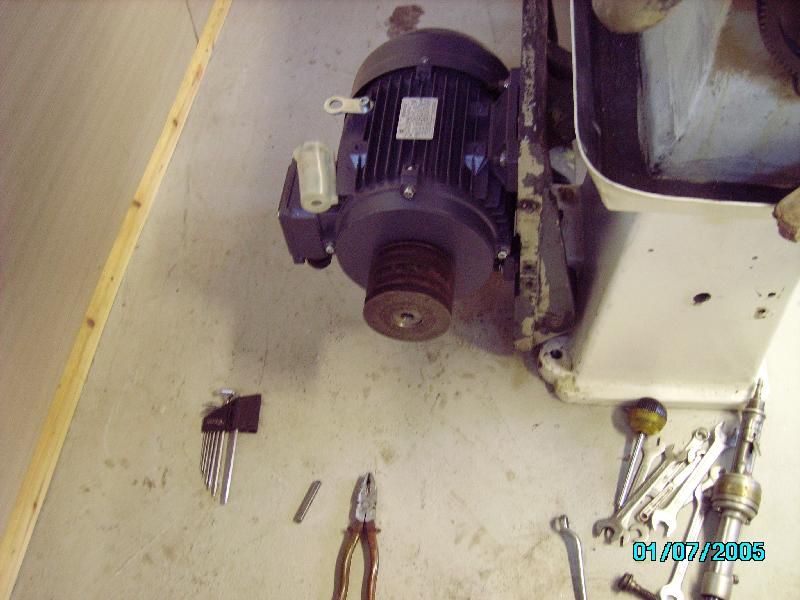

                                  @philwhitley94135

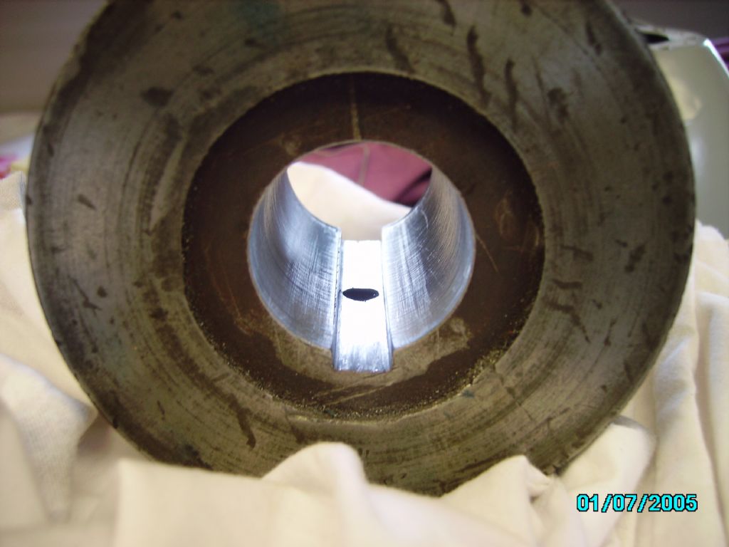

                                  Bored the five sheave pulley from 1.25" to1.5", or 38mm if yer metrically inclined! will need to drill and tap for a grub screw after I have recut the keyway, as in the previous fitment this pulley had a tanged key in it, and the new motor is an internal key. That's tomorrows job!

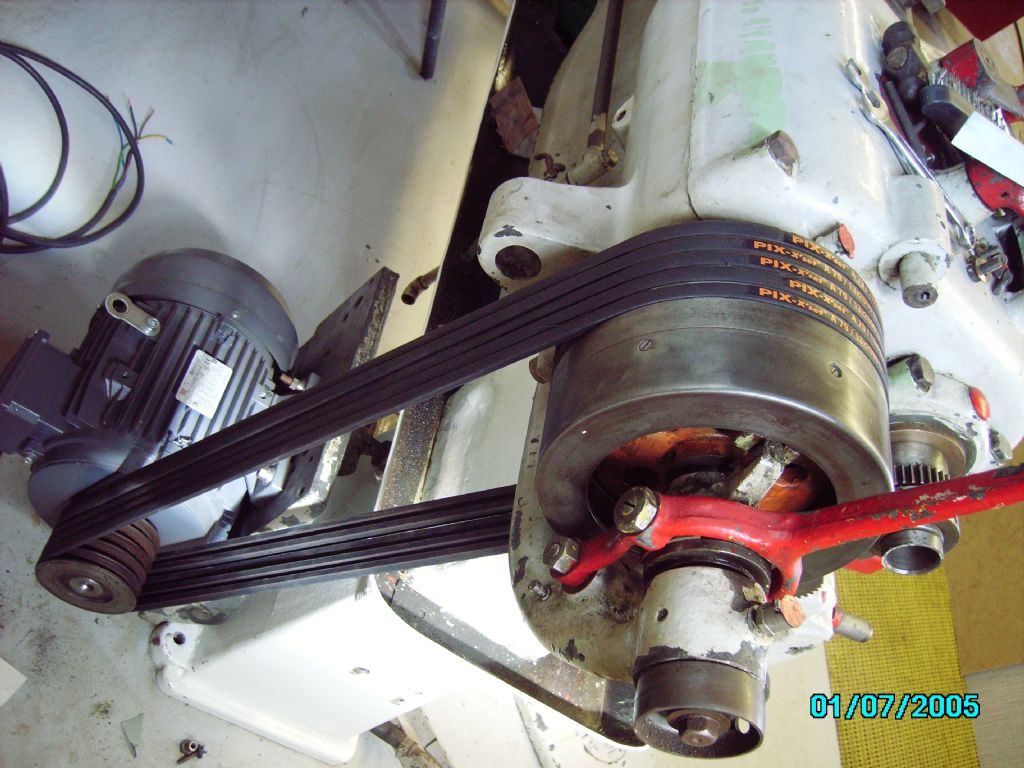

                                  #423369
                                  Phil Whitley
                                    @philwhitley94135

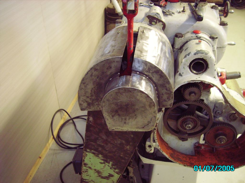

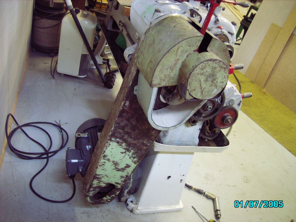

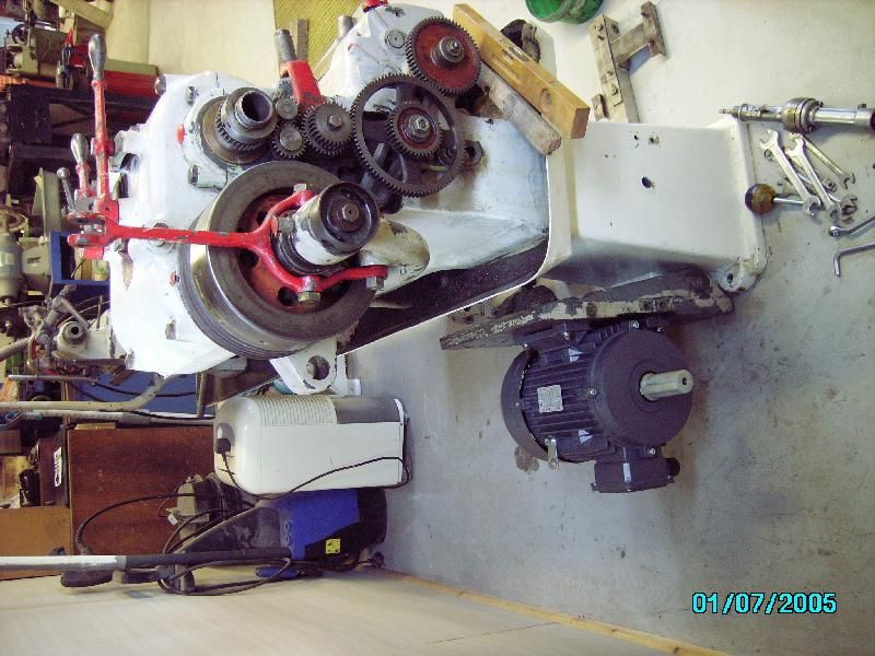

                                    Back on the Covmac, and this time it is to the finish!, got the motor cabled up, and new belts sized up, just working on modifying the belt guards, should have chips next week!
                                    belt guard
                                    #423455
                                    Brian Wood
                                      @brianwood45127
                                      Hello Phil,
                                      Good to see more progress! What power of motor have you settled on to run the old girl on, it must be fairly substantial to justify 5 belts?
                                      Regards
                                      Brian
                                      #423474
                                      Phil Whitley
                                        @philwhitley94135

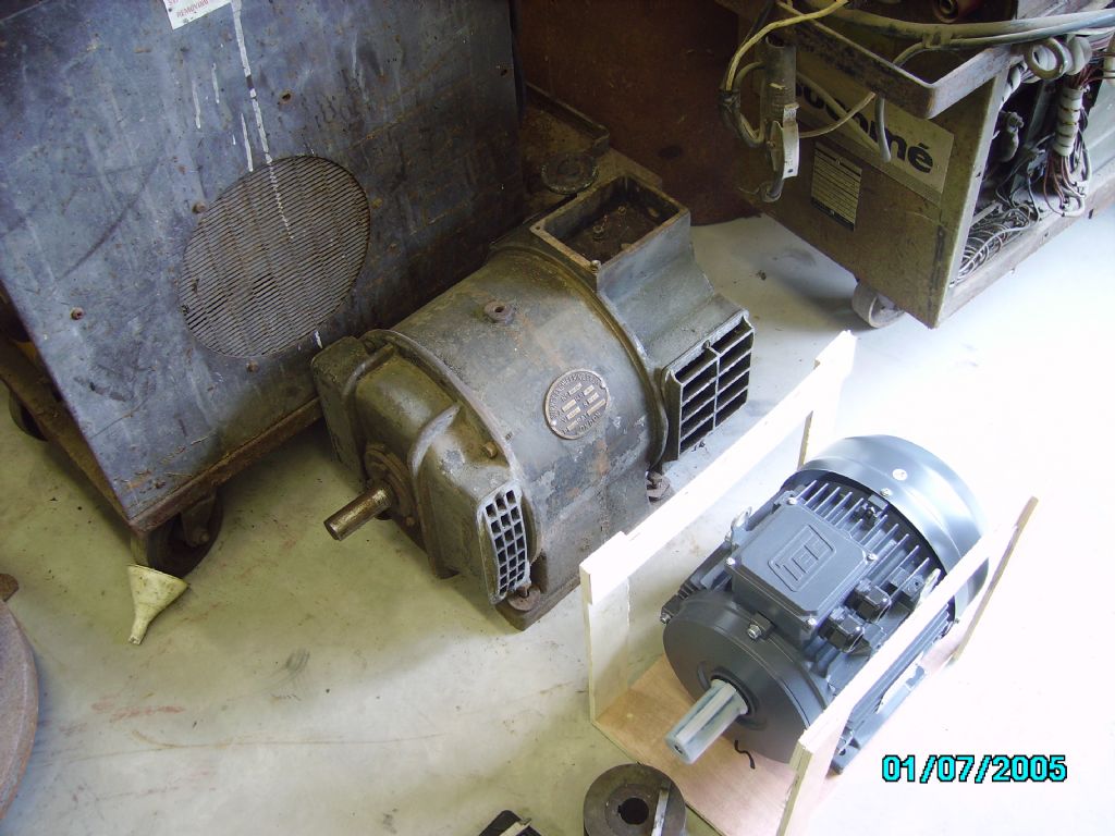

                                        Hi Brian, when I got the lathe it had an ancient repulsion induction single phase variable speed motor on it, which weighed about four times what the motor now fitted weighs, so I have swapped it for a three phase 3hp 750 rpm motor. The pulley is the original off the old motor, bored out to fit the new one, and rekeyed on the shaper. The five belt set up is original to the machine. If all goes well I should get it up and running next week!
                                        #423479

                                            Phil Whitley
                                              @philwhitley94135
                                              Here is the comparison, and the old single phase motor is only 2hp! Speed adjustment wheel (just behind terminal box) moves the brushes around the armature, the motor speed slows right down to a halt, then restarts in the opposite direction! Note that on this side, the "drip proof" vent at the rear has been fitted upsode down because of the position of the motor when mounted on the lathe. I think that the motor mounting plate on the lathe, which is solid cast iron, probably weighs more than the new motor. If you look on lathes.uk at the Covmac page, the 3hp 750 rpm is the original recomendation for the lathe, although I shall probably never manage to overload it!! the FLA of the new motor is only 5.5a.

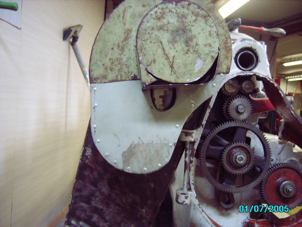

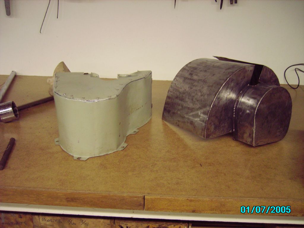

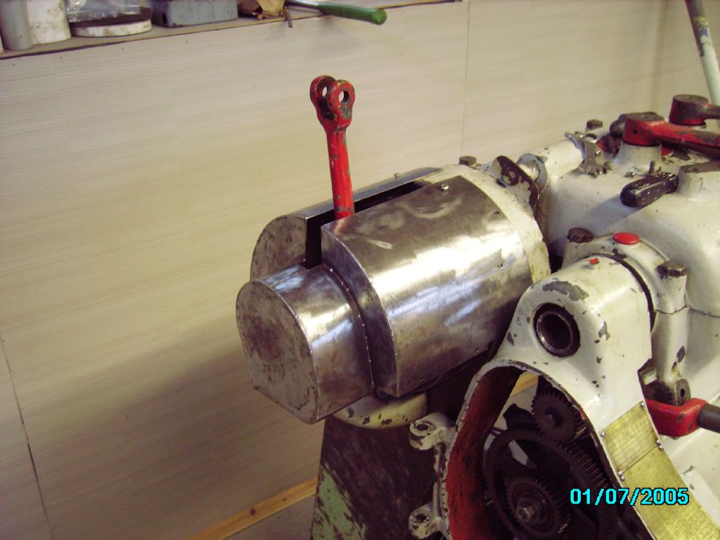

                                                #423826
                                                Phil Whitley
                                                  @philwhitley94135

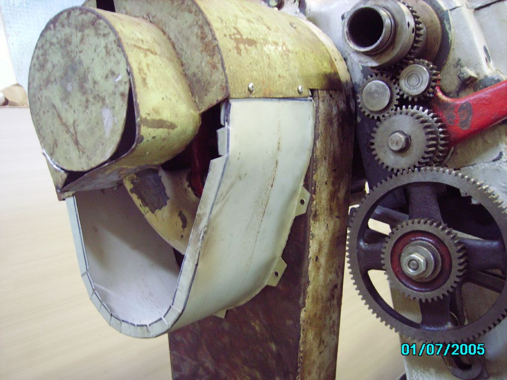

                                                  Todays progress, fitted the end gear housing and adjusted the fit of the new belt guard, made and fitted the cover plate, practised my TIG welding on the bit where the coolant pump drive used to be (flap disks are a godsend when you are still learning TIG) and cleaned up ready for paint. Tomorrow, I will pick up the V belts, fit them, and then clean off the rest of the belt guard, and get some paint on it! Horrible job, but it has to be done. Needless to say I wore a breather mask for the removal of the suspiciously arsenic green paint! it was wartime after all, and I suspect they were using any paint they could get their hands on. I had forgotten how heavy the end gear cover and door were! Solid cast iron, and they didn't skimp on thickness either! Tomorow I will sort out a starter and isolator from my collection, and do some wiring while the paint dries. Also considering a splash guard to stop the inevitable coolant up the wall trick!

                                                    #424009
                                                    Phil Whitley
                                                      @philwhitley94135
                                                      Today has been cleaning and painting, got the rest of the belt guard cleaned up and primed, and also got the belts and fitted them, tomorrow I will roller the white paint onto the guards, and get on with the wiring. forgot to take pics of the cleanup, but very boring anyway, here is one of the new belts.
                                                      Phil
