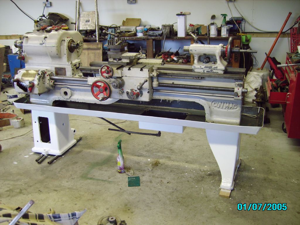

            #358725
            Phil Whitley
              @philwhitley94135

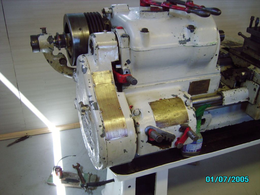

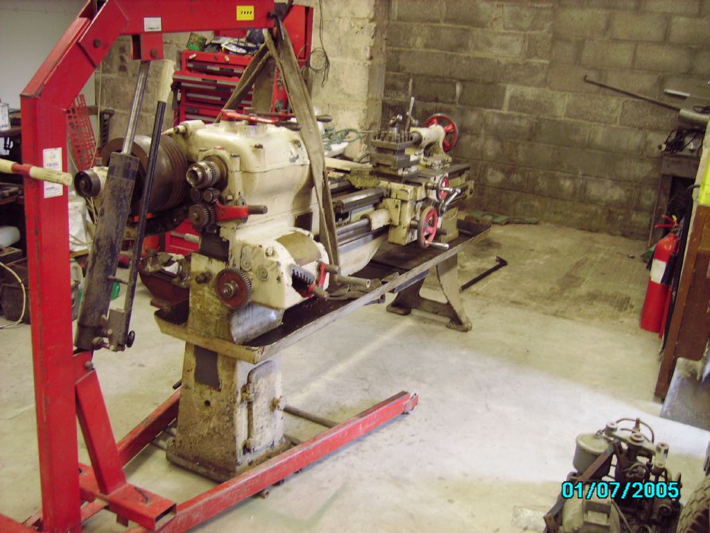

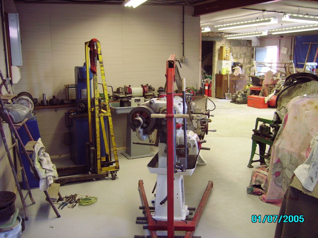

              At long last the Covmac leaves its dusty lair, and enters the main workshop, through a door that didnt even exist when it went in there! First job was a thorough clean, and tomorrow I will move it into its new home, and reassemble it. I have decided on a three phase motor, as the repulsion induction variable speed single phase one that came off it is so huge and heavy I doubt I would be able to hoist it up at an angle to refit it without turning the whole plot over and probably having an accident. BTW, it isn't two tone, the whiter brighter bits are in natural light from the door, whils the yellow bits are under fluorescent lights.
              #358731

                #358734
                Phil Whitley
                  @philwhitley94135
                  I only got it out of there yesterday, and cleaned it todayI will post a few more pics after tomorrows fun! The engine crane is only there in a supporting role, it will lift it (just) but it is mainly to prevent toppling, and to help with my nerves, it is a heavy brute.Good to hear from you again Cris!
                  Phil

                          #358888
                          Phil Whitley
                            @philwhitley94135

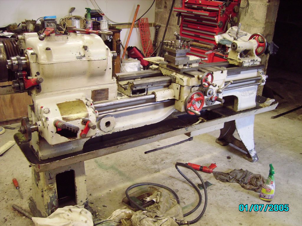

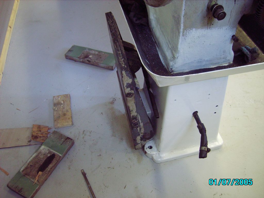

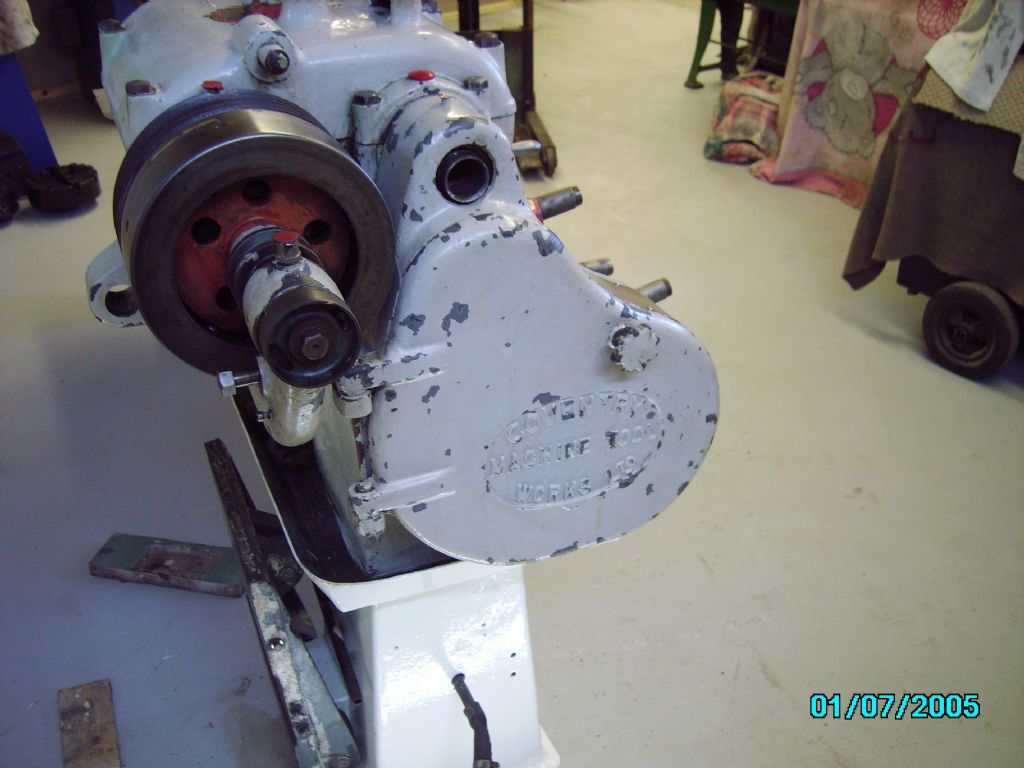

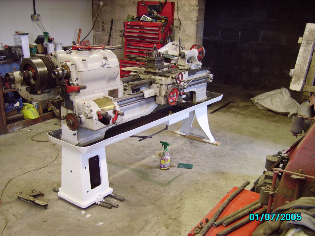

                            todays Covmac progress was mainly repainting the legs , plinth and chip tray, and seeing if I can remember how it all goes together. It is pretty obvious, apart from a bracket which has something to do with the belt guards, but I am sure its position will become apparent as I reassemble, which I am not going to do till it is in the new "machine shop", which may be tommorow, if the paint dries overninght, otherwise, Monday! The mystery bracket bracket is the one on the floor by the plinth in pic2. it is, needless to say, not original. Although the coolant pump is "a bit of a rig" I have decided to refit it, as I like the fact that it runs from the spindle drive, and so coolant stops when the chuck stops. Now heres a thing for Chris, is your chip tray cast or welded from sheet steel? they are cast on the lathes.co.uk pics, but mine looks like it may be a replacement, although it is an exact copy, and both yours and mine are later versions of the ones in those pics.
                            Yes, I know! Its white, and the lathe is a sort of faded magnolia, which was probably white once, and then got thoroughly oiled for about 60 years, if I can't live with it I will tone it down with some "White with a hint of wayoil" During the cleanup for the paint, it looks like the original colour was a dark grey, the same as the one Chris has , so it looks like it was repainted at IL Berridge, where it was reconditioned in 1955. Meanwhile, in the spirit of every TV presenter from Fanny Craddock to Blue peter, " here are some I prepared earlier" in their new less cramped habitat.

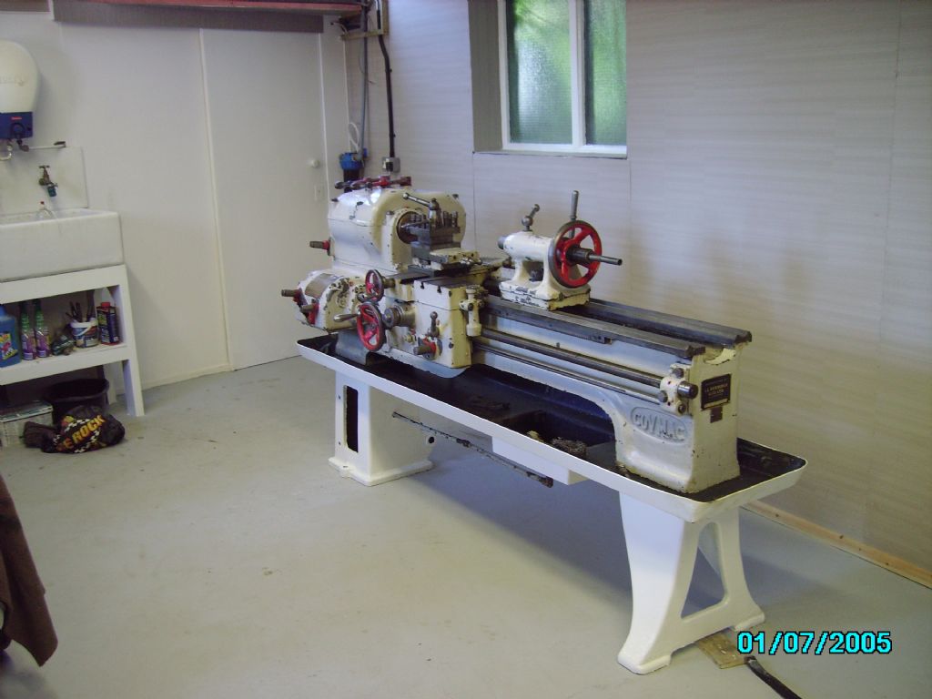

                            #359046
                            Phil Whitley
                              @philwhitley94135
                              Well, the paint was dry, so I cracked on and moved the lathe into position, and got most of it reassembled, including refitting the motor plate. Next job is to get a motor!
                              Edited By Phil Whitley on 22/06/2018 19:15:39

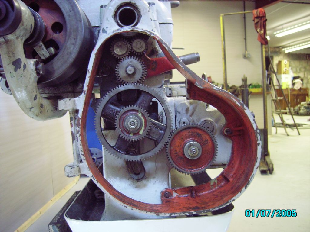

                                  What sort mechanism do you think there is within the big clutch drum?

                                    I cannot recall my chip tray, whether cast iron or steel, but I will look next week, when I go to Somerset

                                      Looking at Chris's photos I think he too has a sheet metal tray, the sections are not quite thick enough for a casting in my opinion..

                                      #359222
                                      Phil Whitley
                                        @philwhitley94135
                                        Cheers Woody, it has been a long haul on the workshop, but almost finished now, just have some rendering on the outside of the "blacksmiths shop" wall, a ceiling to plasterboeard and skim. then a bit of paint, and we are finished! The reason I have moved the covmac now is in order to get that part of the building empty so I could do the final work. Still to come out are forge (in bits, sl easy to move) Brazing hearth, a startrite bandsaw, and a Grafton drill press on stand, a workbench with three grinders on it, and all my metal stock! Thats next weeks job. I was reading about your eye problems, engineers must lead parralell lives!, I have had cataracts in both eyes removed, but only suffered one detachment in my right eye! I don't like night driving either, I dont think any glasses wearer does, as any slight lense scratching which is unnoticable during the day is a curse at night.
                                        Chris, Clutch mechanism? short answer is, I dont know, as I havent stripped it, but from the feel of the way it works, it seems to snap into either the run or the stop positionI would guess at some sort of lightly sprung over centre mechanism which uses friction pads to take up the drive. It couls be along the lines of a brake drum where the shoes are released and forced against the wall of the drum to initiate drive. I dont think it is a dog clutch, as it seems totally smooth and silent in operation, but ATEOTD, I am just guessing! Did you get any change wheels with your lathe, as I have noticed that the brass plates on the banjo gear cover gives all the different change wheel and SC gearbox set ups for metric threads. Whwn I have a minute, I am going to make a list up and see if, for completeness if nothing else, I can match some up!
                                        Phil
                                        Edited By Phil Whitley on 23/06/2018 20:02:40
                                        Edited By Phil Whitley on 23/06/2018 20:03:06

                                          Phil Whitley
                                            @philwhitley94135
                                            It is Neil, and very top heavy, which is why I put the crane on it. The crane is rated 750Kg, and will just lift the heavy end, but I used it as a safety to keep the lathe upright, and to ease the weight on the rollers. A big sigh of relief after it got there upright and in one piece though! I moved it by myself, as whenever I have had "help" in the past, I have spent more time stopping them getting a rupture or turning the thing over than I have actually moving the machine. Slow and steady wins the race. It took just over an hour to move it about 9 metres! You can move just about anything with a couple of good long prybars, and some 1" rollers, oh, and a smooth CLEAN floor helps too!!

                                              A car jack and some bits of 4×2 can be a big help too, and don't rush things.

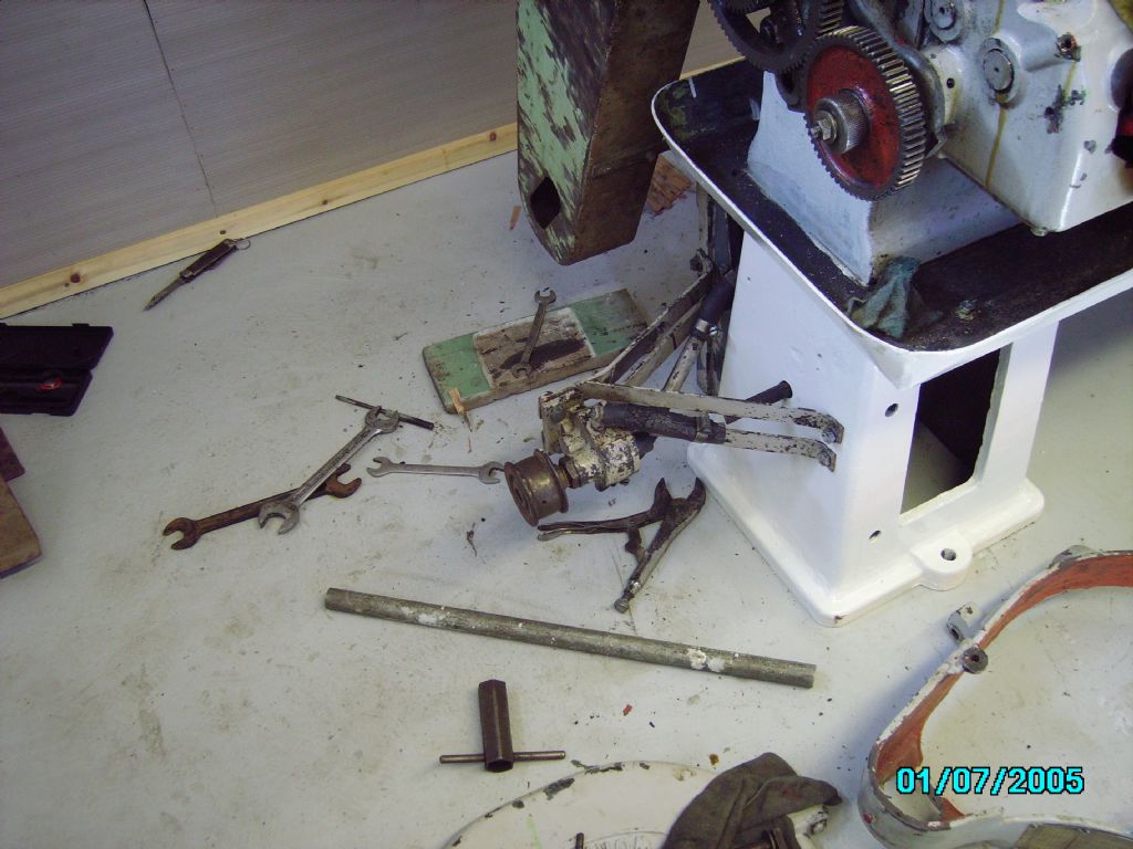

                                                  Well, I have fitted the coolant pump, and decided I can't live with it, it really is a horrible bodge! In order to line up the pulleys the pump is spaced off from the plinth on two long "brackets" of bent flat bar, two of which are bolted into the plinth, and two are bolted to the motor mounting plate, which moves when the belts for the main drive are adjusted. Because of the cockamamey geometry of this rig, when the motor plate moves, the pump is twisted out of alignment with its driving pulley, on the left side of the input shaft in pic 2. I noted when I bought the lathe that there was no belt on the coolant pump, or coolant in the lathe, and it seems very reasonable to suspect that this rig up never worked reliably, if at all! Scrapping this set up also means I will no longer need the outboard belt guard, which increases the width of the lathe by about 18". I shall fit a small electric pump under the lathe, near the sump. I also did some bull work on the plates! the long plate on the changewheel cover gives all the gears required for cutting metric threads up to an unbelievable 10MM PITCH. If anyone has any gears 7/8" bore, 1/4" key 12dp (thanks woody!)I may be in the market, especially the elusive 127 tooth metric conversion wheel .
                                                  Note to Chris, re the clutch, I noticed the other day when I fitted the drive control bar, that when you put the lathe into run, a wedge lug on the operating mechanism forces two matching wedges apart, and mine appears a bit sticky, so I may be going in to clean up and lube. I will keep you posted.

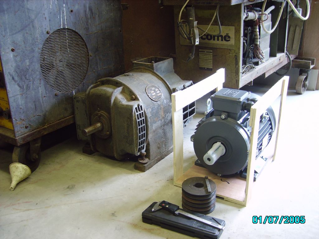

                                                    The new motor for the Covmac arrived, and I picked it up today, here it is next to the original motor. It weighs in at 32kg, and I lifted it out of the car boot with little trouble. A few days ago I went to move the old one, managed to slew the shaft end round a few inches, but couldnt move the other end at all! Good thing the new one is lighter, as the next job is to line it up for fixing hole drilling on the motor plate, which is vertical at the back of the lathe, but first, I need to bore the old pulley from 1-1/4" out to 38mm. It already has a steel bush in the centre, so easy job (famous last words!) The old motor is a 2hp, the new one is 3hp!
