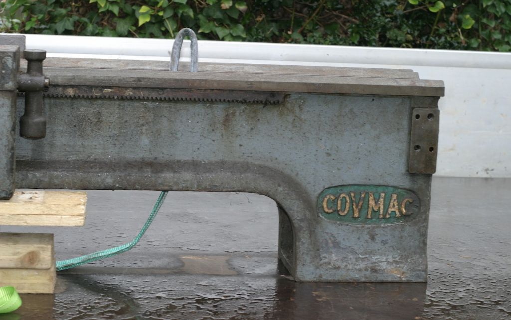

            CovMac is Landed – Final move of the CovMac took place successfully yesterday, and she is now in my garage in Yeovil.
            Martin Whittle oversaw the move, (and did most of the work) and he was a really wonderful help to have.

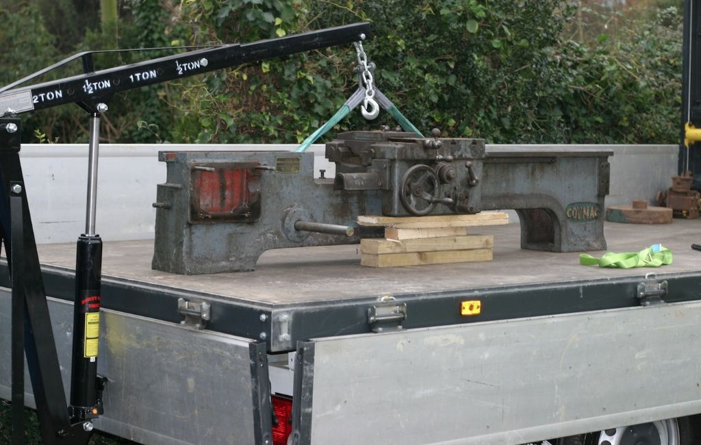

            Here is the lorry she went on – A VW Iveco flat-bed, nearly new, and with the very worst combination of gearbox and clutch I have ever had the misfortune to drive. Truly horrible. Highly recommended hire firm – Pitters of S'oton – this truck is had for £60 a day – an absolute bargain if you will tolerate the appalling gearbox.
            CovMac Moves
            And here is the CovMac, finally, and safely, on the lorry. That it took me 11 weeks to achieve this is down to my being a complete beginner. That I am not still in the shed at Totton, struggling, is entirely due to members of this forum. Many thanks, gentlemen. More detailing, and more pictures are to come, including the bed in the air, hopefully these will be posted by tomorrow. I have a busy day today.
            On the Lorry
            Edited By CHRISTOPHER MILLS 1 on 05/12/2014 07:43:07

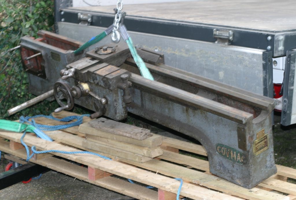

                    CovMac – Final Move

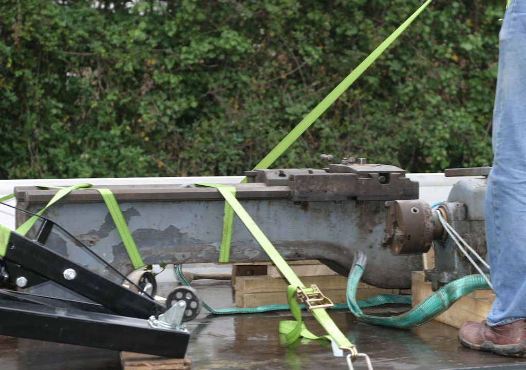

                    Here is the lathe's bed in full, we placed it running lengthways to the truck bed, and decided to dispense with the carriage pallet, and to rely upon ratchet ties to securely clamp bed ends down to the lorry's floor bed.
                    Lathe Bed
                    This worked very well. The crane is on its 1/2 ton setting, for we really needed the extra reach, but there is a huge safety margin in lifting equipment. It is hard to estimate precise weight in the bed, carriage and apron, but I guess is at about 1400 lbs. We chocked the apron with random lengths of wood. Instead of moving crane, which, with its steel wheels, is very hard to do on anything less than a billiard table surface, we reversed the lorry bed to slide underneath it, once the lathe bed was at the right height. By this time, we had huge confidence in both crane and lifting slings – for this lift we used just the one, 2 ton rated sling, and slotted a similarly-rated shackle through the lifting chain, for to gain a bit of height, rather than the lower hook. The carriage and apron were rolled into the best balancing position.
                    Edited By CHRISTOPHER MILLS 1 on 06/12/2014 07:47:52

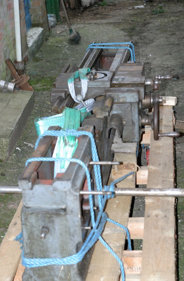

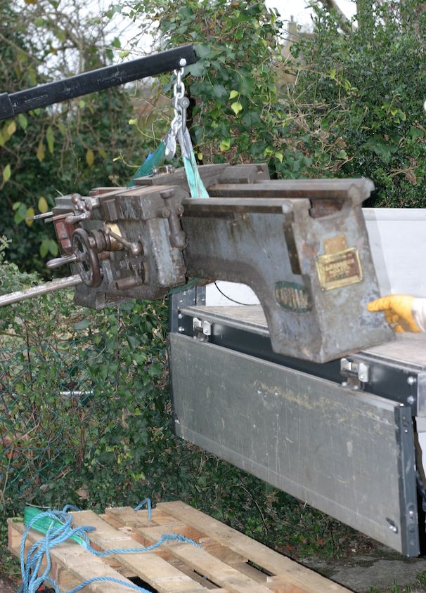

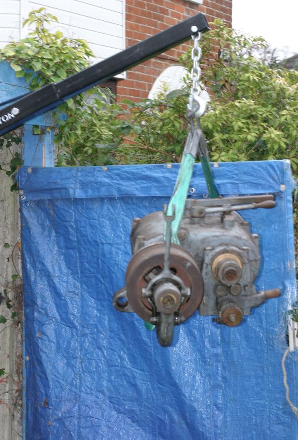

                        CovMac – Final Lift & Move – We approached the lorry with  lathe bed sideways on, though it was too long to go across the body of the truck, it was easiest entry point, bearing in mind location and terrain. The lorry bed was about 40 inches off the ground, so we figured the lathe had to go only a little higher –
                        Beginning
                        At its highest point: Then we reversed the lorry as far as it would go beneath the crane's jib.
                        Lift
                        Then, it was only a matter of twisting the lathe bed, to run lengthways onto the lorry bed. This was easy, the crane was very versatile in this respect. Then we dropped her down. Then it was a matter of tying her down securely with webbing ratchet ties – these were fantastic – bought at Tool Station for less than £6 each, four metre, 1.5 ton rated, they lost nil tension in the 70 mile journey – they were tight as a drum still. Expert tying from Martin Whittle.
                        Although I had convinced myself that the lathe bed, minus its legs, headstock, drip tray, tailstock and most else barring carriage and apron, was not as heavy as it once was, altogether, when it might have been 1.4 tons, this was still one mighty lump of metal to move – likely 1400 lbs – and it took great care, and a very clam, careful and thoughtful approach, all of which Martin provided. I felt very safe under his guidance.
                        Altogether, with about 7 visits to Totton, from London, purchase of engine crane, ties, slings, hire of flat-bed truck, the cost of moving this lathe was about £450. It was double what I had imagined, in the beginning, but the concrete nonsense meant a doubling in number of trips to Totton – the concrete alone probably cost me £120 in petrol. The hardest part of the whole move was defeating the concrete boot which cam e sadly attached to the tailstock legs. Always check, when buying an old lathe – is it concreted in? I had not noticed, until my second view, when I had already committed to it.
                        Tie-downs

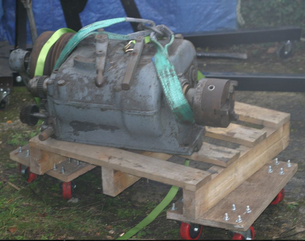

                        Then the headstock came, too. This actually proved, on the trolley wheels, harder to move than was the main bed, for the lack of weight, and an oddly shaped base to the headstock, meant little adhesion to the wheel platforms, but we coaxed it slowly along.
                        Lifting the headstock was a doddle.
                        Edited By CHRISTOPHER MILLS 1 on 07/12/2014 11:41:36

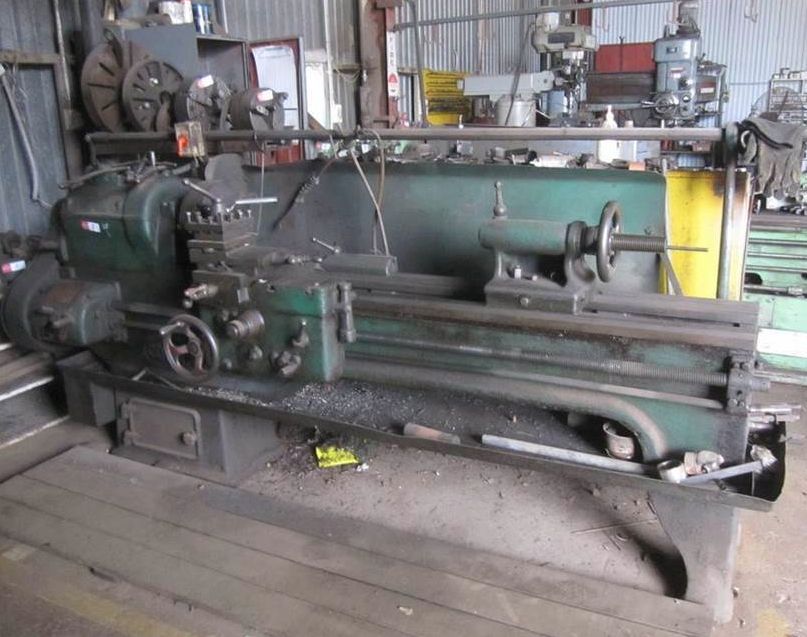

                                          Here is a 17" CovMac, very similar to the one advertised on British eBay presently – this one, which came with loads of chucks and face-plates, which can be seen in the picture above the lathe, sold in Australia in 2013 for 500 Aus dollars – in other words, very little money.
                                          It is broadly similar to 13" geared head models, but much, much bigger – reputedly twice the weight of a basic 13" CovMac model.
                                          It is about 2 tons of lathe.
                                          The bed is a much chunkier monkey. Other than that, they did not radically differ from mine and Phil Whitley's.
                                          Headstock, screw-cutting box, carriage, apron and tailstock are all very much the same – it also had the clutch, with wooden clutch pole, just like the smaller models.
                                          17 Inch CovMac
