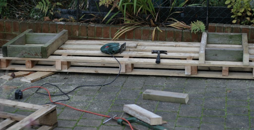

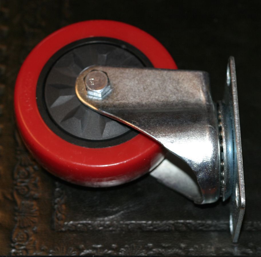

                    Here is the custom-built pallet for the CovMac bed – it is upside down here – the two 2×3 inch wooden frames either side are needed below to allow the crane to go in underneath to drop the bed on. Under these two frames will be two stout plywood boards, with four castor wheels each. The castor wheels, about 4 inches in diameter, are rubber faced, and hopefully they will run better than the crane's steel wheels. The pallet is about 85 inches by 28.
                    The pallet has no lifting duties, it is just for the bed to sit on. The wheels are rated at 600 KG per four – so we are running them only to about 50% weight capacity. I really do not want one collapsing on me.
                    The pallet is courtesy of British Gypsum, a cut down 8 x 4 plasterboard pallet. I have reinforced it everywhere I think it is needed. I spoilt my neighbours' Sunday by building it.

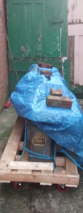

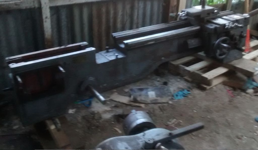

                      CovMac Final Move Due Tomorrow – Yesterday, we got the lathe bed onto the pallet, and, after it was well lashed down, (even the bed alone is very top heavy – and it still has carriage and apron on) the assembly works well – it moves a little like pushing a large motorcycle. We did not even need plywood boards, once free from the shed; rubber faced wheels coped very well with roughish concrete.
                      It is now out of the shed, covered by a tarpaulin, waiting to be lifted tomorrow. Incidentally, we raised the main bed on only the 1/2 ton crane setting, for extra jib extension, and it was just fine – there must be a built in margin of safety to it, for I am sure the bed weighs well over that.
                      Martin Whittle was again a superb help, and with his friend Bob Minchin, I was in very good company of engineers yesterday. Aspects of my pallet design needed improvement. Stability is all important with this kind of weight.
                      We got the compound slide assembly off, too; that needed occult knowledge, and its tool-post was right in the way.
                      Told by Brian Wood to take a very good look around the shed for small lathe parts which might have been missed, I found the 24 inch face-plate!
                      In original dark grey CovMac paint, it is an absolute monster. It takes two men just to lift it, and getting it onto the lathe must have been a real challenge – if it was, indeed, ever used.
                      I had missed it on earlier visits, because it was lying horizontal, about 18 inches off the ground under a bench, and looked every inch like a coffee table top. It was only yesterday I spotted the key-ways, and hauled it out.
                      Will get some "big-lift" pictures tomorrow. We did nothing spectacular yesterday, but tomorrow it has to go reasonably high to get it onto the flat-bed truck.

                        Here is the bed before being lifted – just bare bones left, bed and headstock, after all removals. The compound slide came off just after this picture was taken. It was beyond my comprehension how that came off. The visuals do not fully convey just how heavy it all is, and how much extreme care must be taken in shifting very heavy pieces of metal.
                        Remains
                        Now the 13" Geared head CovMac is under a tarpaulin and awaiting a final lift, tomorrow morning.
                        I am off buying strong tie-down ratchet straps, for give this CovMac bed an inch, and she will roll over sideways.
                        Tarpd
                        The upper little brass plaque on the tailstock end bed is the War Office's ownership label and the lathe's serial number.

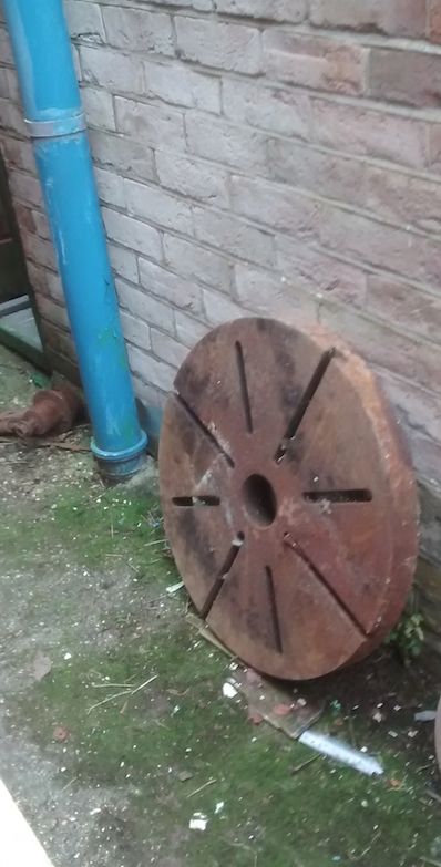

                          24 Inch CovMac Face Plate – Here is a front face view of the 24 inch face plate, of which I have earlier posted the reverse side.
                          It does not look as big as it really is, here, but, I promise you all, this thing is truly mighty. It has a bolt jammed in one of the slots, suggesting that it was actually used for a job, once.
                          When the restoration of the lathe is complete, I would like to mount this plate, once, for a photograph – but I cannot see me ever actually using it. I am really looking forward to cleaning it up. It has some surface rust, but nothing too bad.

                            Got a mate who has a medium size Pratt & Whitney lathe of 1930s vintage, with 14" chucks, he has a crane mounted on the wall of his shed for moving chucks, before the crane was built, I changed chucks once, never again. It would be worth your while setting up something along these lines with your lathe.
                            Ian S C

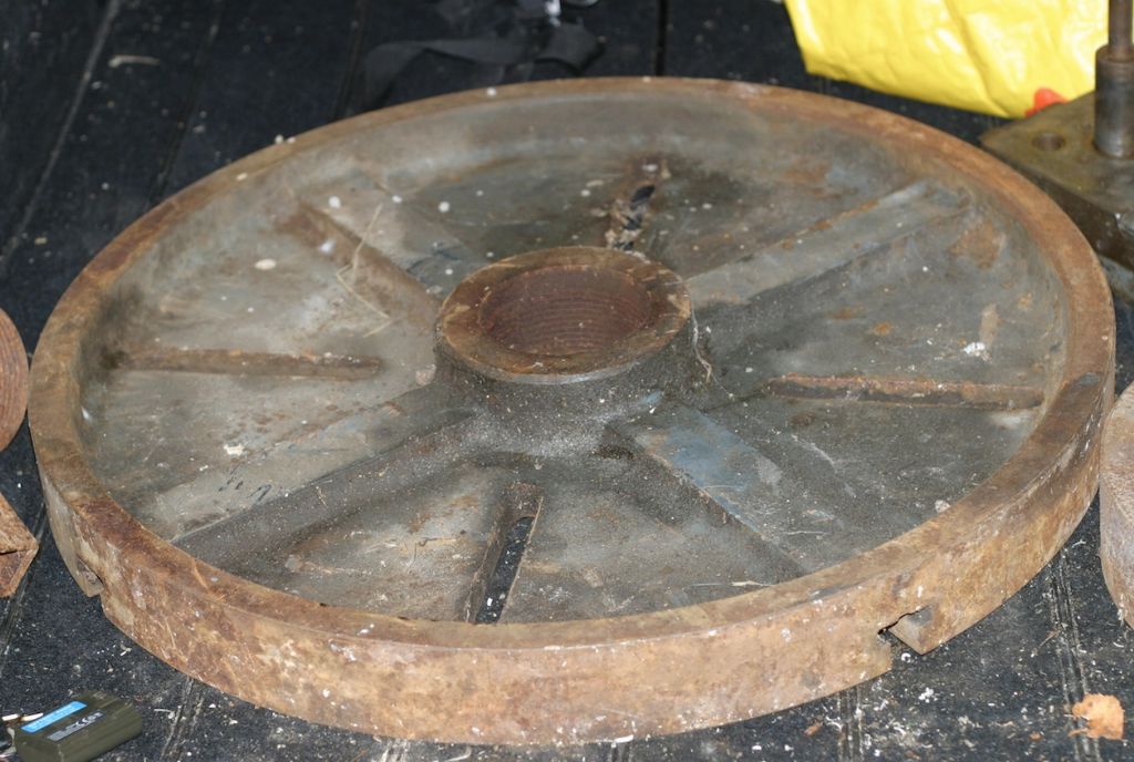

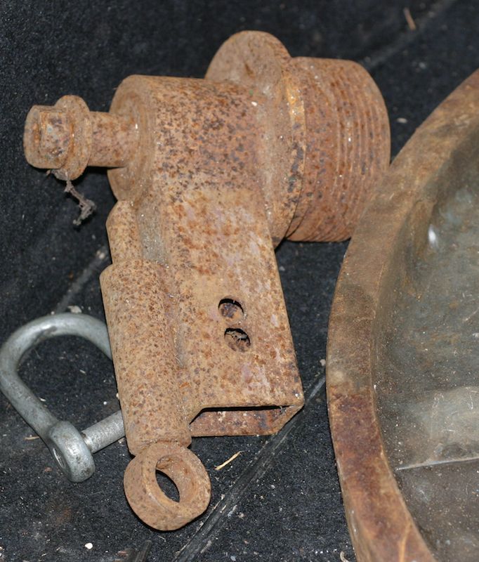

                              With the big plate, came what seems to be a crude form of dividing head. This is probably beyond restoration, for it has been used, for many years, as a door stop in the yard, and is very heavily rusted up. It appears, as Bob Minchin pointed out to me, to take a gear wheel, and uses the teeth on the gear wheel to do the dividing. It is screwed to fit into the centre of the big face plate wheel. Beyond that, I do not know too much – it looks a bit home made.
                              dividing head

                                Now that is a candidate for soaking in apple cider vinegar, who knows what will emerge. As Bob Minchin says, it looks for all the world like a simple gear tooth operated indexing tool to mount a chuck on, clearly 'home made' .
                                Ian's suggestion of a wall mounted crane is a good one, it could be made to be quite elaborate with a carriage rather than a simple pivot.

                                  It used to be common for a big lathe ,or a mill, to have it's own little crane. Used for lifting jobs as well as chucks etc. If the machine did not have one the operator might make his own, this would save time waiting for the shop crane, worth it on piece-work.

                                    If the 'dividing head' screws onto the faceplate i suggest it might have been just a device to lifting it and/or holding it on a frame when setting work out on it.
                                    On looking again I see what I had taken as a lifting eye does look like a detent. for gear dividing.

                                      Thanks Gents – So could it have been that the big face plate might also have been used flat as a working, holding and measuring surface?
