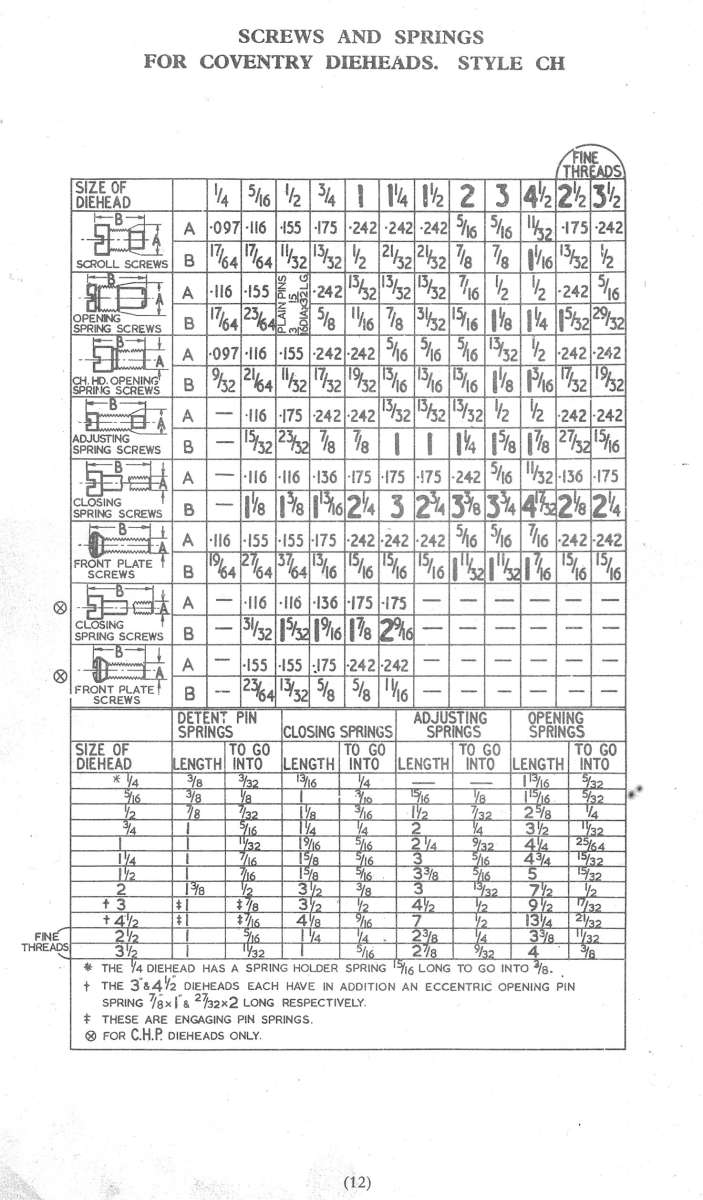

      The four screws holding the faceplate to the body, which holds the die chasers in place, are held down by four unusual screws.. They are 14.3mm overall length and 6.05mm head  diameter, raised countersunk with a steep countersink angle. The thread has an outside diameter of 3.80mm and a thread rate of 42TPI. Length of thread is 10.7mm.
      What is that thread please??
      Yes, it’s close to M4 but it definitely isn’t. There are some UNC’s in the ballpark but they are 44TPI not 44TPI. I’ve hunted through the Machinery Handbook and several others but no luck. Any ideas please?

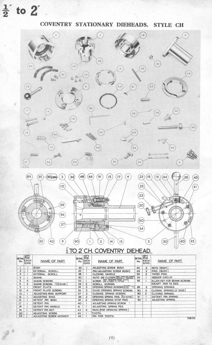

          Hi Peter, maybe these two scans will help.
          COV-dieheag
          COV12A
          Regards Nick.

              Thank you guys, what amazing help from you all, and to those in the previous thread which I failed to find first time.
              The scans are invaluable. I don’t think I mentioned the head is a CH. The CHS seems to have had BA threads throughout. I was very familiar with BA which I worked with quite a bit in the 60’s/70’s and I am fairly sure these screws are not BA – they just feel too sharp. I could go with 55 degree thread though. It seems most folk have measured 40 TPI, rather than the 42 TPI I got. I’ve checked this with two different gauges now, and 42 does seem to just sit in there nicely.
              Now, if I could just find a set of 42TPI die chasers I’d be away… :). Guess I’ll have to turn something up
              Again, many thanks.
              Peter

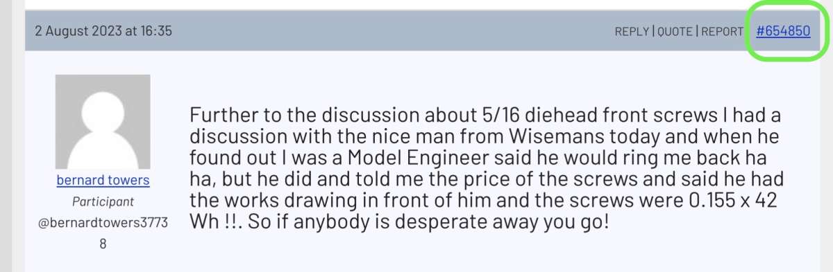

                    @bernardtowers37738
                    Yes it does Howard, I posted it on the old forum but cannot find it. I think I have the info with a couple of spare screws stored with the die heads, will check today.
                    #733475
                    bernard towers
                      @bernardtowers37738
                      The ones I have are 0.155″ x 42Wh!!!

                                On Howard Lewis Said:
                                Have searched a lot of posts, but failed to find Bernard’s giving the exact vdetails of the thread and the screws. […]
                                I think this must be Bernard’s earler post, Howard
                                https://www.model-engineer.co.uk/forums/topic/coventry-diehead/

                                    #733786
                                    Howard Lewis
                                      @howardlewis46836
                                      Thank You Michael
                                      Was obviously calling for a wrong search.
                                      So 0.155 x 42 tpi it is.
                                      Any chance that Wisemans will have any at a reasonable proce, or will it be DIY job, I wonder?
