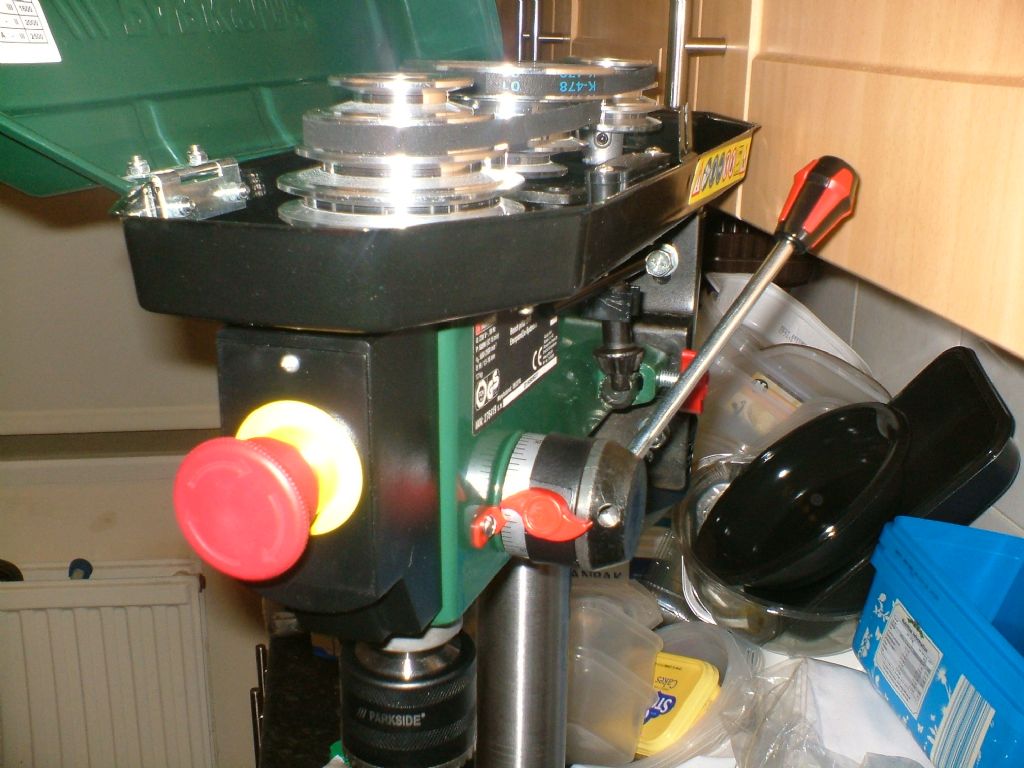

            Ady1
              @ady1
              TOT replaced the motor, made a completely new quill and aluminium pulley, modified the other plastic pulley etc
              The ones in at the moment aren't like that.
              The motor seems fine, it runs quietly and has three aluminium pulleys and a Grizzly leaflet in the box
              I would agree the table is pathetic, it needs support but a block of wood could do that
              I broke the deal up into bits, if you say 30 quid for the 500W motor and 3 x 10 quid for the aluminium pulleys (look them up on ebay "3 step aluminium v pulley" ) and the rest of it is a freebie
              If I had the time I would test the motor out properly but that will have to wait
              Edited By Ady1 on 20/02/2017 10:50:07

                Ady1
                  @ady1
                  I just had a closer look at those pulleys and you get 2 x 4 steps and a 3 step.
                  The motor has s2-15min class B on it, so not continuous I presume
                  Edited By Ady1 on 20/02/2017 11:44:18

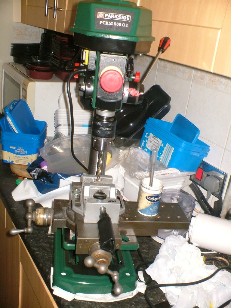

                                Well I finally got a decent look at it and the only weakness left now is backlash in the quill (about 3-4mm) from the actuating lever
                                That's the most awkward bit to access as well, there's a spring loaded bit on the side if I want in there, another night for that one methinks
                                The adjustment for the quill itself is inside the emergency stop button box which was easy to access and tweak
                                I found a pultra 1590 cross slide in the poundbox at Lidl and fitted that to the drill table to make things easier, then tested it with an 8 mm drill in 1/2 inch of steel, it was fine and drilled through very competently
                                There's an adjustable depthing ring on the actuating handle spindle, so you can't drill through your vice by accident (in theory)
                                Full depth is 50-55mm, the quill is slightly shaky from left to right and very solid fore and aft
                                If the actuating handle backlash wasn't there it would have been almost perfect straight out of the box for banging holes in stuff, only a bit of lubrication was required
                                Will still use the lathe for serious hole creation jobs but all in all I'm a happy bunny
                                edit: The noise it makes is fine, it just whirrs away like a cheap drill
                                Edited By Ady1 on 21/02/2017 03:02:58
                                Edited By Ady1 on 21/02/2017 03:07:50

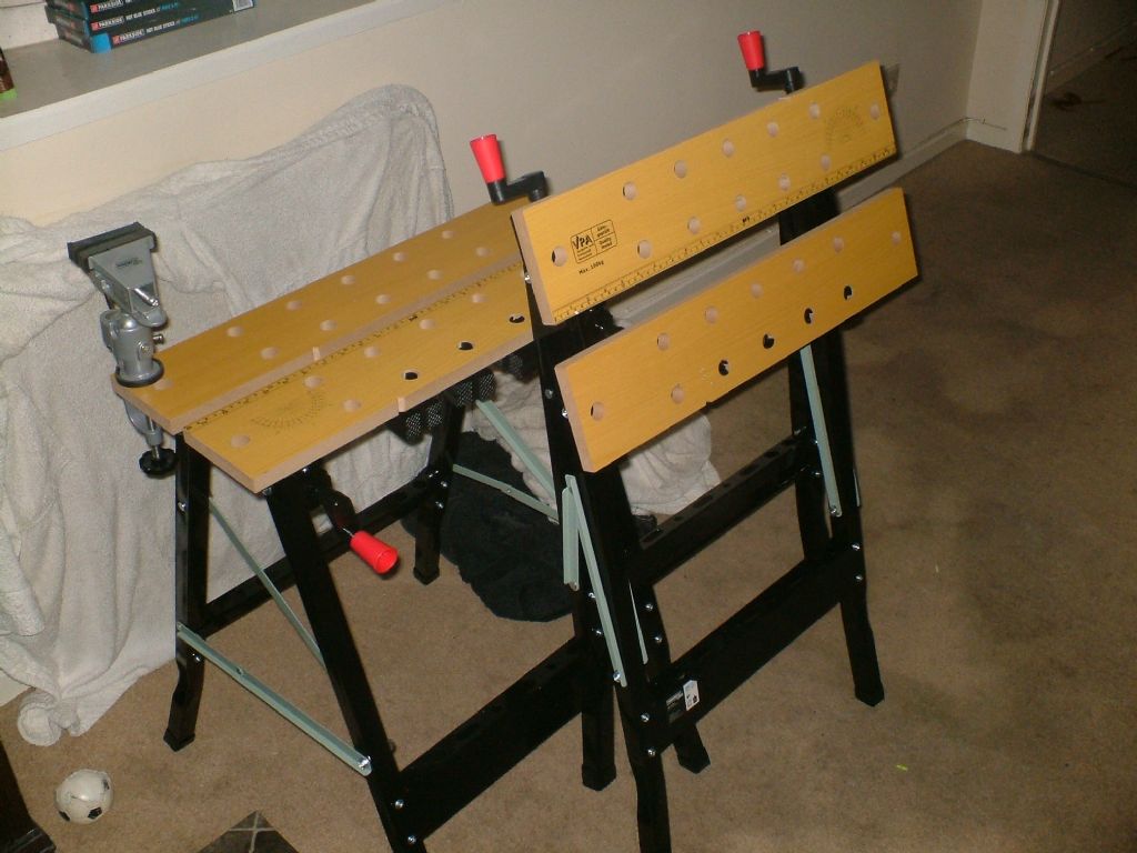

                                  Got a couple of workbenches for 26 bananas
                                  100kg swl so you can sit on it and have a cup of tea

                                                  Found the reason behind the dodgy quill.
                                                  The drill bit being used to make the hole had jammed and broken so they left it in place and put it together like that…
                                                  tapped it out and put a proper pin in (sigh)
