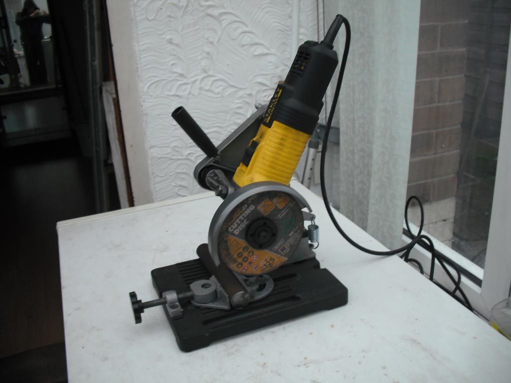

                      Posted by Anthony Knights on 18/05/2021 08:47:10:
                      I have found a trigger lock is useful in this situation.
                      I do agree regarding the convenience, Anthony
                      … But that doesn’t stop me being “surprised they are allowed to sell them”
                        I do use this situation – but I route the supply through a foot-switch, so I need a latching switch for this, but not at other times.
                        Does nobody make one with a switch with optional latching/non-latching like electric drills used to?
                        Edited By Anthony Kendall on 18/05/2021 09:17:28
