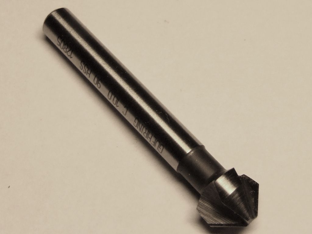

                        Vic the idea is to actually spot them deeply to form the CSK as the first op and then drill the hole but can also be used afterwards.
                        Another good make of the 3 flute ones that Andrew showed is Ruko, this is one of their 6mm head ones on a 5mm shank into 6082

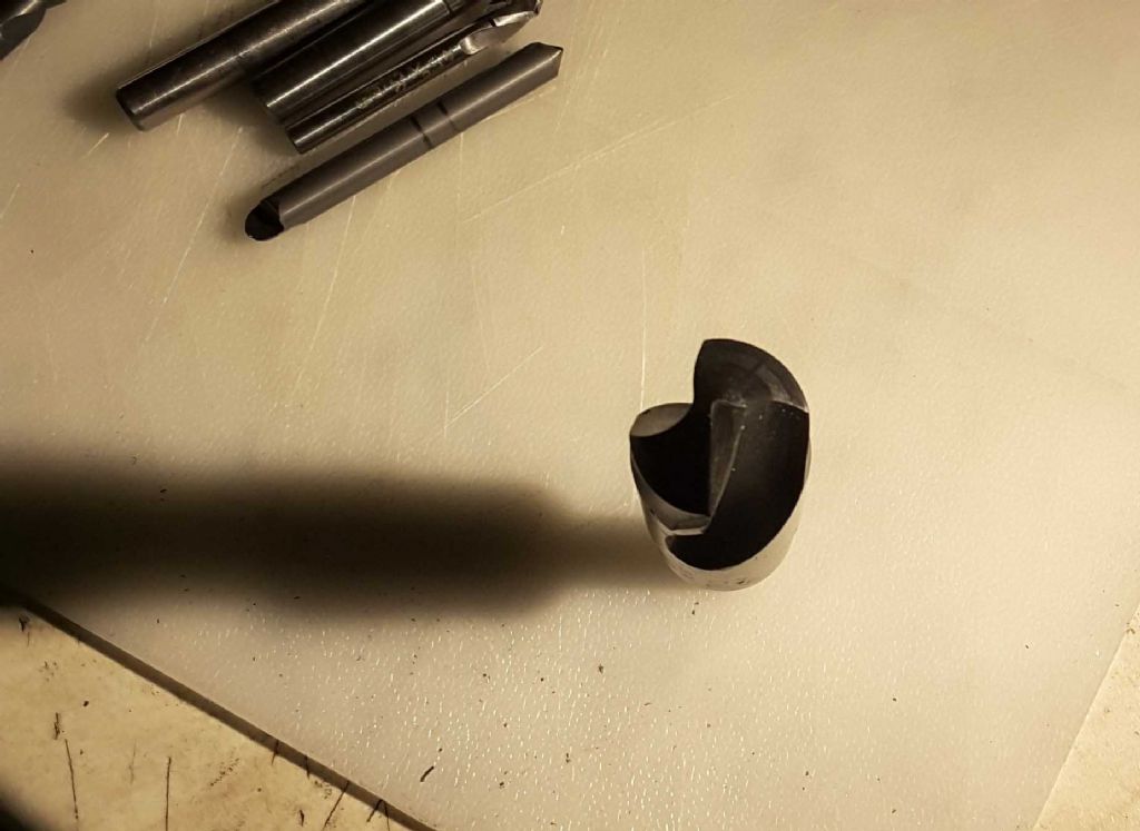

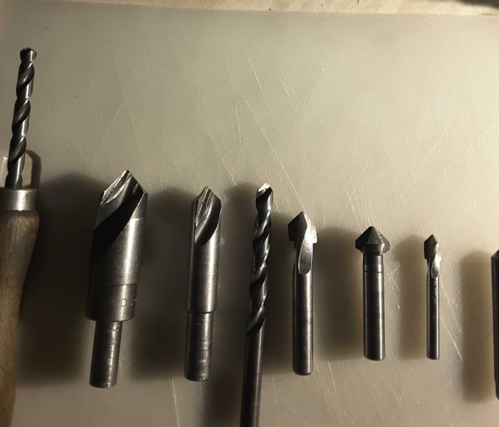

                                      I have also had very poor luck with multi-flute countersinks in metal. My preference is the zero flute (with a hole through the body) or a single flute. Both of those are chatter free and both can be resharpened with a Dremel. Just work the inside of the hole on the zero flute or the rake face on the single flute. One exception is a multi-flute carbide countersinl made by M A Ford. I suspect the 6 flutes are unevenly spaced to prevent chatter.
                                      If I have many holes to countersink I use a micro adjust countersink. It has a stop collar that can be adjusted to maybe .001". If you can find the tool used, I highly recommend it if you can find one. The cutters I have for mine are piloted. One cutter accepts interchangeable pilots. I believe the tool was originally designed for countersinking rivet holes in aircraft.
                                      Those who said to slow down the cutter were absolutely right. In effect it is the same as increasing the feed rate. A timid touch will almost guarantee chatter.
