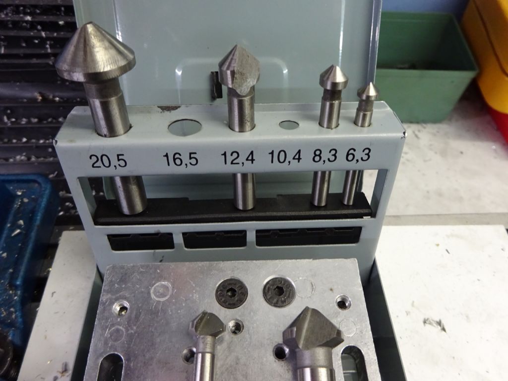

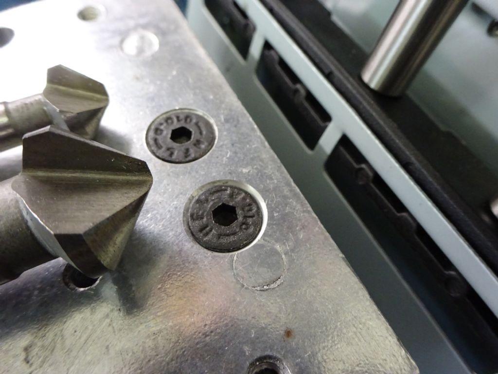

                              Most metric countersinks have the right dia head for each size CSK socket head screw so no need for making specials.
                              Two hole the far one done with the correct dia CSK and the one in the foreground with a larger one that leaves a more visible larger hole.

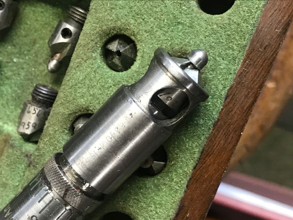

                                  John Paton 1
                                    @johnpaton1
                                    vanmar csink enlge.jpgIf you need to do a number of similar countersinks to a precise depth there are special tools to assist like this (brand names Vanmar and Zephyr). In use the countersink plunges down through the shroud onto the work using the pilot tip to centre it in the hole.
                                    I believe they are used in the aircraft industry for countersinking rivet holes in aluminium skinning.
                                    By adjusting the 'shroud' position relative to the countersink in the 'plunged' position you get exactly the depth you require and the shroud ensures that the countersink sits exactly perpendicular to the surface.
                                    You could easily make something similar for occasional use but omitting the plunge feature for simplicity. A 40tpi thread would give fine adjustment to the shroud extension.
                                    Please note that the countersink is not fully screwed home in this picture – I left it protruding to show its typical position when the countersink is 'plunged' during use (the spindle is spring loaded within the collar and the shroud is threaded onto the collar for adjustment)

                                          Anonymous
                                            Posted by JasonB on 29/04/2020 10:10:06:
                                            The diameters listed don't seem to tie up with either minimum head diameters or the maximum theoretical sharp head diameter, which would be needed if the head is to be flush?

                                              #467833
                                                I expect they have a good degree of clearance, would not really want them tight to the min head dia, much like if you want to use counterbores as the pilots for those are on the large side and teh counter bore dia is more than teh head dia.
