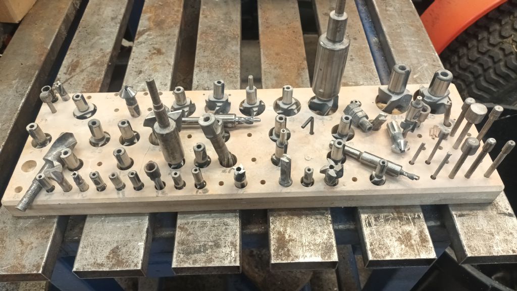

      I bought a joblot of machine tooling and it included these tools. It turns out they are granlund counterbores. I nearly had a heartattack when i saw how much they cost!! They vary in size up to 50mm. I'm never going to need a counterbore anywhere near that big so was wondering if I could use the larger ones as facemills or given the price of them better to sell them on.

          Hi Colin,
          Nice find, why not try one of the larger counterbores and see how it works as a face-mill.
          Thor

            Its teeth will probably not have side clearance so not operate very effectively as a face mill. As Thor suggests, give it a try? Nothing to lose.

              Thanks. I will do but given how much they cost I wanted to check I won't just trash them

                I ‘second’ your caution … Counterbores are specifically designed for plunge-cuts
                The use of a Rolls Royce as a chicken-coop springs to mind !
                Try offering one for sale … the result should ‘inform your decision’

                  I reckon I'm just going to find some projects that need a whole load of various counterbores smiley

                    I think you should select the sizes that would be most useful and keep them, sell the rest.
