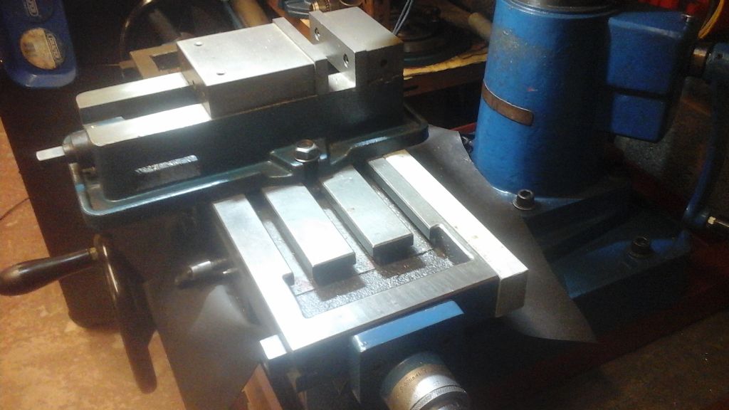

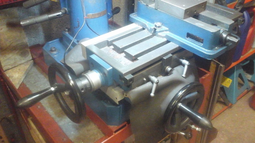

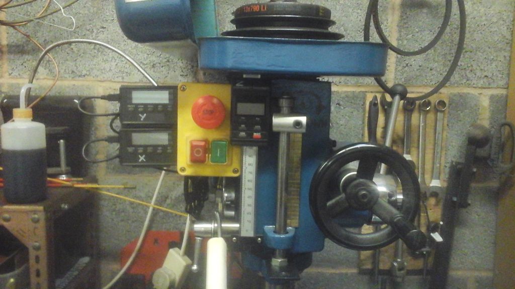

              20230218_090749.jpg20230218_090815.jpgI used the Arc Euro scales for my Naerok. Left and rear sides of the table, and on the quill. Quite straightforward fitment.20230218_090711.jpg
              #661734
              Benedict White
                @benedictwhite51126
                Many thanks John. I see you have a separate readout for each scale.

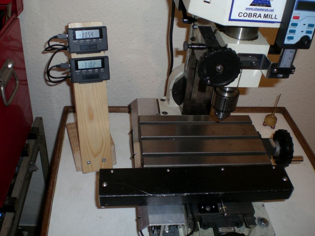

                        Hi Benedict, I too used Arc Euro scales Digital Readout Bars on my mini mill almost eight years ago, and they are still working fine, and like John used a standard vertical readout bar for the quill, which is similar to these from Arc Euro Standard Vertical Readout Bar
                        You can see how I fitted mine DRO's for a Mini Mill
                        Regards Nick.
