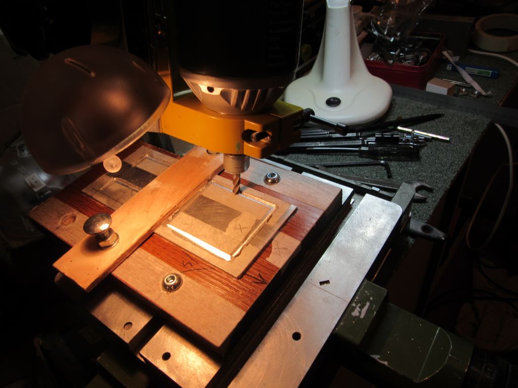

      Hi I have done some milling about 2 days 40 years ago. and I cannot remeber which way I'm supposed to feed the mill is rotating clock wise looking at motor end should I bring table towards me or away from me on the cut in photo.

                    Can't quite see from your photo but are you using the full width of the cutter? if so will the square in the middle be waste once its all cut out?

                      the cutter starts on first pass just to edge then little deeper on second and third and is just about full width on last
                      No the square is not waste, Think about internal house doors.

                        Imagine: If you tried to mill an unfastened piece of material, which way would the material fly? If it would fly away from the cutter… then that is usually called normal milling. However if the cutter pulls the material towards itself then that is climb milling.
                        You should be able to picture the above without actually attempting to mill loose items. Just try it with a vertical rotating pencil on the edge of a piece of paper….Much Safer.

                                Quite what you have there I'm not sure. If I am correct it looks like you are machining a piece of material on it's right hand side with another similar piece also present. You are moving the table away from you.
                                If you released that cross-piece holding the piece being machined, which way would your piece go? Answer should be – it will fly out the back, therefore you are climb milling.

                                  OK Looks like you are trying to make a miniture raised and fielded panel door and have the head tilted to do the raising cut. Sheet of metal held with a single clamping bar across the middle
                                  You are feeding in the correct direction for conventional millingthumbs up I would add something to hold down th eend of teh plate as well

                                            Thanks guys after sleeping on it and with clear head this morning think I've got it think what in getting confused with is thinking I'm doing cut with side of cutter when really I,m using end of cutter to do the work. As for the pieces of wood there just holding the work piece in place as I have no proper clamps (now ordered) along with rotary table.
                                            Jason yes you are correct it is a door the wood under it is fastened with 4 x 8mm screws to bed and the strip across top holds the aluminium in the wood as it has routed out section just enough to make door tight fit in it.
                                            One might ask why I'm making aluminium door! simple "I have no piece of wood around" and I don't want big sheet form Wicks at there prices so the plan is to get some at weekend without paying over the odds and use what I've learnt to make another.
