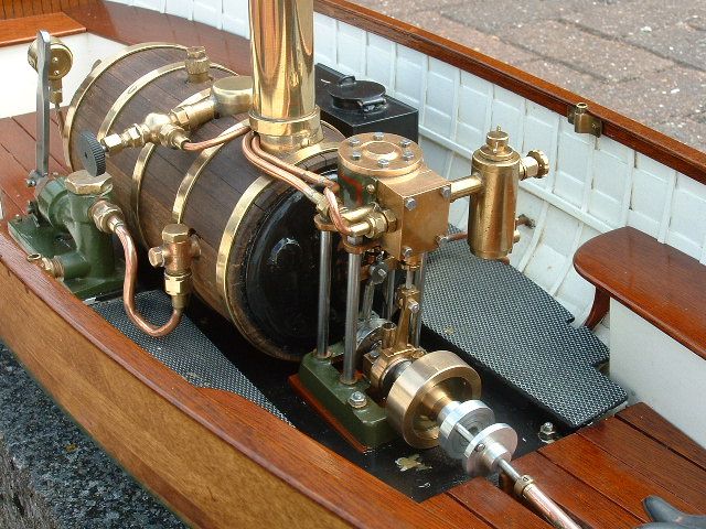

              You could put the lubricator feeding into the steam chest, it doesn't have to be in the boiler to engine steam pipe. the photo shows the lubricator on my engine.
              Trojan Steam Engine

                I thought the lubricator had to be in the steam pipe ? How does it pick up oil and get to the cylinder/piston ?
                I do not think it would be possible here :

                  Brian, mount the lubricator on steam pipe near steam engine. Some lubricator is mounted on pipe or on steam chest, both works well. http://www.rcdon.com/assets/images/Vertical_Boiler_Project_0260.jpg
                    As long as steam can reach the lubricator, some will condense in it (as it should be colder than the main part of the engine. This will slowly force oil up and along the pipe (as long as it doesn't slope upwards!)
                    In the steam pip is fine, but as I found, the initial dose of oil when it's cold can be quite generous…
