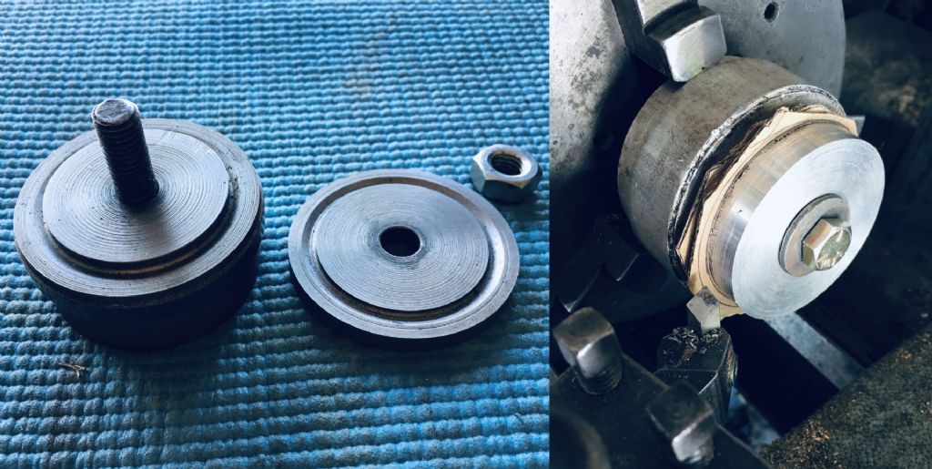

            I had a need when overhauling my differential for some shim washers and to make them I followed the following procedure. Initially I cut the shim stock into squares slightly larger than the final diameter required. The first operation then was to mark the centre of the square and use a small wad punch to cut a 3 mm diameter hole in the centre of the shim stock. This operation can be missed, if there is plenty of leeway on the final size. I then made a piercing punch and counter that was held in my bench drill, the shear being held in the chuck and the counter centralised on the table. The shear had a locating pin, which was used to centralise on the 3mm punched hole in the shim stock. Then a second cut of 15mm diam was then pierced in the centre of the shim stock. Two pieces of 3mm plate were then cut into two squares the plates had a holes machined for the aligning spigot and to allow the boring bar to pass through Clearance holes were drilled in the corners of one the squares, the other was threaded to take the clamping bolts. Assembling the punched shim stock on the spigot centralised the shims on the clamping squares and by turning the plates at 45 degrees the bolts were able to be tightened to form a solid unit .This unit was then centred in a 4 jaw chuck and was bored out to the required bore size of the shim washers. A large piece of round was chucked and it was bored and threaded and a spigot was turned to fit the bore of the shims, another round was bored to fit over the spigot and a through bolt was used to clamp all the shims together. The whole assembly was then turned to the final diameter required. Maybe not as quick as hand cutting, but the satisfaction of having well made shims was worth the effort.
            I have since realised that another method of producing shim washers now, would be to get them either water or laser cut, this method could also be used for producing tabbed lock-washers, although some sizes are available from bearing suppliers.

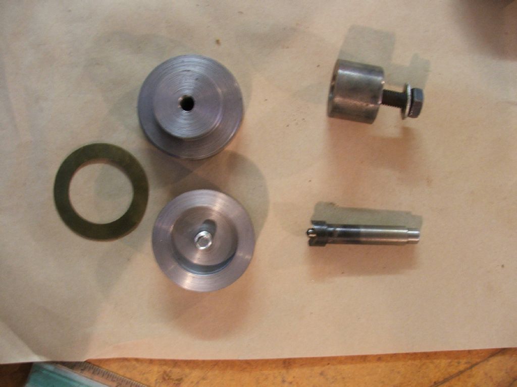

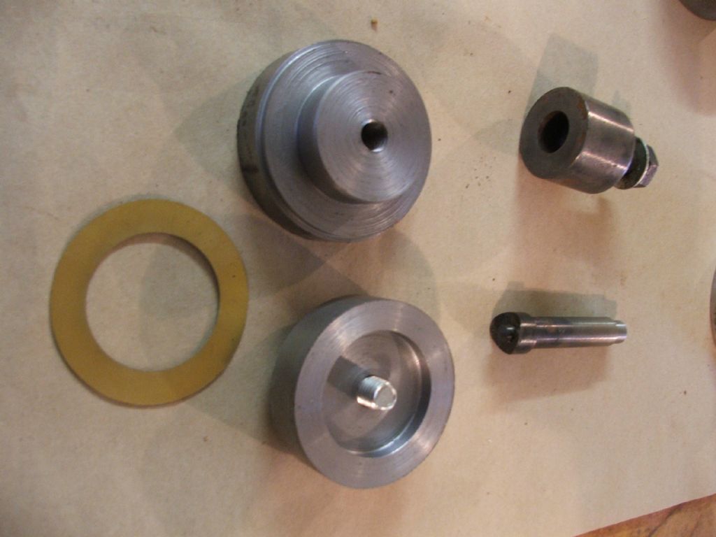

                                  I used to rebuild lots of car differential units. This work calls for a fair bit of shimming to achieve the correct bearing preloads, gear mesh & engagement depth. Unfortunately the shims only seem to come in bulk packs of the same size from the differential manufacturers. I'd have been quite some way into 3 figures of £££s by the time I had bought a full set of each size (and would have ended up with several lifetime's supply of shims). My solution was (and is) to use a pair of chassis punches to punch the inside and outside in steel shimstock.
                                  These and other punches were bought off ebay for not much money; but I have made smaller size punch & die sets at home from silver steel, turned all the parts and used a flycutter to put the cutting radius on the punch before hardening and tempering.

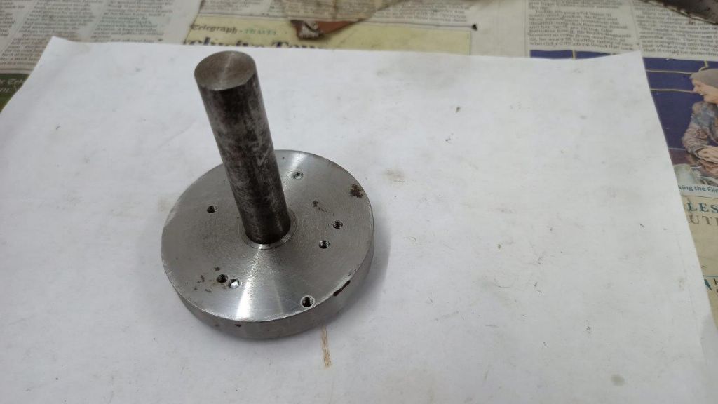

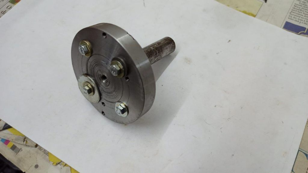

                                      Hi, I have made shims in the past using Paul Lousick's method, but for many years I've made shims from shim stock by clamping pieces of the stock, cut into a rectangle using shears, to a flat disc that has a shaft on it, so it can be mounted in the lathe and then cutting the shim out from the stock.
                                      Cutting shims from this is not trivial, but it can be done, and with practice it can be done very quickly. I've used a watchmaker’s graver (difficult to keep it steady), a sharpened up piece of hacksaw blade held in the tool-post (tricky, needs to be very sharp and not to have any top rake or it digs in badly especially when breaking through), and, best of all, a small air die grinder held in the tool-post (using a small cylindrical wheel held at 45 degrees).
                                      I scribe the ID and OD on the piece of shim and then in the lathe I centre it and tighten the clamp screws, which have washers under them, and then start the cutting. You cut out the inside first and then the outside. The cut edges are sharp and I often tidy them up using a small abrasive mounted stone.
                                      I use this device mainly to make shims needed on classic motorcycles, typical shim thicknesses are in the range 3 to 12 thou. The pictures below show the tool used to hold the shim. I tend to drill and thread holes as demanded by the size of shim to be cut. It takes me about a quarter of an hour to make a shim provided that the shum doesn't snag when breaking through (the die grinder method more or less obviates that). I hope that helps.
