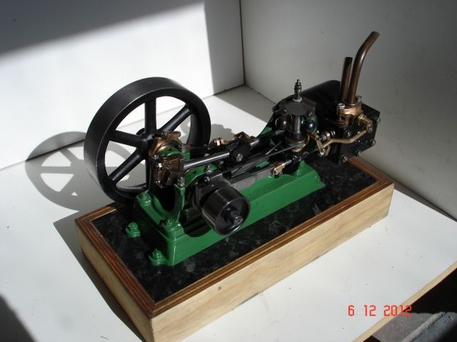

            I made the base for a ST S9 by gluing the mitered corners of a ply wood box, I formed a step inside and glued the (black marble), Malamine covered MDF top in. PVA glue
            Ian S C
            Edited By Ian S C on 27/01/2017 11:39:31

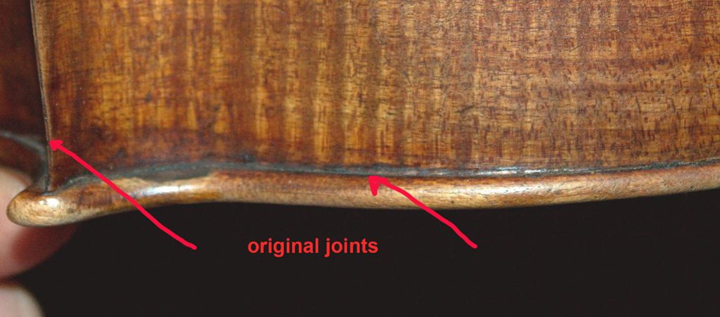

                    I use proper hide glue ,its fantastic stuff and can last for centuries ,though not outside .Though im biased because im a musical instrument maker. Liquid hide glue (ready made ) on a violin neck i wouldnt recommend ,its nasty stuff .
                    These joints on my personal violin that i play  were made in 1695  ,how many modern glues can last that long.
                    Edited By mark smith 20 on 27/01/2017 19:37:28
