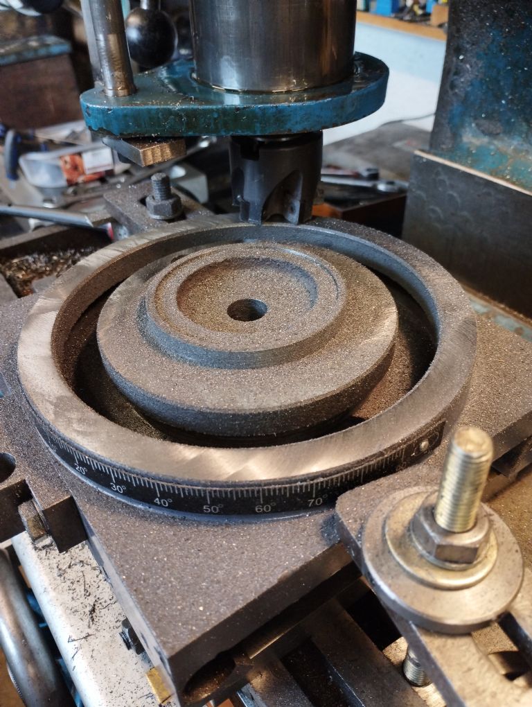

                The first task after dismantling the machine was to assemble the stand. A thin sheet metal box held together with a few nuts and bolts. My first thought was this is going to vibrate, it does. There is a small door on one side, for a coolant tank and pump, I believe. Not fitting a coolant system so I have cut out part of the front of the stand and fitted a shelf inside. This will create useful storage space.
                I also raised the height of the stand with a couple of pieces of 4×4 timber for a more comfortable working height.
                Lifting the base of the machine was a two man job as was upending it to remove the moulding sand still stuck to the casting. What must that do to the manufacturers machines?
                Accuracy checks, two rollers in the dovetail and measured with a micrometer and the depth of the dovetail were good. I tidied up the slot for the Y axis nut passes through and went over all the machined surface to remove any burrs.
                All the cast surfaces had been filled and painted, the filler often being of considerable thickness. This I removed from wherever a nut or bolt is located. Absolutely vital for a properly clamped joint.

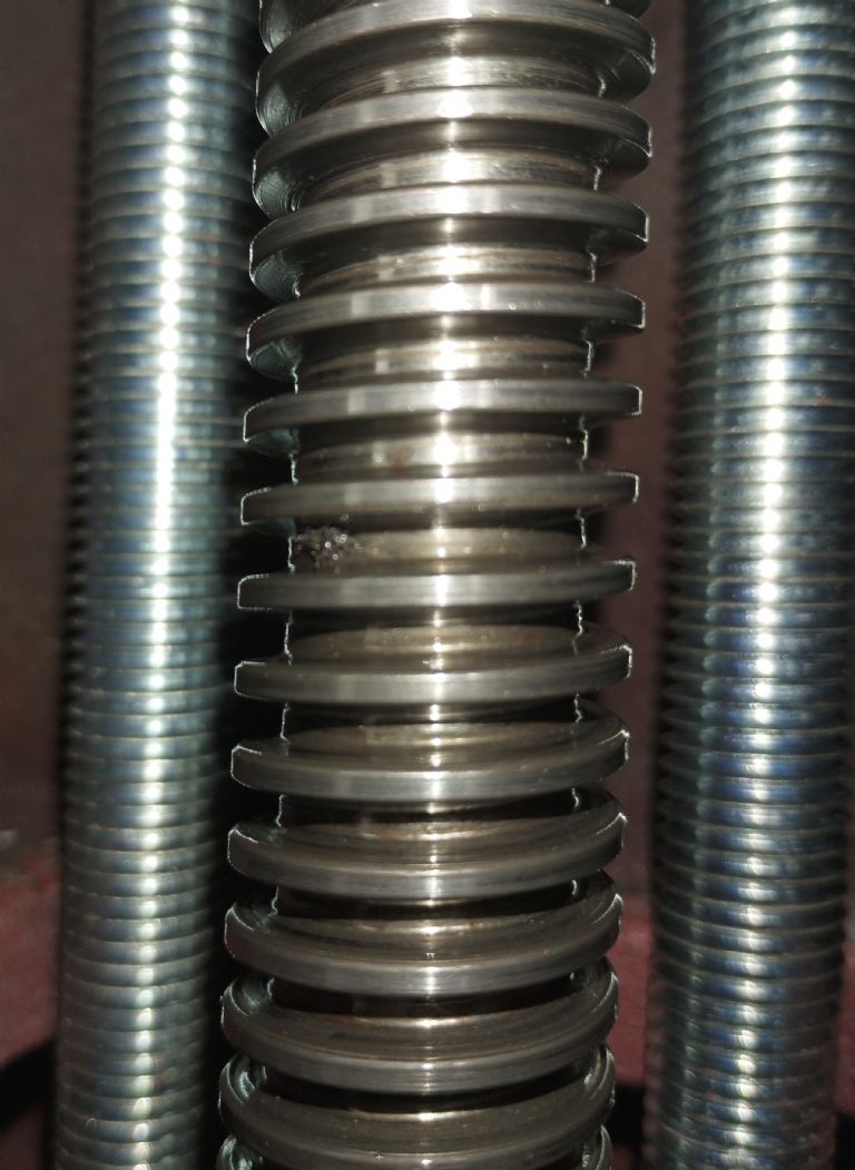

                    To this end I have fitted two lengths of M16 all-thread that further clamp the column down to the base. A thick steel plate on top of the column and another under the ribbing on the underside of the base. I tightened the nuts to somewhere around 230Nm (170 ft lbs), to load the column in compression.
                    Will this help, yes, but con't ask me how much!
                    The two legths of all-thread fitted snuggly either side of the Z axis leadscrew as the photo shows.

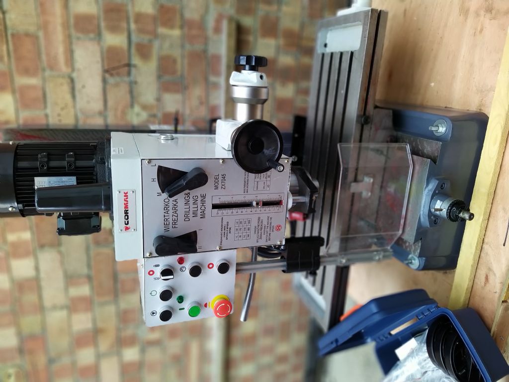

                        Before opening up the gearbox I decided to run the motor. I bought the 3 phase version so I could use a VFD to increase the speed range aswell as use the variable speed option.
                        The head was sat on the workshop at this point in a wooden cradle. I connected up the VFD with the help of a couple of forum members. Would have been easier if the instructions for the VFD were correct!
                        I ran the motor from 5 to 80 Hertz, all seemed well, reasonably quiet and gear selection okay.

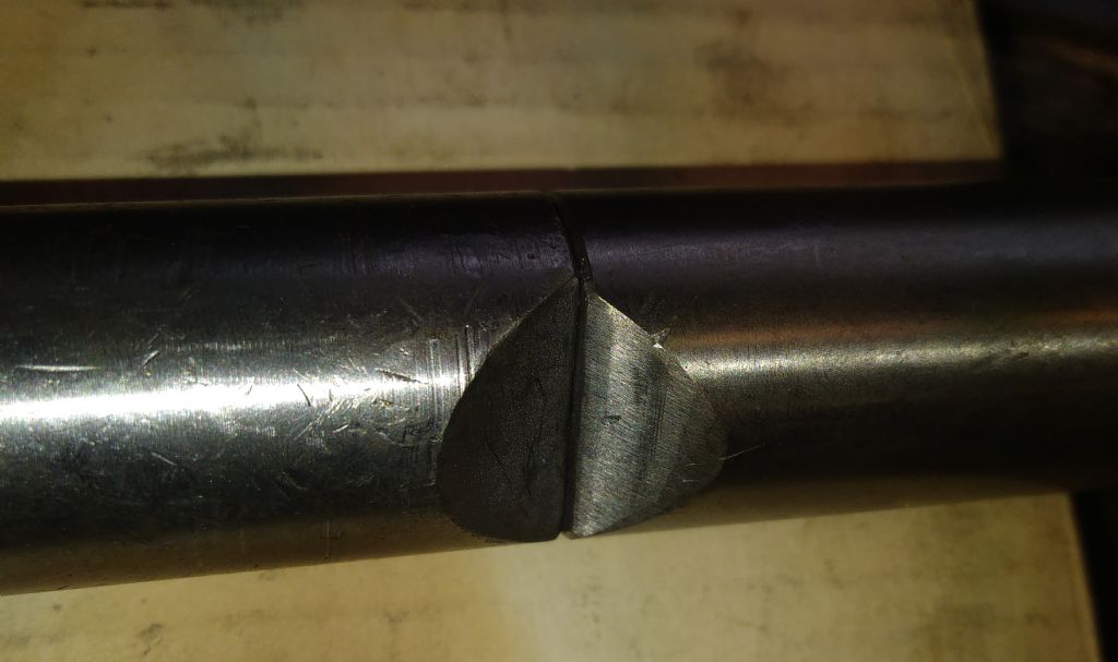

                          The quills key (to stop rotation) is an M10 grubscrew locked in to position with a nut. All of this is down a deep counterbore that is too small to get a socket on the lock nut. I made a new locknut with a smaller AF dimension so a slim socket could get at it.
                          With the quill on the bench I removed the spindle. No horrors here. I fitted an oil seal in to spindle dust cover. The outside diameter of the spindle is 45.5mm so no seal available. I fitted a 45mm I/D seal with a 68mm O/D, it seems to have the flexibility to cope with the oversize shaft.

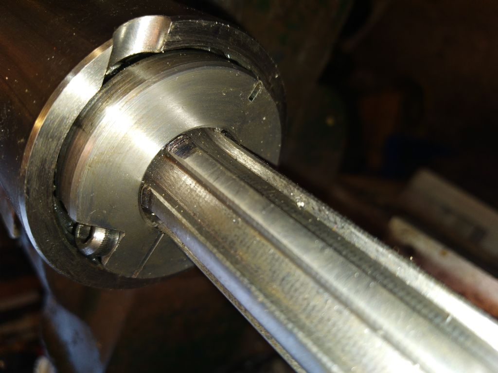

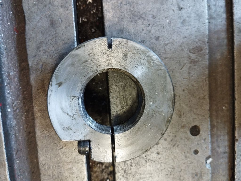

                          The bearing adjustment was a very poor arrangement, a slotted nut held in place (hopefully) with a tab washer. Something very common on these far eastern machines. I made a theaded ring with a split the can be locked in place with an M6 cap head screw.
                          As can be seen from the photo it was necessary to machine a small slot to give access to an allen key. This arrangement gives a far more positive clamping force than the original arranement.
                          The tapered roller bearings need to be adjusted with, ideally, zero clearance. In practice difficult to achieve so aim for a slight preload. It won't hurt the bearings and will improve rigidity.

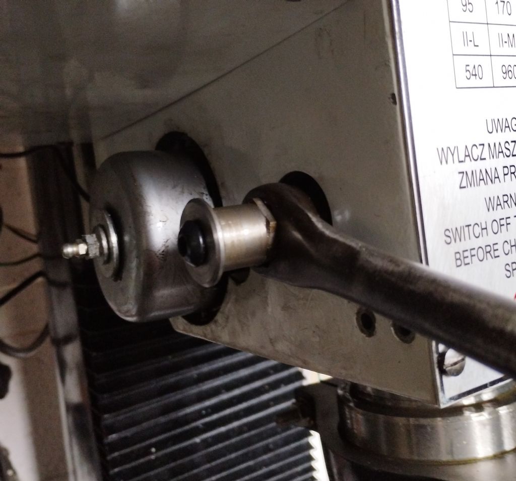

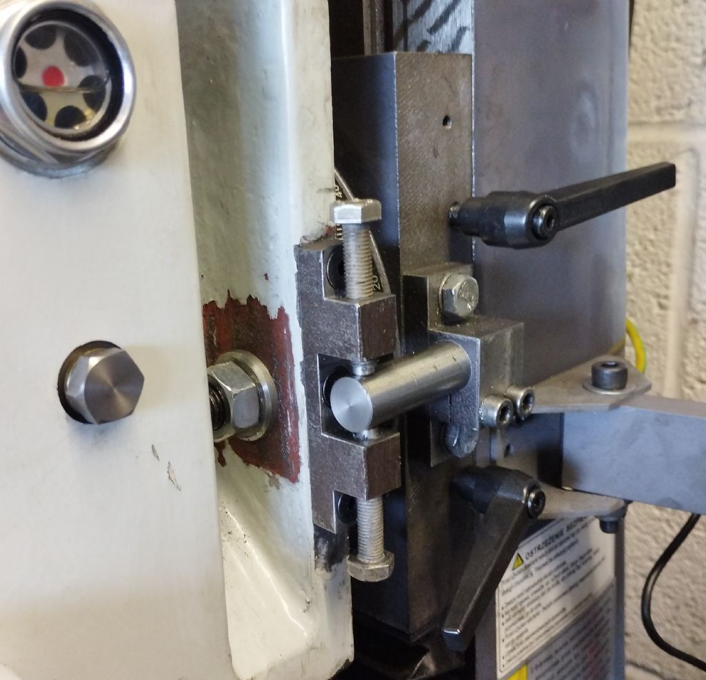

                          The quill lock is a good arrangement poorly executed. The locking handle, extended to clear the electrical equipment box gave very poor feel as to how tight or otherwise the clamp was. The lock itself is two pieces of cast iron with crude chamfers that pinch the quill to lock.
                          I machined a radius in to the two clamps equal to the radius of the quill. The photo shows the arrangement for doing this, the tube in the foreground was use to set the boring head to the correct radius to do the job.
                          I fitted a "loose" spanner, captive on an extended nut to act as the clamping lever.
                            Awful style of "locknut" those.
                            If, when you check spindle runout with a test bar, you find that there is a runout error – suspect that locknut first. I once spent a couple of days trying to eliminate a runout error in a Boko borer spindle that my former employer was rebuilding. New precision bearings fitted, but the spindle runout was out of spec. Tried all ways to set one of that style of locknut, but regardless of what order of assembly or tightening, the final "nip" on the screw always introduced a runout error. Fortunately the spindle thread was a standard size that was available as an SKF KMT precision locknut – not cheap items, but fitting one had the spindle preloaded to spec with the locknut fully tightened & locked with no spindle runout within 10 minutes of delivery of the SKF nut.
                            I concluded that the spilt style locknut nut twisted when the locking screw was tightened, causing an uneven application of thrust to the bearings.

                              Something not right there. Assuming it was a Boko metalworking machine, these are substantial machines, it would take a lot of force to distort the spindle to introduce an error. Where was the bearing adjustment ring? For rigidity at the top of the spindle? Probably some 300mm separation? Clamping the adjuster upsets run-out at the cutter end? If the KMT's ability to be tightened selectively to reduce error then that error needed to be investigated.
                              I would strongly suggest the error was elsewhere.
                              I did consider useing a KMT style locknut, axially too long, not enough room to accomodate. Also, it would be clamping on a splined part of the shaft, it might clamp on the thread, it might not.
                              The locking ring I have described is very effective. Easy to make, the accuracy is easy to achieve, clamping/adjusting face perpendicular to the screw thread when machined at the same settting. Made properly, once the adjustments made it will not upset that setting. I hope your comments do not put others off using it.

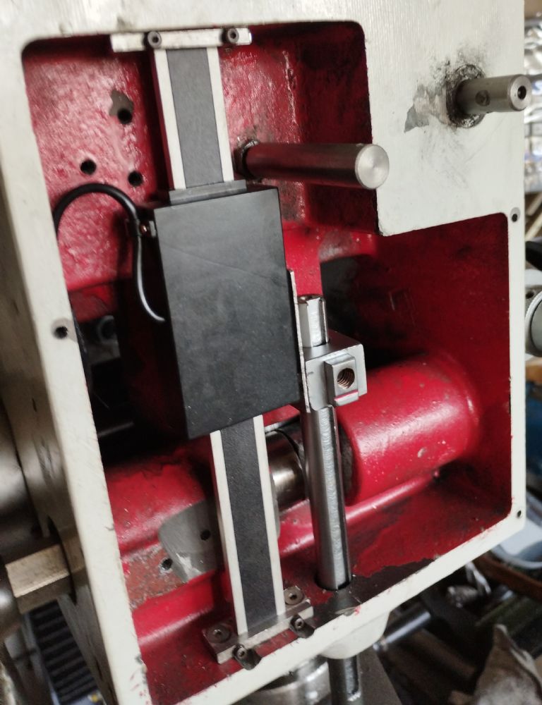

                                  At this point I fitted a two axis DRO to the X and Y movements. I decided not to fit to the Z (column) axis, this is for positioning the head, the precision movement is done by the quill. I hope my reasoning remains valid!
                                  I fitted a basic DRO to the quill and was delighted by the fact I could get it fitted within the head casting, just.
                                  I also connected the VFD using the existing switchgear box for the VFD remote controls.
                                  The round bar adjacent to the dro is for oiling the quill and its bearings. Its screwed in to an existing hole in the quill guide and protrudes through a hole in the cover. An oil cup screws in to the top of the bar.

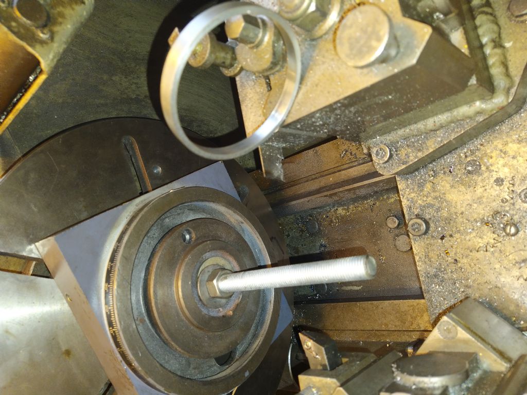

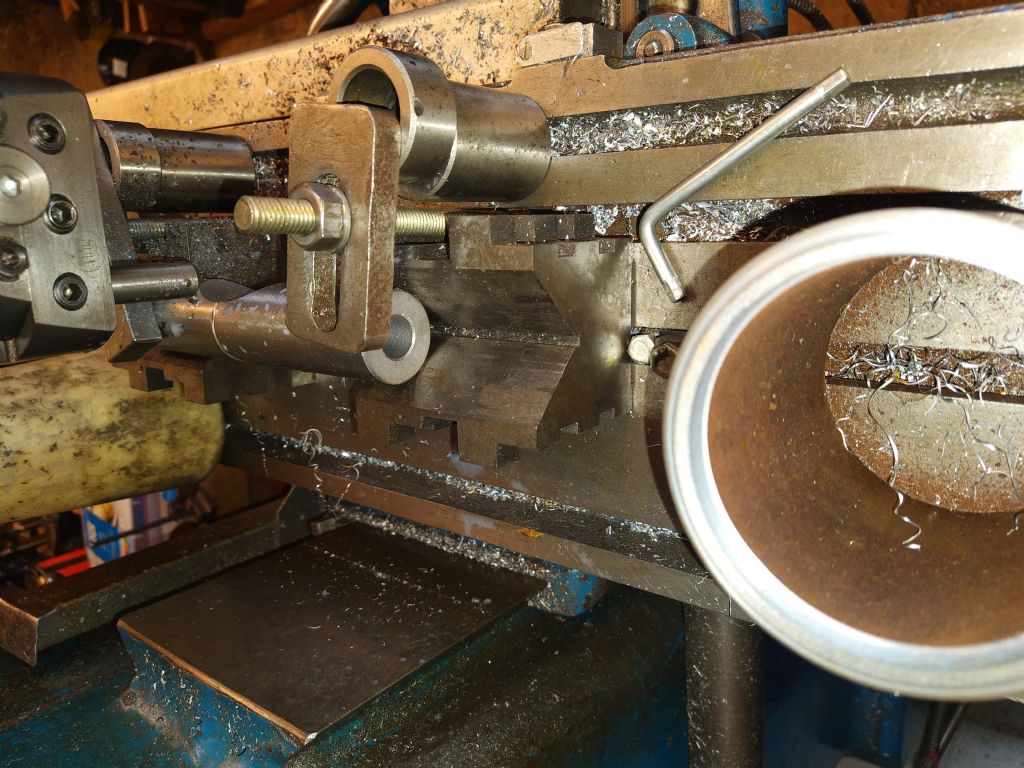

                                    Time to sort out the "nodding head" error. To recap, the head needed 0.008" (0.2mm) shim trapped between the head and Z axis slide to bring the quill perpendicular with the work table.
                                    After gettting a friend to check my reasoning/method I clamped the slide to the work table of another mill. I shimmed it in such a way as to duplicate the shimming that corrected the error.
                                    A fiddly job manipulating the cutter around the spigot!
                                    Before machining I checked that the spigot would not jam as it would be misaligned. A bit of trig showed the error was very small and as I mentioned before, when I improved the fit of the spigot I left some clearance to avoid jamming when the clamp bolts were released, just as well I did!
                                    Reassembled and checked the accuracy. Remembering the error was 0.008" (0.2mm) over 6" (150mm). The error front to back (Y axis direction), is now ~0.0015" (0.04mm) across the full width of the table, 9.5" (240mm). Happy with that for now.

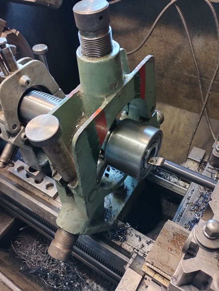

                                      The excessive overhang from the lower spindle bearing seems to be a generic feature of this style of machine. It will, without doubt, hamper the performance of the machine. It would be so easy at the design stage to eliminate this unneccessary overhang. Could it be done so as to incorporate driving slots for face mills and the like? Very necessary on large powerful industrial machines that are made to work hard but our machines don't need it.
                                      My first go at reducing overhang reduced it by some 35mm, that is to say the bearing was 35mm closer to the load it is supporting. I achieved this by maching away the overhang until the spindle was almost flush with the end of the quill and what was now the oil seal holder.
                                      Then I remachined the 4MT to bring the various chucks etc as close as possible to the end of the spindle. This, of course, made the drift slot redundant. A tap on the drawbar unlocks the bearing.
                                      The photo shows the setup for machining. The spindle mounted in its bearings in the quill. The steadies holding the quill so that the spindle runs in its own bearings. This ensures absolute accuracy. It was fortunate that the spindle had enough "meat" in it to allow modification.
                                      The machine was reassembled and put to work. The improvement was noticed immediately. By way of a comparison I used the machining of the head adjusting device I described earlier. I machined some of it before and some after the spindle shortening work, this made for a good comparison.
                                      I wish at this point I could say I was pleased with this but I cannot. I could not help but feel what I had done in reducing the overhang was a "half a***d" job.
                                      Look at the photo of the machining setup, the lower end of the quill is a big lump. The bearing sits some 15mm from the end of the quill. While the spindle was dismantled for cleaning up after the work described I took measurements of the quill, spindle and other components related to the assembly. Then drew the assembly on the computer. I have now reduced the overhang by a further 21mm. This will mean (I haven't done it yet) a new spindle and modifications to the quill. I'll describe this when its done. I've only just ordered the the steel (EN8) for the spindle and bearings. There may be some further gain, I need to see the bearings "in the flesh" to see how the cup and cones of the tapered rollers fit together and determine the space needed. I think SKF's recommendations look rather generous.
                                      Incidentally, the original quill is case hardened, not really necessary, I think, especially as the morse taper surface and the splines were not hard! The spindle did not machine well, a hardness test revealed that the spindle was just over 200 Brinell, so not much harder than mild steel.
