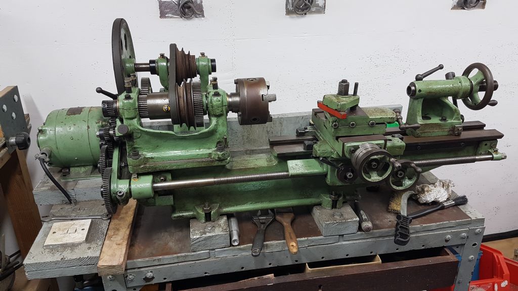

My lathe just has 1/8" holes on the headstock for oiling. Of course I need to remember to drop oil in as I use the lathe and I never know if I am over or underdoing it.

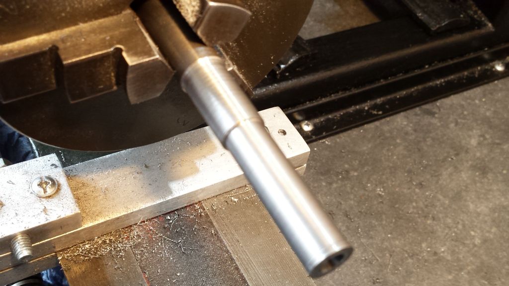

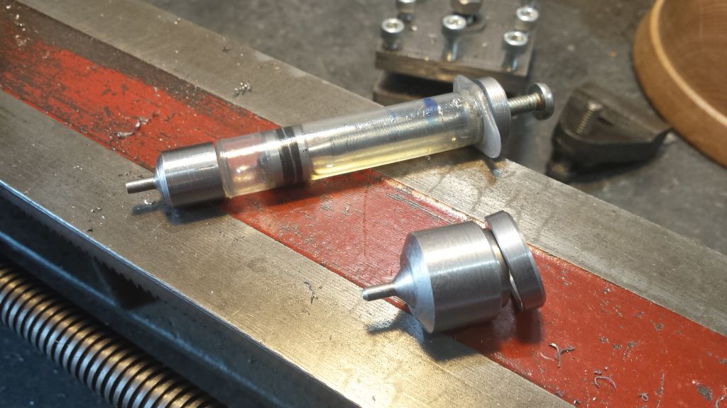

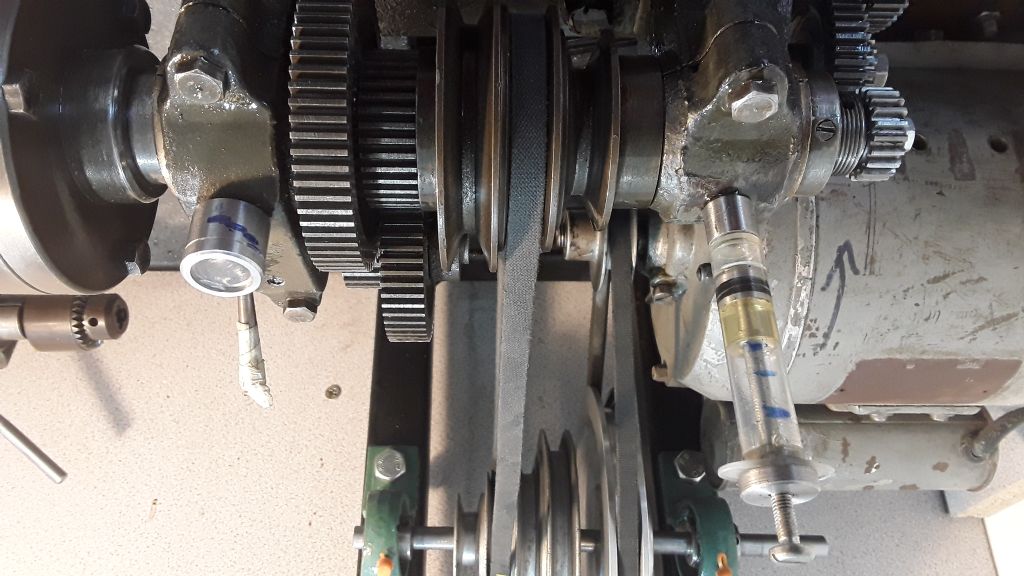

Andy mentioned how drilling and tapping these holes for a proper oiler may contribute to cracking, so I made up a couple of oilers as shown. The one on the left is a free syringe from the pharmacy with some scrap bar and a screw.. Your can watch and count the the drops if paint drying is too exciting. The blue marks are meant to show level every 15 mins. It is all a bit sensitive – how can I improve control. I could modify these for a tube and wick – any idea on min tube/wick size.

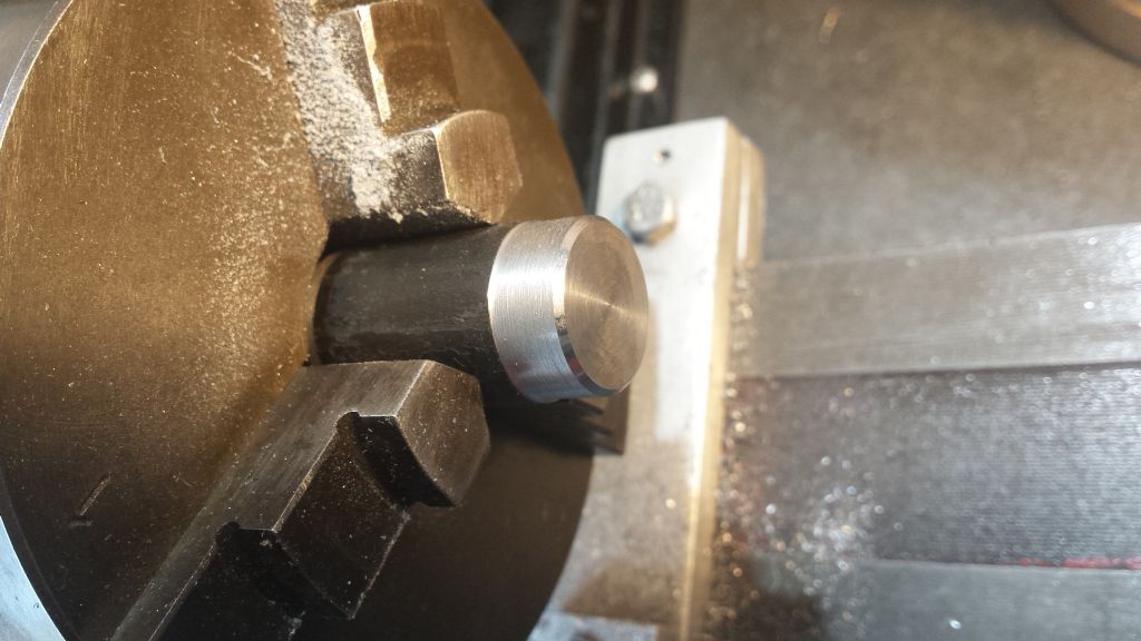

Since I don't particularly like the above, I also made up the one on the left. Looks simple but a good exercise for a newbie. Different tapers needing me to grind and use right hand, left hand, round nose, boring and chamfering tools. The clear plastic for the top lid was a real pain and does not really work. The hole in the bottom is 1.5 mm and the oil runs out quickly. Don't have any felt or coffee filter, but tried various sponges and paper on the bottom to slow it down to drops. Best seems to be a single circle of normal writing paper.
The blue lines were marked every 15 mins. How much oil is required – ny idea of cc per hour?
Not sure if these are better than dropping, esp since only a fraction iof the time is spent rotating. Any suggestions to improve. Any suggested new design. Another thread talks about cheap Chinese oilers that may have a 1/8" thread – would these work for me?
