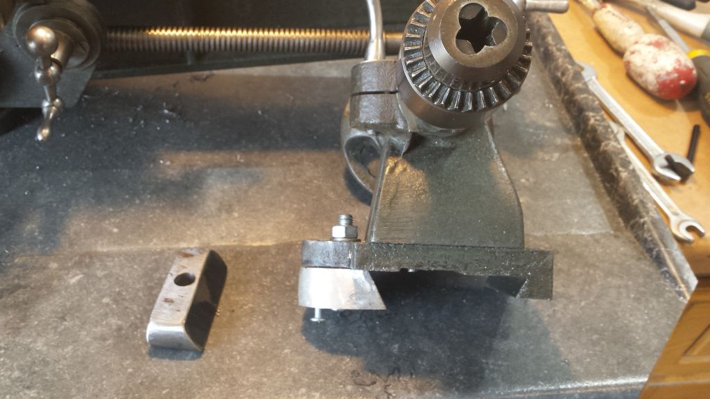

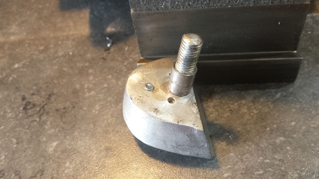

      Next I needed a rough headstock and tailstock alignment. I do not yet have a clock – that is another discussion.
      The headstock is held by three bolts and it does not have an adjustment mechanism – just loose bolt holes. I stuck a long bar in the chuck and a square bar in the topslide. Roughly adjusted the headstock by running carriage up and down the bed. Rotate bar and look for same gap.
      Tailstock is held by a pin and one bolt. Again that can swivel and I did my best to point it at the headstock taper.
      I know all this needs redone by Rollies Dad.
      I sharpened a knife tool on my £15 grinder. See pic – don't laugh – I did this for woodturning chisels and it works fine. Rough grind on stone followed by belt is definitely the way to go

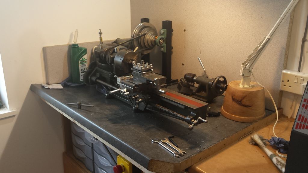

          #556678
          Andy Thompson 3
            @andythompson3
            Thanks guys, making more progress with your advice.
            Good News and Bad news

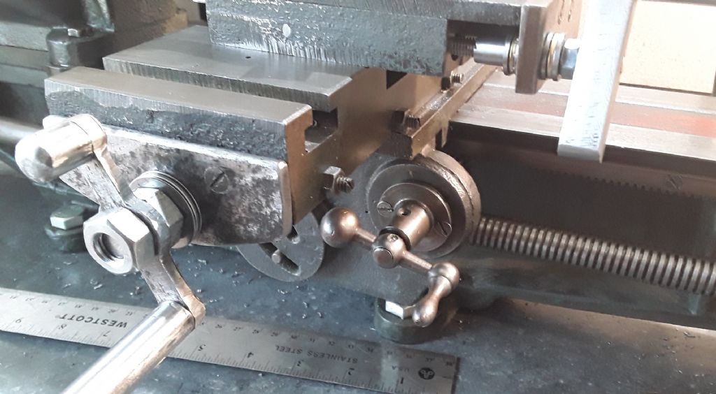

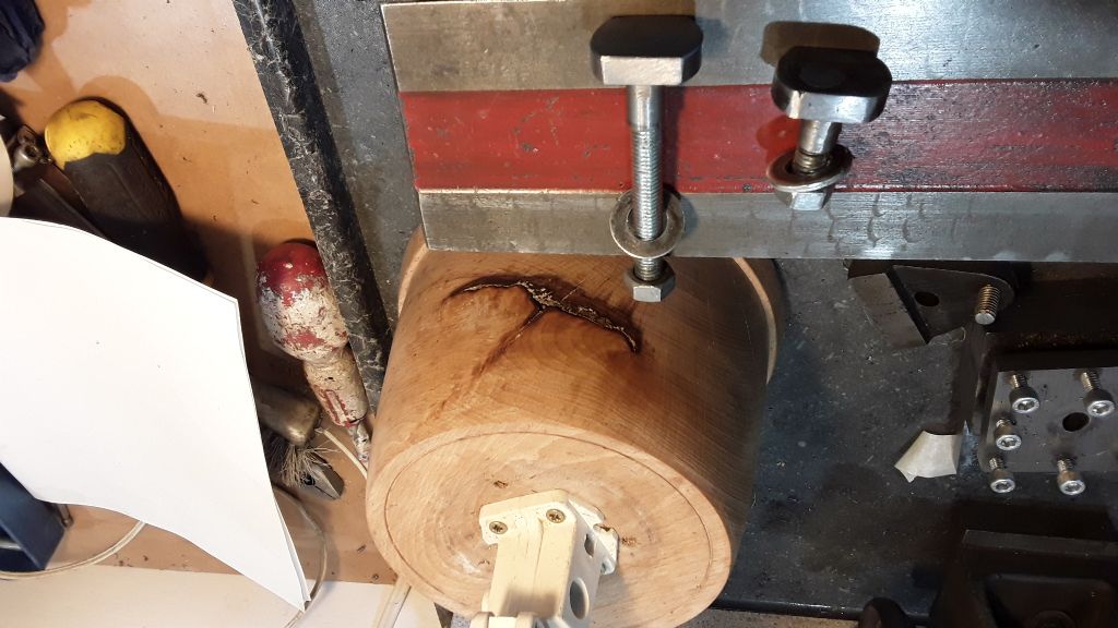

            Installed lathe on bench – see picture – it is a bit narrow so mods may be required. I have ordered a no volt switch.
            Installed thrust bearings on slides – see pic. What a difference, makes it a pleasure to wind them in and out.
            Ordered a missing screw gear from Myford – 20T and 14.5 but sems a little different. Turned a spigot to stick in the spindle and mounted the gear on it. It drives the saddle at 5 thou per revolution or 0.13mm. Does this sound right – seems fast to me but what do I know.

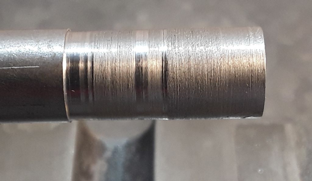

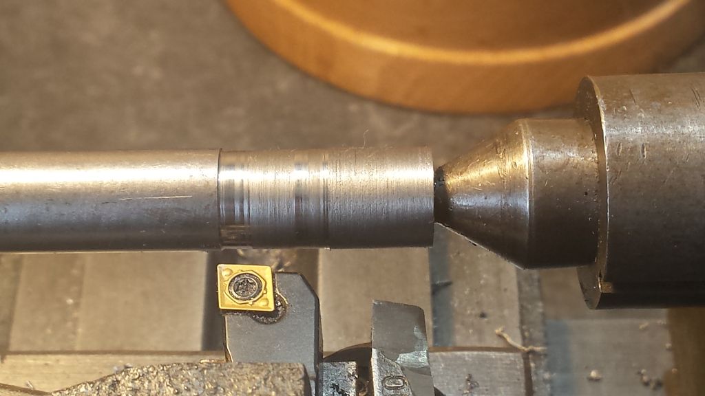

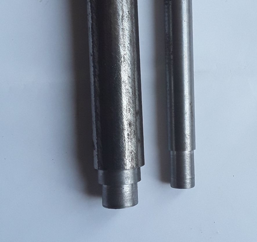

            But now the concerning news. Ordered a dial gauge and mounted it as per pics. With dial on backplate when I rotate by hand I get TIR of 0.08mm/0.003". However when I stick a long bar in the chuck and apply a fair bit of pressure, I get sideways movement of 0.25mm/0.01" and up and down movement is similar. Are my bearings and spindle knackered!!!!!
            Is this why I get a finish as shown in last pic. On the right was HSS knife tool (self ground) with and without feed. The start of the shiny bit is carbide with manual feed, not all of this is shiny. Screwfeed is chewed again, then I went back to slow manual feed and it bit a bit better.
            Any idea what is the problem. Any other advice.

              Forgot to add picture of the finish as below

                There are loads of reasons for bad finishes – the material and the tool amongst others.
                If you want to eliminate the bearings from the equation then take a long piece of bar that will go through the spindle, centre drill it, entend it a long way out of the chuck and turn the OD using a tailstock centre for support.
                Bell mouthed chuck jaws are another thing to check for before deciding that your bearings are the problem. TBH most old chucks have this issue to some extent. It comes from being overtightened on short workpieces in the past. Some shim around the workpiece at the outer end of the jaws can compensate for this, albeit that it's a bit of a faff to set it up each time.
                Apart from the measurements I mentioned in my previous post you could use your DTI at a point on the spindle close to each bearing in turn. Then you should be able to figure out if the play is coming from one bearing, both or (hopefully) neither.

                  Thanks Andy. I should have said that finish was on a 1/2" piece of EN1A that was also supported by the tailstock. You can see this and the tools I tried in the picture.
                  The main reason for my concern was the TIR when I hauled the bar back and forth and up and down. What is normal for a test like that. The TIR when rotating is about .08mm/0.003" which sounds ok to me, but when I pull the bar I get 0.25mm/0.010".

                    I can't see how far away your work area is from the chuck but I'd say that being so close to the tailstock the finish is telling you very little about the state of your bearings or chuck. The tailstock is providing most of the support here, so the potential causes are the tool, workpiece material, the support of the job (i.e. the tailstock in this case) and the rigidity of the tool holding and everything beneath it.
                    The HSS tool doesnt look terrible – a bit sharp though – you should very slightly round off the corner of the cutting edge which will make it last longer and probably cut better. Check that the tool is exactly on centre height. If it's EN1A from a trustworthy source then that should be OK too. Check that your toolpost can't wobble in any direction (play in feed screws can be a cause), lock everything that doesnt need to move, keep the tailstock barrel 'stick out' to a minimum and nip up the tailstock barrel clamp (but no need to go mad).
                    I'd avoid power feeding TBH – most of these lathes don't have a fine enough feed to give you a nice finish – that's why you sometimes see some quite Heath Robinson fine feed contraptions attached to them. Another observation I'd make is that if you want a very smooth finish then you'd be better off with a round nosed turning tool rather than a general purpose pointy one.
                    Carbide… not something I have much experience with TBH. I use HSS for 99% of my lathe work. I don't think these old lathes will derive any benefit from carbide.
                    But mainly… keep at it, I don't think your results look too awful and with practice and careful checking of all of the variables your results should improve. You won't get perfection every time though so don't get too stressed over it.

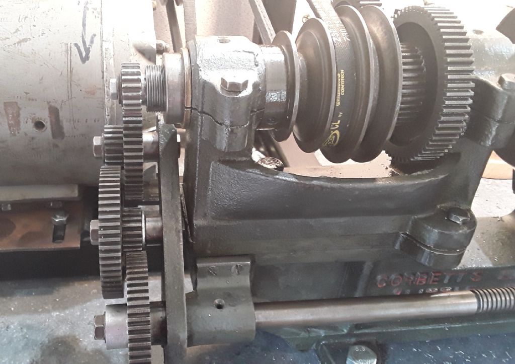

                                Sounds like you do indeed have some bearing play.
                                I have a spindle and bearing shells from a high mileage scrapped Faircut lathe stashed away so I decided to dig them out and do some measurements. Your spindle and bearings may have a different design but this should give you a few ideas…
                                One thing that I had not thought of previously… the front end of the spindle bearing area protrudes by a few mm from the bearing. This part of the spindle surface is unworn so it provides a way to get the original diameter. There is also a smaller ridge inside the rear end of the front bearing shell but this is less useful.
                                As expected, getting repeatable and reliable measurements inside the bearing shells is difficult without any proper internal measurement kit. It's possible to get some measurements with calipers but inevitably they will be wrong. I was able to detect some degree of ovalness in the front bearing shell.
                                I think the best approach is to figure out the nominal diameter of each bearing and work from there. You should be able to get an accurate idea how much diameter has been lost from the spindle. For the bearing shells… a not very accurate idea.
                                My front bearing has a nominal diameter of 1 1/8 ins (28.575mm) and the rear one 3/4 ins (19.05mm).
                                I dont have a 1-2 ins mike so can only use calipers on the front bearing.
                                On the unworn ridge I get 28.55mm suggesting that the spindle was originally 1 thou below the nominal size.
                                On the worn part I get 28.40mm so it has lost about 6 thou of diameter.
                                Inside the bearing I was getting 28.62 to 28.65mm
                                On the rear bearing I got 19.00mm on the shaft with the calipers and 18.99mm with the mike. I got 19.10-19.14 using calipers inside the bearing.
                                The wear on the rear bearing is numerically less severe… but that's the one where the bearing housing snapped and resulted in the lathe being scrapped. The failure is due to the smaller amount of material in the rear bearing housing along with weaknesses arising from the oil holes (modified to take bigger oilers in this case) and any imperfections in the (not very brilliant) casting. Basically you can't predict the point at which the casting will fail but if it happens it's pretty much 'game over'… so tread carefully.
                                If you want to go down the oilite route then you should be able to figure out which ID to buy. Likely you will have some work to do to match up the OD. You will also need to figure out a way to provide any thrust flanges that exist on the originals. This approach would eliminate the bearing shell wear but you'd still have the lost diameter on the spindle itself.
                                The saga of my Cowells GEC motor bearings may help https://www.model-engineer.co.uk/forums/postings.asp?th=138249&p=1
                                Another option would be to get hold of some bearing material (there are whole threads on this topic – I decided on LG2 for my cross slide nuts) from M-Machine or elsewhere and machine new bearing shells. Buying hollow bar would be less wasteful than solid. You could make these undersize on the ID to compensate for the wear on the spindle. Measurement will still be a challenge. I did this by making my own plug gauges. As well as the required diameter, the gauges have a taper or a set of steps with slightly smaller diameters so that I know when I am getting close to size.
                                … but I still think that the bearing play is not the cause of any bad finish when turning so close to the tailstock centre. I'd put any work on the bearings some way down the queue until you have more experience of lathework.

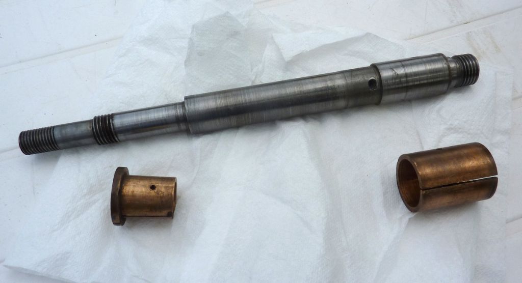

                                #556749
                                Andy Thompson 3
                                  @andythompson3
                                  Thanks Andy – really appreciate your experience.
                                  Pictures of my spindle and bearings below, clearly there is some wear on both. The nominal spindle od must be 1 1/4. There are flanged 1 1/4 " oillite bearings available here https://www.getyourbearings.co.uk/flanged-oilite/aj202624.html – very cheap. I would need to check the OD and maybe machine. I read that oillite bushes are oversize to allow for compression – that may not be great for my worn spindle – I presume smaller 30mm bearings would be too difficult to scrape.
                                  However, I take your advice that I should try to sort out my finish and get some experience first. As you suggest, rounded cutters seem a bit better.
                                  I read your thread on motor bearings – particilary that the bearing needs oil. My motor is a monster and I am not sure what sort of bearings it has. Took a cap off the back and stuffed grease in there. At the front there was a screw over the bearing so I took that off and stuffed grease in there. Should I have used oil?

                                  #556751
                                  Redsetter
                                    @redsetter
                                    OP- Your work on this lathe so far has been first class, but I think you should just make a few things on it, see how they turn out, and learn to use the tools before you worry too much about the bearings.
                                    I don't think Oilite bearings are appropriate. The lathe is not designed for them. They are not meant to fit in split housings, and you are not supposed to scrape or ream them – or split them – to fit.
                                    The Oilite bearing in your link has an OD of 1 5/8", so 3/16" wall thickness. Your existing bearings look thicker than that. Even if you find one which will fit straight in, it is unlikely to be much more accurate than what you have already, given the wear on the spindle.
                                    Realistically, you do not yet have the skills or equipment (i.e. another very accurate lathe) to machine new bearings from scratch, so stick with what you have.
                                    If your measurement of 10 thou play is accurate, then the bearings can probably be nipped up to reduce that. They have probably never been adjusted before, and the bearing caps look a lot stronger than on many lathes of that era, so you will very likely get away with a fraction of a turn on each clamp screw. It won't need much.
                                    Just my opinion.

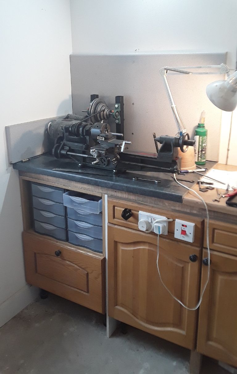

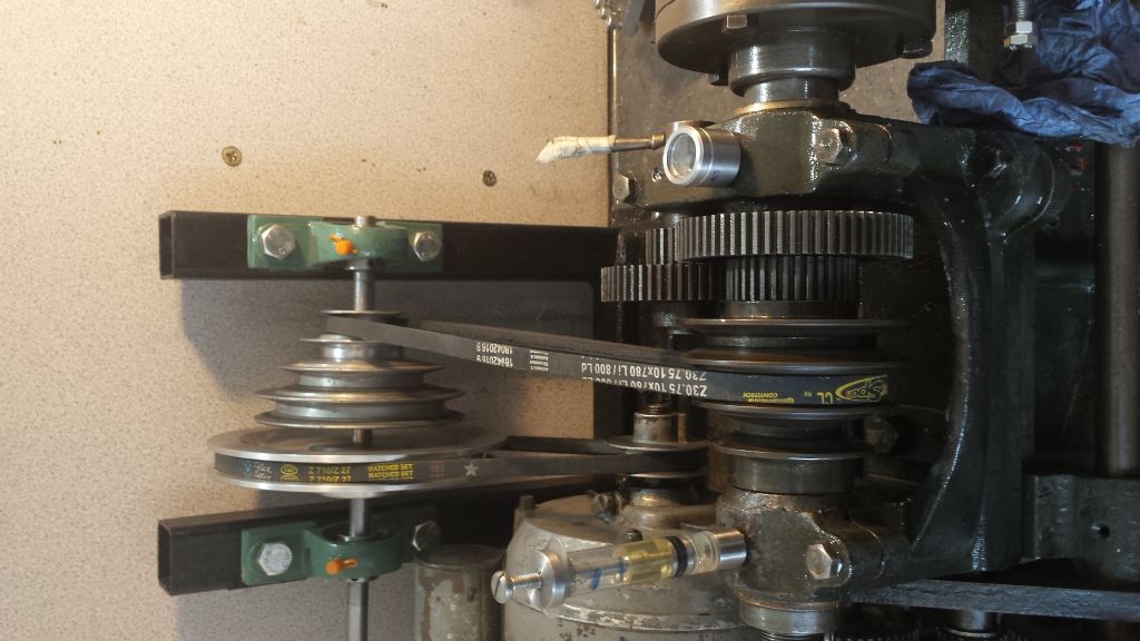

                                              #559406
                                              Andy Thompson 3
                                                @andythompson3

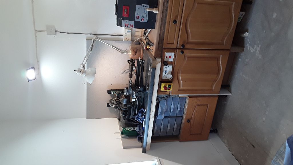

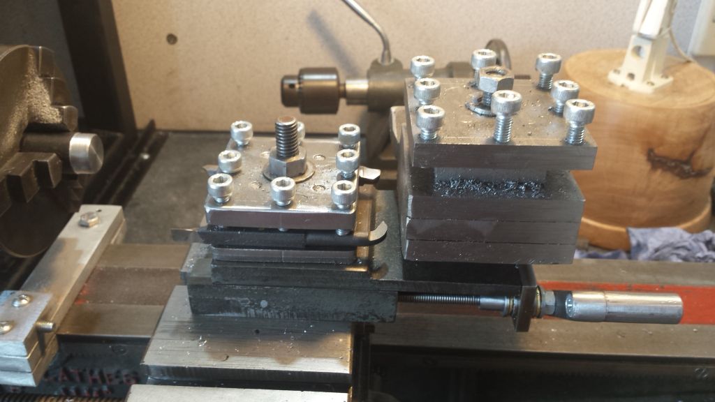

                                                Hi Guys. I promised to keep you up to date as I still need your advice and this may be useful for the next newbie.
                                                First off I modified my workshop and bench. See photo. Added no volt switch – a pain that they use a mixture of spade and fork connectors. The bench is old worktop for free from kitchen suppliers who rip out old kitchens. Thought these would be ideal and resist the oil sitting on it. Need LED floodlights and desklamp to see a dammed thing. I was feed up with crunching on swarf and dropped tools so added the sloping bit at the front. This is really handy for stopping swarf and placing chuck key and tools. It is also perfect for leaning on with a cup of tea – reminds me a bit of those places we used to go to – bars I think.
                                                Not sure whether to add shelves at back. Probably should now move the no volt switch – not sure where – on the wall to left would put me in the firing line of chuck keys etc. Any suggested improvements?

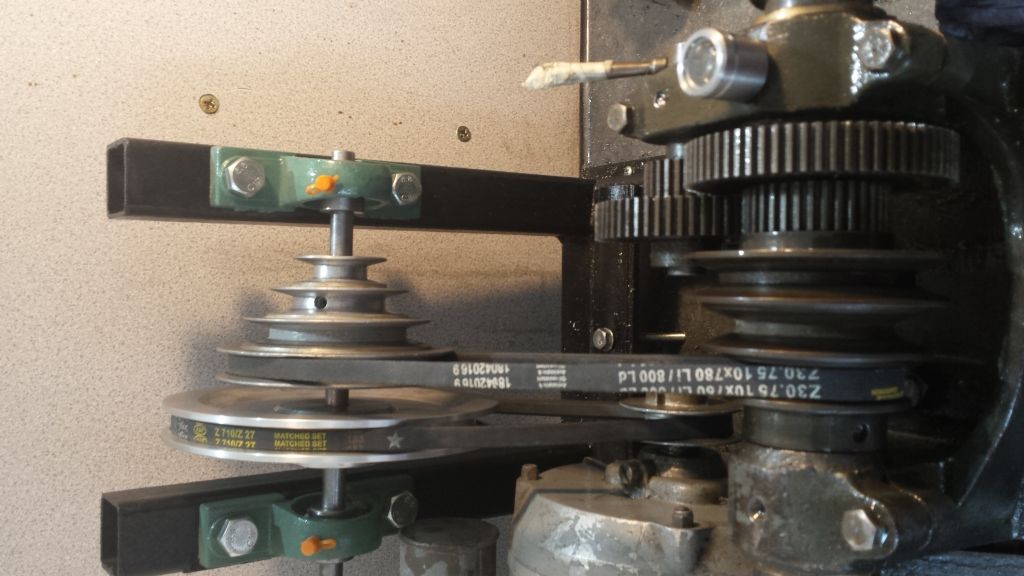

                                                I have also realised that I can improve my range of speeds I run the belts squint. See photo of belts, the three lathe pulleys line up with the three rightmost pulleys on the countershaft. However if I run them one pulley i.e. squint, I can increase the top speed and infill gaps in the other speeds. Can you see any reason not to do so?

                                                Andy Thompson 3
                                                  @andythompson3
                                                  Next I redid the tailstock clamp. See photo, the lump of steel on the left was the first attempt but I couldn't thread it, there was concern about it damaging the bed – and it is ugly. Replacement is two bits of aluminium screwed together. You might notice an extra screw. It is impossible to get the stud driiled in just the right position to leave the clamp flush on the bed but tight enough to hold. Solved by drilling the hole back and adding screw as shown on second photo. By adjusting this you can get it all to sit just right.
                                                  Now I remember being on the rigs and we were not allowed to use aluminium step ladders on the steel deck. Something about aluminium can leave a smear on steel – and this could lead to a spark and thus explosion. I kid you not. Not worried about explosion but could ali make my slide sticky?

                                                    Next up while the ali was out I made a carriage stop. See picture. This has proved most reassuring as I often seem to be working very close to the chuck and this means that any slip does not mean disaster. However dont forget the screw for adjustment. Initially I just slid the stop against the carriage. Once when using carriage feed the whole lot jammed early as the space between the carriage and stop was filled with swarf. Very useful, but so ugly I may redo it in steel.
                                                    Thinking of stops I added a carriage depth stop – both ways. Again see picture. This seemed the easiest way. It doesn't interfere with toolpost and can be removed when not needed.

                                                    Andy Thompson 3
                                                      @andythompson3
                                                      Thought that a more secure toolpost may help my finish so made up the 4 way posts in the photo from scrap steel. Height for the small one is good for 8mm tools – are these robust enough? The big one works off the cross slide with 10mm tools (or 8 with packing).
                                                      Cannot say these are particulary time saving – at least not until I get more and shorter tools. Are two screws really enough to clamp tool securely.
                                                      Had to make more T bolts. See photo. The slot in the slide is 9.5mm. Best I could was turn and use M8 as a stud. Do I need proper milled T bolt?
