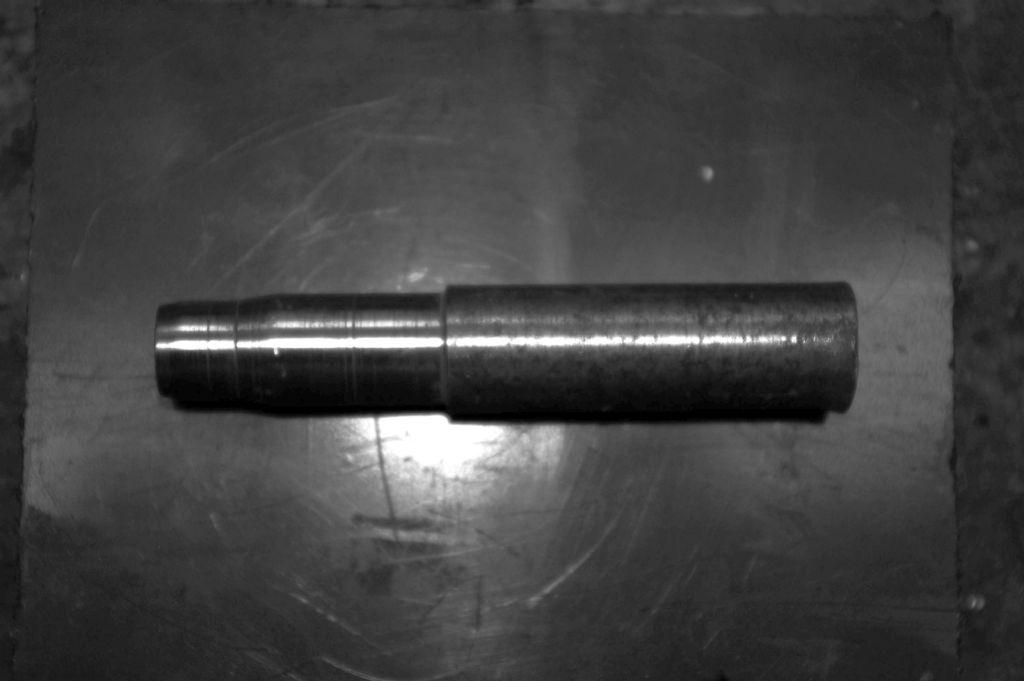

                            pipeswage.jpgHi,
                            I made a tool which bells out the ID of 1/2" copper pipe to the OD so two pieces can be brazed together. The small diameter is 1/2" followed by a slow taper till the OD is reached then a parallel length at the OD. The pipe is grasped in the left hand and the 1/2" section is inserted. The tool is then whacked with a big hammer until the desired result is achieved. It probably wouldn't hurt to anneal the copper first, although I haven't had any pipes crack.
                            Obviously the dimensions would be changed to suit your pipes.
