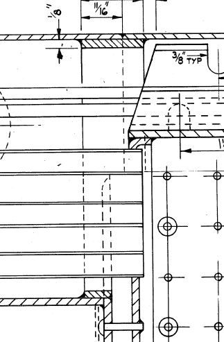

                              Yes you are right Dave, I had just quickly looked at the hornplate drawing which is the Z7S even though part of the "Superba" drawings. The gear drawings have Superba and 16NHP as same size gears.
                              However if I ever get round to building the Superba that I have the castings for it will have different gearing more in keeping with full size as will the 120psi BB1 I mentioned being made by someone else.

                                #492460
                                  The joint ring is typically only the full width around the top half of the boiler and cut back to just over half so that it clears the water space but contacts the curved top edge of the throat plate and extends into the lower half of the barrel. Similar to this.
                                  Omit the threaded stays and poke the rivits through from the inside, bend them slightly on the outside so they don't fall out during soldering and cut them off afterwards. I would also suggest not threading the larger stays where the hornplates attach. Out of interest what diameter rivits do they supply?
                                  BUT do confirm these points with your boiler inspector first
                                  As you seem to have a collection of MEs can I suggest reading "My first boiler" by Julia Old starting with 4325, the third part in 4328 EDIT 4329 shows how rivits are used as stays

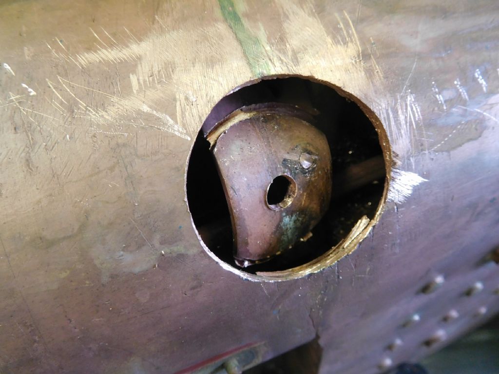

                                      I guess that explains This floating ring / strap in Nigel Bennet's scrap BB1 boiler, it's supposed to be silver soldered to the bridge the barrel to wrapper joint and got forgotten.
                                      #492591
                                        That''s the thing, not only forgotten but shows the boiler was not constructed in an ideal sequence, The barrel, throatplate and wrapper should have been one early assembly then it is easy to inspect the joint to check solder has penetrated Looks like a lot more was assembled before soldering, joint may have only been fluxed from the outside so little chance of the externally applied solder going where it should.

                                          That drawing is exactly what I was expecting from Reeves, but no, just telling me to return it in an undamaged condition. Snag is they use thick paper from a shredder and it isn't easy to disinter the parts from this paper. Was missing the firehole ring, found it in the wheely bin.
                                          No other progress either, trying to contact Tyler Steam Models to ask about drawings, buy a new set if necessary, but no response to email or phone call.
                                          That photo of the BB boiler is impressive, built and safe! Would probably pass all the safety tests, simply because the copper and solder do make a good joint.

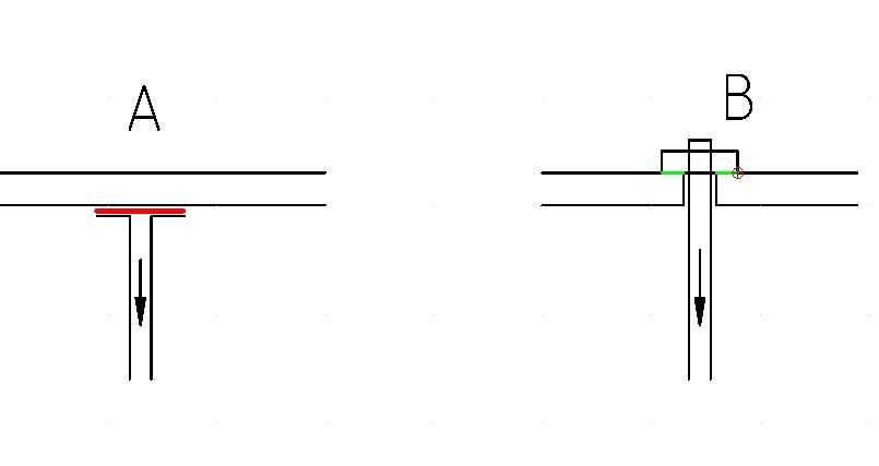

                                          #492803
                                            Posted by Bob Worsley on 26/08/2020 17:55:46:
                                            As to the rivet stays, they are 3/16" diameter, what I wondered was cutting a cross in the end, using a four way chisel to splay the ends out flat and then soldering. Different to threading and nuts, but the volume of copper mechanically holding the stay is the same. End of rivet will need to be annealed prior to splaying. Any thoughts?
                                            The geometry weakens the joint.
                                            In the drawing below Stay 'A' is splayed and soldered, while Stay 'B' passes through the shell and is held by a nut.
                                            When Stay 'A' is stressed, all the force is taken by the solder in tension, marked in red. And the solder could be fatigued due to movements when the boiler heats up and cools down. The arrangement is weaker than Stay 'B' where the same force is transferred by the nut to the outside of the shell in compression (green). Provided the nut and stay are threaded competently, the joint will be as strong as the stay.
                                            I think Stay B also gives more chance of spotting trouble during maintenance because the joint isn't hidden inside the boiler. No experience myself, but I'd guess Stay B would be easier to fit too.

                                              Dave, I suspect Bob was thinking of splaying the end once it had passed through the two plates somewhat like a bifricated rivit. No nuts are used when rivits are used as stays so your second option is also incorrect too. You are correct that B would be easier to fit as how on earth are you meant to apply solder to A when it's inside the water legs or see if the joint ha sflowed?
                                              Don't see any point in splaying it either way, stick with a tried and trusted method, I'm sure the boiler inspector will say the same

                                              #492824
                                                Posted by JasonB on 26/08/2020 19:06:50:
                                                Dave, I suspect Bob was thinking of splaying the end once it had passed through the two plates somewhat like a bifricated rivit. ….
                                                Oh dear, I got the wrong end of the stick on that one. Sackcloth and ashes again!
