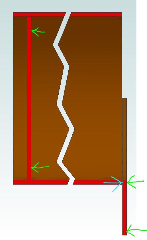

                As mentioned byJeff in the other thread the way the throatplate/barrel joint is constructed would be quite different to say the smokebox tubeplate/barrel if the tubeplate were not flanged.
                If you look at this basic section through the boiler you can see that the pressure shown in green arrows will push the throatplate against the end of the barrel which will greatly reduce the load on the joint as the end of the barrel adds support light blue arrow. The suggested use of a higher melting point solder will also produce a larger filler thus adding strength to the joint.
                Compare that to an unflanged tubeplate where there is just the empty smokebox on the outside so no additional support for tubeplate so joint has to resits all the loads.
                As for steel boilers the weld prep is very important as it gives a far wider joint area that you would get if it were just plate to tube and the fillet will almost double the area. A throatplate to barrel joint would also probably be welded from both sides.
                Edited By JasonB on 16/08/2020 14:08:42

                    #491135
                      Posted by Bob Worsley on 17/08/2020 17:12:53:
                      Jason, you are utterly wrong with your drawing above. The pressure is internal, and this pressure acts on the tubeplate and backhead to blow the ends of the boiler apart, the internal pressure by the firebox front and boiler are irrelevant.
                      Sorry Bob but you are obviously not following my drawing.
                      Here are the same green arrows on the actual minnie drawingare showing the pressure pushing the plates outwards
                      Edited By JasonB on 17/08/2020 17:24:10

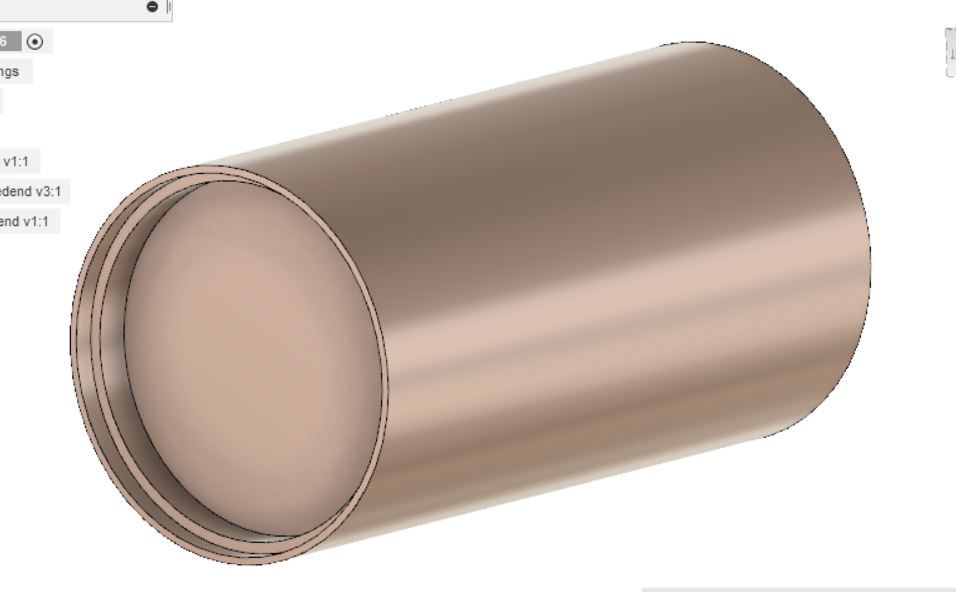

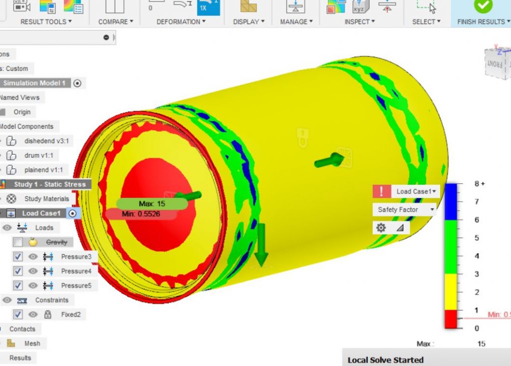

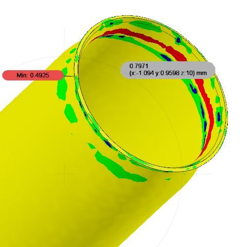

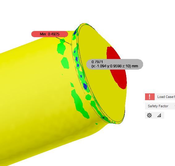

                            Rather than decode good and indifferent from old Model Engineer magazines, Bob could try his hand with CAD and Finite Element Analysis.
                            Just a taste as I've likely made mistakes setting up the model, buf here's a simple cylinder boiler made of Copper with a flat flanged end disc and no stays modelled in Fusion360:
                            Running FEA to identify safety concerns draws a colour map with the weakest areas in red. The internal pressure is 0.7MPa, about 100psi.
                            A few concerns with this design, notably the disc is red in the centre. Needs strengthening by dishing the end, or fitting an internal stay.
                            Generally the boiler is yellow – meaning the safety factor is low. The strengthening effect of the dished end can be seen as green/blue rings. The outer red ring on the disc shows it's highly stressed at he joint; this might be fixed by a centre stay.
                            My feeling with copper boilers is they're as good as they can be. Whilst FEA might identify a clever new design, I suggest the old guys had established 'best practice' by about 1955. They'd been experimenting for over a century and were on solid ground by then.
                            Edited By SillyOldDuffer on 17/08/2020 21:03:30

                                I would urge caution interpreting FEA results in sheetmetal assemblies (like boilers). Depending on metal and thickness vs area the stress may be non-linear as ANY deformation of the sheet / tube occurs. For work like this in industry I have hired professional FEA analysts several times, to be sure the construction is safe at the working pressures expected. Non linear FEA is very complex and expensive, if accurate results are needed. Do not assume the behaviour of the sheetmetal will be linear. Free FEA as found in CAD packages is usually limited to linear analysis- adequate for many things, but not for sheetmetal that is deforming.

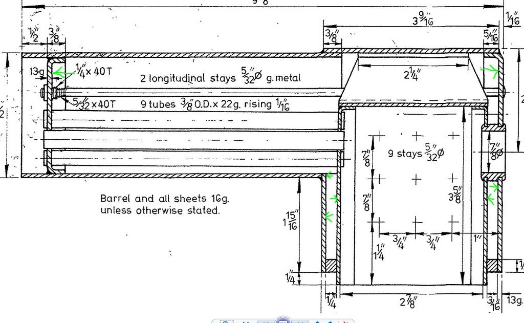

                                  Bob, look at the drawing at the end of page 3 of this thread
                                  Let us assume you use Your 6 mm plates for the firebox not the 2.5mm as specified and 8 mm for the blackhead in order to Maintain the 1.5mm setback beyond the wrapper
                                  your comment about reducing the water space is your initial post is frankly daft It’s already very narrow , keeping the dimensions the same with a solid back head would leave 1.5 mm  Not really enough…….so the firebox back will have to be moved by 6 mm
                                  so in total the firebox will loose 3.5 at each end for the thicker plates, and another 6 as shown above I.e total of 13mm or 1/2” In an already small firebox. Resulting in a reduction of 18% grate area. There will also be a reduction in the overall water capacity don’t forget the overall dimensions of the boiler is from the prototype so it’s fixed
                                  getting most of the plates to fit with your small gap is not so difficult as the copper is extremely workable when properly annealed. Flagging boiler plates isa fascinating exercise on its own As is the process of producing a short bit of seamless tube from flat plate ( raise it and cut the end off even perhaps resulting in thicker wall t than the original sheet )
                                  many many boilers have been produced with flanged plates. We havnt been doing it wrong for the last. hundred or so  years…. don’t  be the soldier who is in step, while the rest of us in the parade are out

                                    Posted by Jeff Dayman on 17/08/2020 22:35:41:
                                    Can't disagree with any of that! My example is a Fusion 360 local linear analysis (ie sums done on my computer), rather than Autodesk's cloud solver, for which credits are required. I don't know what extras the cloud solver provides, but assume the local solver is more basic.
                                    Like all models, it's good to be mindful of their limitations. Scaled up Bumble-Bees can't fly etc. But I think FEA will indicate stress problems rather better than back of an envelope and other unquantified approaches. I don't think it's possible to apply modern technique to small boilers without doing the engineering. FEA, slide-rule, and testing prototypes. The problem with prototypes is how many need to be made to get an acceptable answer; expensive of time and money, so it pays to eliminate obvious mistakes on paper or with a computer.
                                    First time I thought about copper boilers and model locomotives, I assumed they would be primitive and easy to improve. Silly me! Looking deeper I decided copper's properties make it top choice for home-made boilers. It's strong enough and well-behaved whilst being brazed or soldered, both processes making fixable joints. Doesn't develop nasty faults due to internal corrosion. If the boiler fails under pressure, Copper tears slowly rather than disintegrating explosively. Easier for inspectors to detect faults in copper boilers, for example quite difficult to confirm welds in a steel boiler really are sound throughout. Add a century plus of practical experience, and existing copper designs have to be a good bet. They can be built safely by chaps with moderate skills and experience, and professional examples will be even better. High-pressure boilers should be made from steel, but getting the technology right is difficult, and I'm not sure a home-made loco running at 300 or 400 psi would be welcome at many clubs.  And certainly not if I'd made it!
                                    Edited By SillyOldDuffer on 18/08/2020 09:41:38

                                      What I find a bit strange on Dave's image is that the very end of the barrel is red yet it is outside the joint and under no boiler pressure. It would also be interesting to see how things change if the flange were in the usual position of facing inwards rather than how Dave has shown it.

                                              Posted by JasonB on 18/08/2020 10:07:27:
                                              Probably because I fully constrained the barrel there in order to get the solver to run. In effect I told the model the boiler is fixed around it's rim to an infinitely strong immovable object. So the barrel expanding under internal pressure stresses a non-existent joint.
                                              I don't think the imperfection invalidates the model, but wouldn't bet the farm on it. My understanding of FEA is more than a little incomplete!

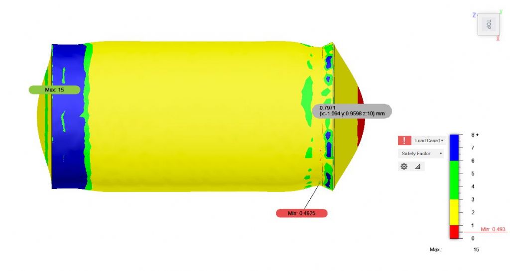

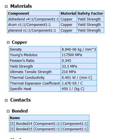

                                                    Just for fun, but this model features corrections to my original plain Boiler plus a flanged disc at one end and a plain disc at the other for comparison.
                                                    The model is now 3mm Copper throughout, and the pressure is 0.7MPa (bit over 100psi). Cylinder 50mm internal diameter by 100mm:
                                                    Safety Factor is x6 and the deformation is x2 (ie exaggerated to highlight movement)
                                                    Top view:
                                                    No red at the flanged end, and lots of reassuring blue where the drum is reinforced by the flange. The disc bulges out, as does the drum. More interesting at the other end where the unreinforced drum swages inwards while the plain disc has a pronounced outward bulge with a red bullseye. FEA suggests the weakest point is the very thin red line running around the drum. (Labelled Min 0.4925) The bullseye is roughly half as stressed (0.7971 at the sample point).
                                                    Making the plain disc invisible reveals more obvious stress at the danger point inside the boiler:
                                                    As expected FEA highlights the weakest point on my mock-up as the joint between the plain disc and the drum. Conversely, the flanged joint at the other end scores as the strongest part of the design.
                                                    Not to be taken too seriously!
