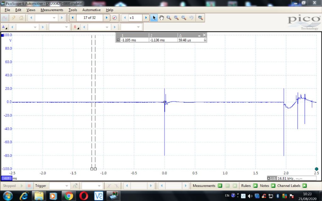

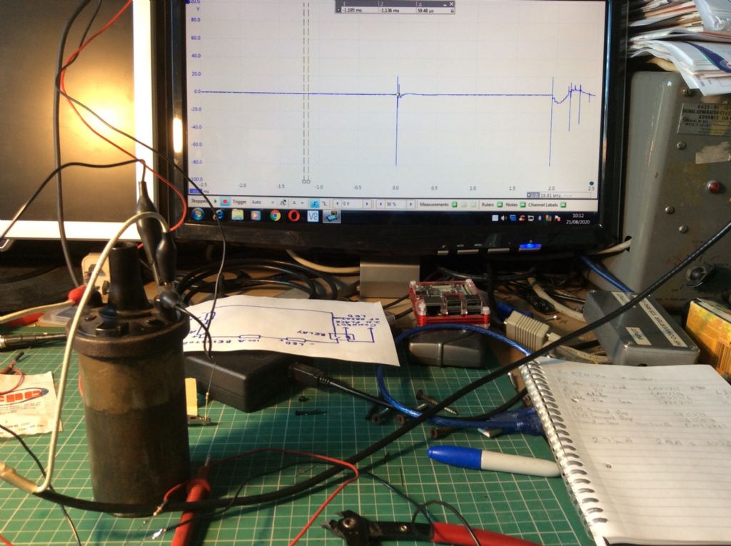

      Hi,
      Just done a test with green led from junk box in series with 270 ohm resistor ,to test the effect of negative spikes,
      Equipment used 12volt power supply,picoscope and 12volt car ht coil. I was able to produce an 80volt negative pulse ,did this a few times.Led and picoscope both connected across the coil.
      Disconnected led ,connected it to 12volt supply still works.
      All comments welcome good or bad
      Maurice

          Posted by Maurice Taylor on 21/08/2020 10:41:11:
          Hi,
          … I was able to produce an 80volt negative pulse ,did this a few times….
          … led ,connected to 12volt supply still works.
          Maurice
          I love experiments, and this one motivates me to have another go! I failed to kill a red LED with -30V, and Maurice failed to kill his green one with -80V. Seems LEDs are as tough as old boots despite what my books say about them being sensitive to negative spikes.
          Tim's problem is proving remarkably difficult. At the moment I suspect bad joints due to faulty manufacture of the LED and its built-in resistor rather than the LED being blasted by spikey electrics. If I understood correctly Tim said one of the failed LEDs lights up when connected directly to a power supply: it's not been killed by a spike.

              Maurice,
              Interesting experiment, but again producing very narrow spikes.

                        Regarding voltage spikes ,put a supresser capacitor on th e HT coil , like when fitting a car radio.
                        Maurice
                        Hi Tim,
                        The above was what I posted ,if you still have one of your Leds connect it across the battery and see if it works as you won’t need to bend it.
                        Maurice
