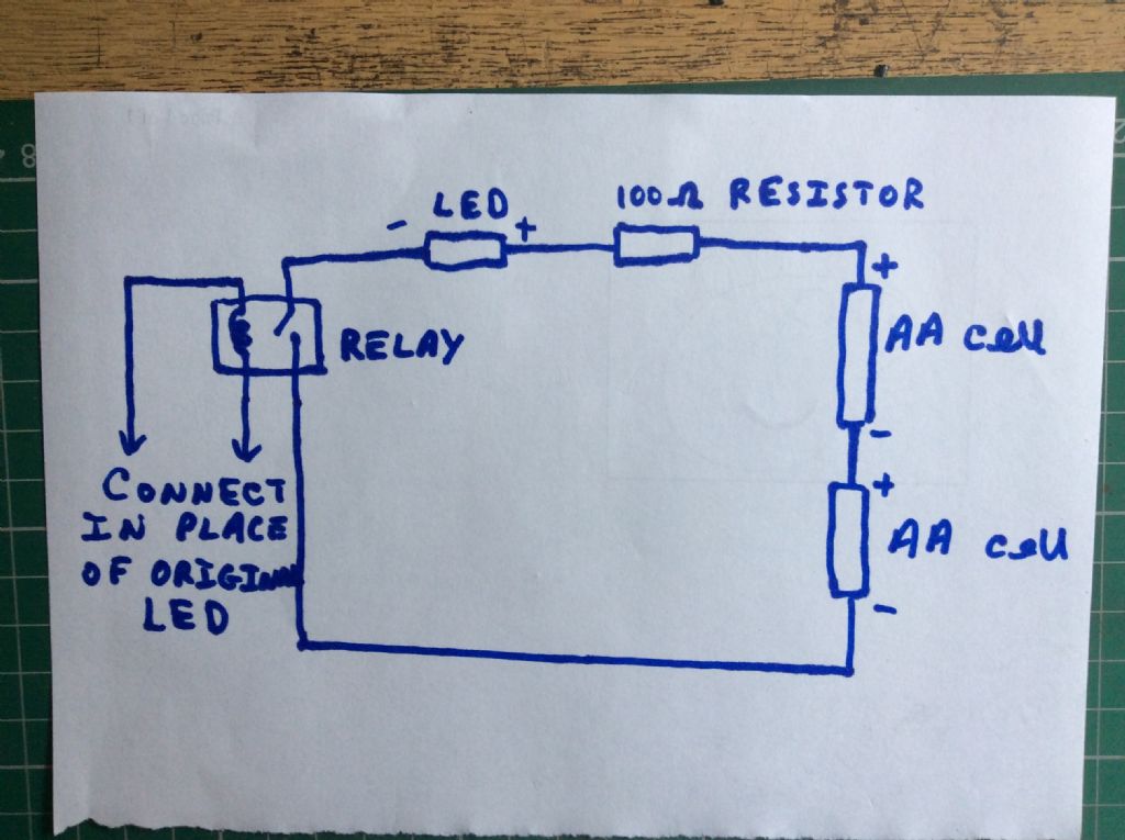

        Maurice Taylor
          @mauricetaylor82093
          Hi,
          Robert,
          Tried green Led from junk box ,it suvived the spikes. If the car is still positive earth ,those spikes on my scope would be inverted ie 130V -ve and 20V +ve ,was it said previously in the thread that leds didn't like -ve pulses.This could be causing the led to fail.
          I've given up with it now ,think I've tried my best,would welcome any comments on the above.
          Tim,
          You could probably try the idea/circuit suggested below.
          The led is CPC Part No SC08786, Relay has 12V coil.
          I have tried the circuit and the led draws 2.7mA from AA cells , they should last well.
          Circuit is completely isolated from car electrics.
          Comments welcome good or bad.
          Maurice

              Posted by Maurice Taylor on 19/08/2020 13:46:15:
              Hi,
              Robert,
              <SNIP>
              Maurice
              Good point Maurice,
              Positive earth per se should not make any difference, all else being equal. However if the modern Dynamo regulator works on positive or negative earth (or is based on a negative earth basic design) that could affect the level of spikes generated by it's operation on negative earth.
              Additionally a conversion from 6 to 12 V may make any spikes generated by the dynamo work.
              Tim,
              is the car positive or neagative earth? Was it converted from 6 to 12 V and or positive to negative earth.
              Robert G8RPI.
