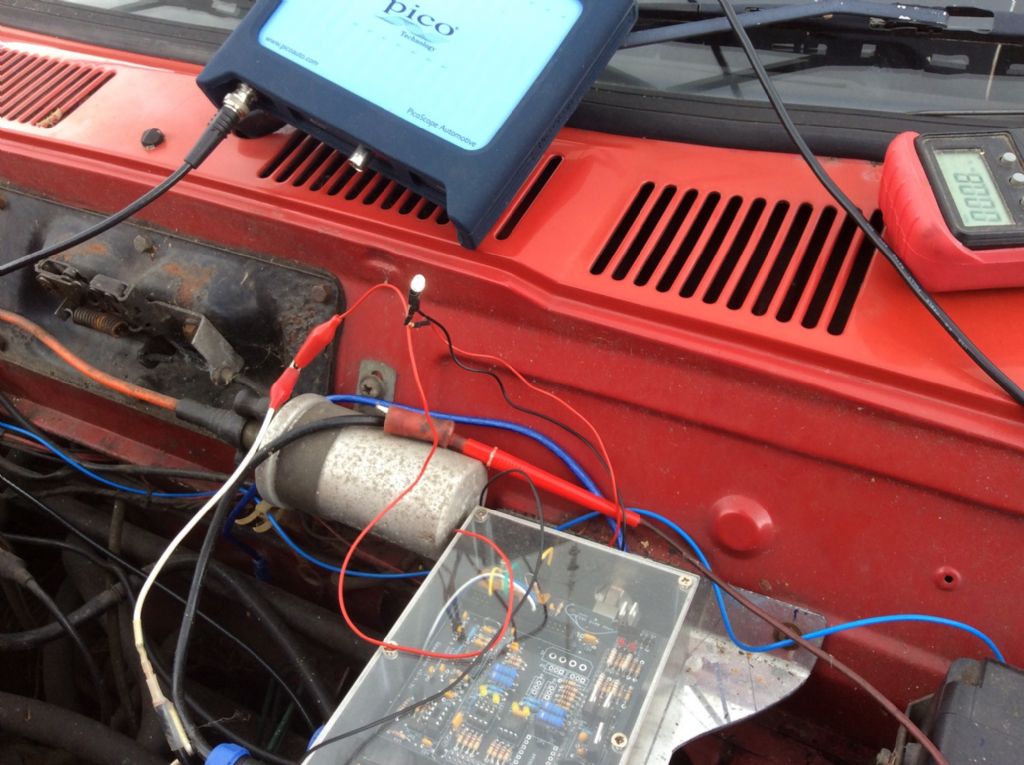

        Hi,
        I have just tested my clear Led with 820 ohm resistor in series on my 40 year old coil and distributer ignition Fiesta.
        1 Connected Led to battery, Led lit.
        2 Started and revved engine ,left running 5 minutes ,still lit.
        3 Turned engine off ,still lit.
        4 Connected Led between points side of coil and ground.
        5 Started engine ,Led lit ,revved as before,left running, still lit.
        6 Stopped engine ,Led not lit, restarted engine ,Led lit
        7 Connected Picoscope to check for spikes
        The above is battery voltage with engine running.
        The above is across the coil connected to Led leads
        coil
        battery
        Hope this helps regarding spikes etc, negative spikes 20v positive approx 130 v
        This is why I think there is a wiring fault in the car
        The spikes do not affect the Led
        Maurice
        Edited By Maurice Taylor on 17/08/2020 14:19:15

              While this is an interesting demonstration of the magnitude of spikes I note your LED had a 820 ohm series resistor. This is a lot higher than the 470 ohm in the OP's. This gives a much more reasonable 11mA current at 12V (assuming 3 V Vf for LED).
              I can't see what wiring fault would cause the LED to fail.
              As I stated earlier the OP's LEDS seem to be running close t absolute maximum curret rating at 12V.
              Robert G8RPI
              P.S whats the box of electronics next to the coil?
              Edited By Robert Atkinson 2 on 17/08/2020 15:23:50

                                                  Likely failure mode for this LED is one area of the junction has gone low resistance (short circuit). With the 470 ohm resistor this prevents the voltage at the junction reaching the emission threshold. With direct connection to supply ther is enough current to drive the voltage across the junction above the emission threshold. It won't last long like this hough.
                                                  A useful check would be to measure the voltage drop across the diode (powered off) in both directions with your multimeter in diode test mose if it has one.
                                                  Robert G8RPI.

                                                    Posted by Robert Atkinson 2 on 17/08/2020 15:23:09:
                                                    Robert G8RPI
                                                    Hi Robert
                                                    I have since tried the same clear Led with a 270 ohm resistor in series,works OK.
                                                    The Led I'm using is CPC Part no SC08786.
                                                    I think the experiment has proved spikes are not the problem,as Led is wired across points ,cant be any more spikey.
                                                    Regarding the box of electronics,it is a homebuilt ECU ,using an Arduino mega ,it will run the ignition using a homemade crank trigger wheel,a BMW crank sensor and a VW wasted spark coil.I haven't fitted fuel injection yet.
                                                    I can change from ECU ignition back to distributer ,by changing plug lead an power connection.
                                                    The project is known as Speeduino, plenty of info on internet.
                                                    Maurice
