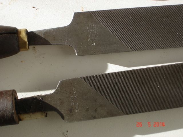

                                I'd go the file way, but I'v got a long angle lathe file (well 3 actually), these don't tend to clog up, and they must be ok on the lathe 'cause it's stamped on the file beside the makers name on at least one of them.
                                Ian S C

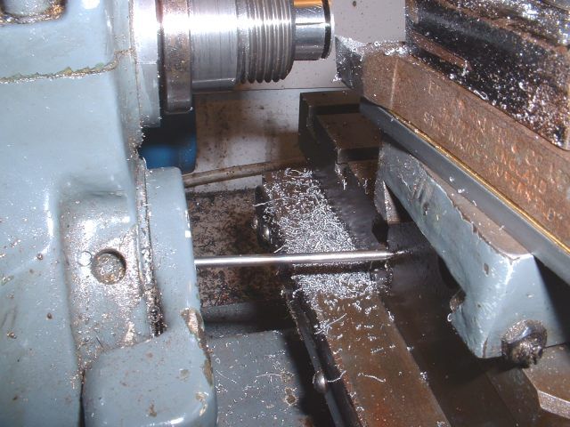

                                      I've never actually done this, but an experienced turner showed me a method using a pointy rod the length of the required radius located in deep dot-punches below spindle centreline on headstock and crossslide chuckside face.
                                      You use the saddle handwheel to keep the radius rod in contact both ends, whilst traversing a tool across the workface. The saddle moves away from the chuck to generate the radius. You arrange the tool so that it reaches centre when the radius rod's parallel to the bedways.
                                      It's fiddly, but it's simple, accurate and I've seen it work.

                                            Posted by Mick B1 on 20/09/2018 21:46:16:
                                            Edited By Mick B1 on 20/09/2018 21:49:23
                                            That's how I do mine:
                                            The method was described by Tim Coles in ME Issue 4277.

                                              You can of course use a similar method for concave radii, with the radius rod held between the tail side of the crossslide and a locked tailstock.
                                              The turner I was talking about was using it to make the mushrooms on the end of full-size locomotive superheater tubes and, I think, a mating concave component too.

                                                  Pointy radius rod and the DAG Brown approach produce identical items so there is no guess work to make them look OK.

                                                    Thanks for this idea Mick, I gave it a try on a test piece and it works really well and is easy to do. The only problem I have is the four blanks which I have for the buffers are 70mm long and the radius needs to be around 200mm. A 200mm guide rod keeps the cross slide too far way from the workpiece even with the top slide fully wound in, I,m using a mini-lathe by the way. The blanks need to be around 125 mm long and then it will work, however all is not lost.
