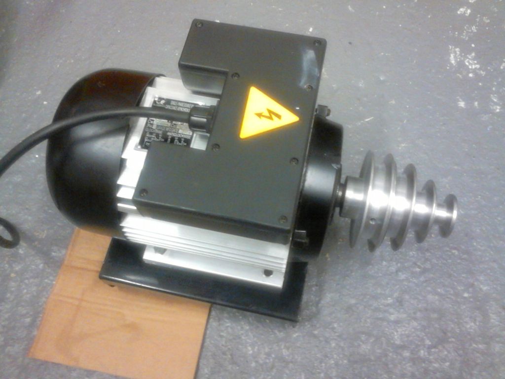

                            I haven't written much on my Mill/Drill 3 phase conversion recently. This is because I was using the unit to complete a task. I have now made a start and I include some photographs below.
                            The first task was to remove the existing single phase motor. After electrically disconnecting the motor at the junction box on the left hand side of the mill/drill head, I found it convenient to remove the motor complete with it's mounting plate. This entailed the removal of the mounting plate upper and lower pivot screws. This method of mounting allows for tensioning of the drive belt.
                            Here is the motor and mounting plate as removed:-

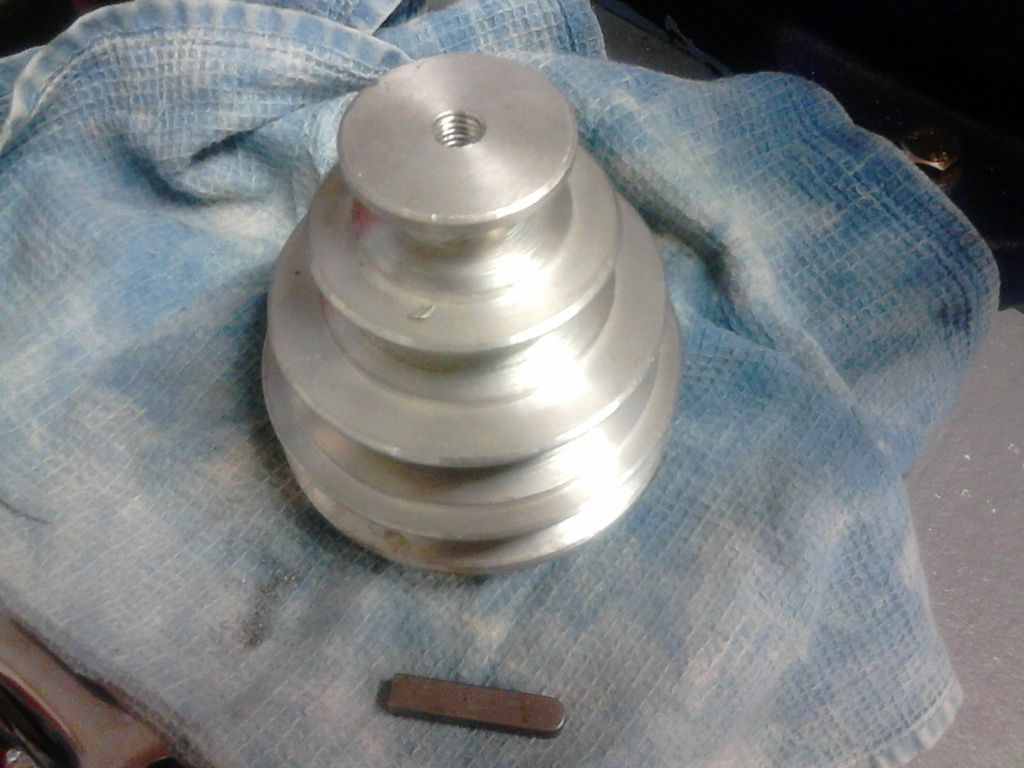

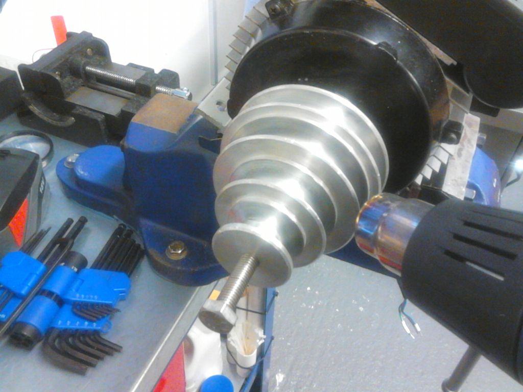

                            The next job was to remove the pulley. The two retaining M6 grub screws were removed first. The pulley was a good fit on the shaft as would be expected. There is an 8mm bore in the end of the pulley; I opened this out to 8.5mm and tapped to M10. I was then able to use a long M10 bolt to jack the pulley off the shaft. The application of heat from a hot air gun assisted with this operation:-
                            Here is the pulley and key as removed:-
