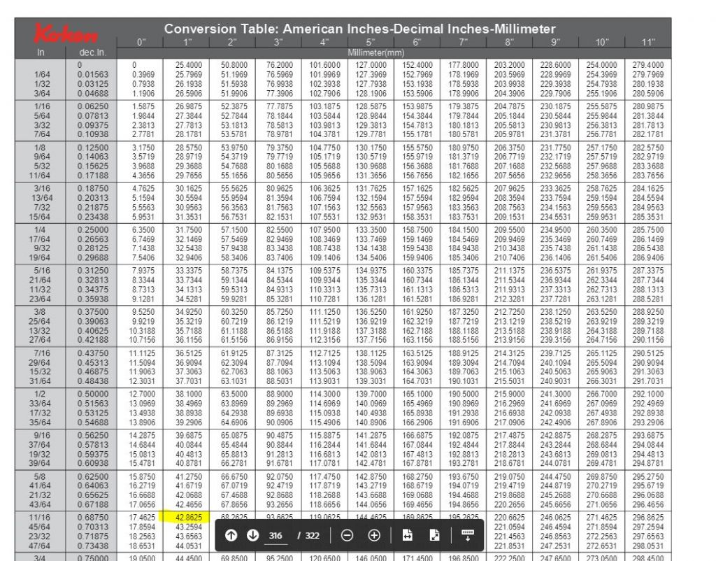

            #558679
              Posted by Ramon Wilson on 17/08/2021 17:57:14:
              So now own to Jason,s/Michael's 11 inputs but, if the 25.4 is in the memory it comes down to 9 – it gets less onerous per post!
              Kind of brings up back full circle to the chart or a spread sheet. Dozen clicks to start with and then no more. How many times would you have to enter those 9 digits on a drawing like your triple? 100 maybe or more so that's 900 presses vs 12. Sheet or part sheet of paper on the desk infront of you takes up no more room than a calculator. And with that chart from the first post there is no need to add on the full inch dimensions or add multiples of the divisor be it in your head or with a calculator. Click image to get it larger.
              Edited By JasonB on 17/08/2021 18:38:20

                #558684
                Steviegtr
                  @steviegtr
                  Thanks for that Tim. Some good charts.
                  Steve.
