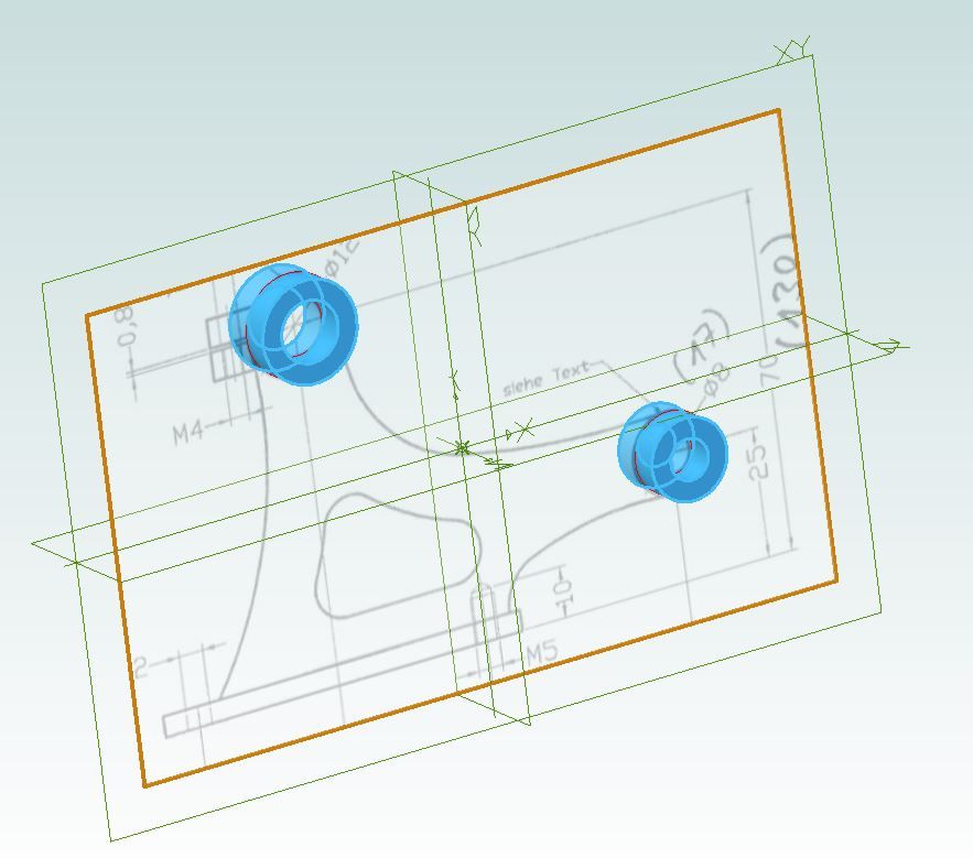

                      The other option which is likely to fit what was said in the opening post of converting drawings to what a "modern young engineer might get to grips with" is to forget giving him a pile of paper and present him with some CAD files so that he can then work with those either printing out on paper, send off DXF files for laser/water cutting, 3D printing parts or jigs or just take the part file and process it in his CAM package so the CNC can spit it out.
                      CAD can make this easier, as you will know most castings are only dimensioned on the parts that need to be machined so no calculator or other conversion will work without a known figure to input. Easy in CAD as you can use the "Trace" function to import a scan of the original drawing, etching or photo depending on what you are working from. Then make adjustments for any distortion and scale it if you want to reproduce the model in another size and then simply use the image to position the construction lines to draw the actual casting.
                      Here for example is the main bracket from my Heinrici engine scanned, scaled etc and I have started to add the two bearing bosses as they are at known positions.
                      It's then just a case of adding the rest or the lines and thicknesses etc to get your "casting"
                      I did not even bother printing it out on paper, just into the CAM and then onto a USB stick to go into the CNC. I could also have used CAD to add draft angles, machining allowance and shrinkage allowance so a pattern could be made for traditional casting.
                      This is how a modern young engineer is likely to do it. I'm not saying I'm that young but I do use some of the modern methods. Though I don't have the equipment to 3D scan in an old unobtainable casting and 3D print a new pattern or just print it straight out in metal.

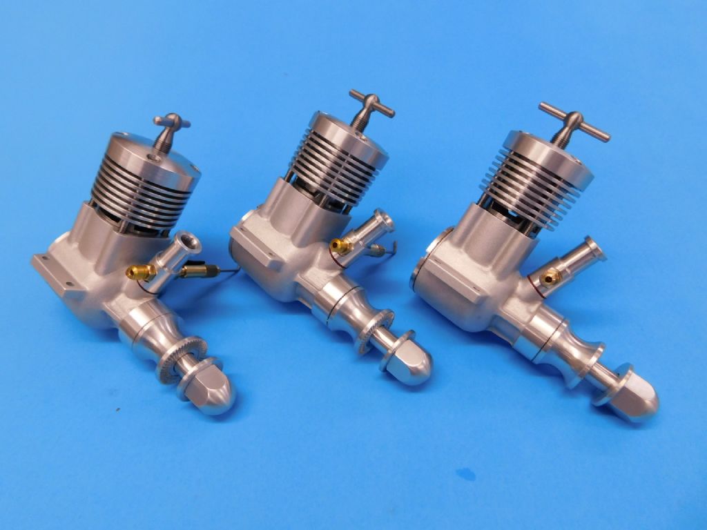

                                Well you are probably right Jason with regard to a 'modern young engineer might get to grips with it' but the operative word is might and of course a newcomer to the hobby may not be so young after all.
                                I spent my working life machining conventionally until the last couple of years or so DRO being the only 'modern' aid until the Haas CNC machining centre came along. Ten or more years too late for myself from a working point of view and fascinating to learn and satisfying to see what you had programmed in use but it's not and never was even considered as something I wanted to bring into my home workshop.
                                I think I said before – I count myself as a dino-sore but the things learnt and used over the years are still relevant and, importantly, still allow me to come up with the goods
                                Sometime back on another Forum I was told these three engines could not be built without, and I quote, "bringing myself into the modern world and learning 3D CAD" – I was simply "twenty years too late". Well I didn't and I haven't but as always proof is pudding shaped winktiger (117).jpg
                                No computer aided anything was injured or harmed in the construction of these Tigers

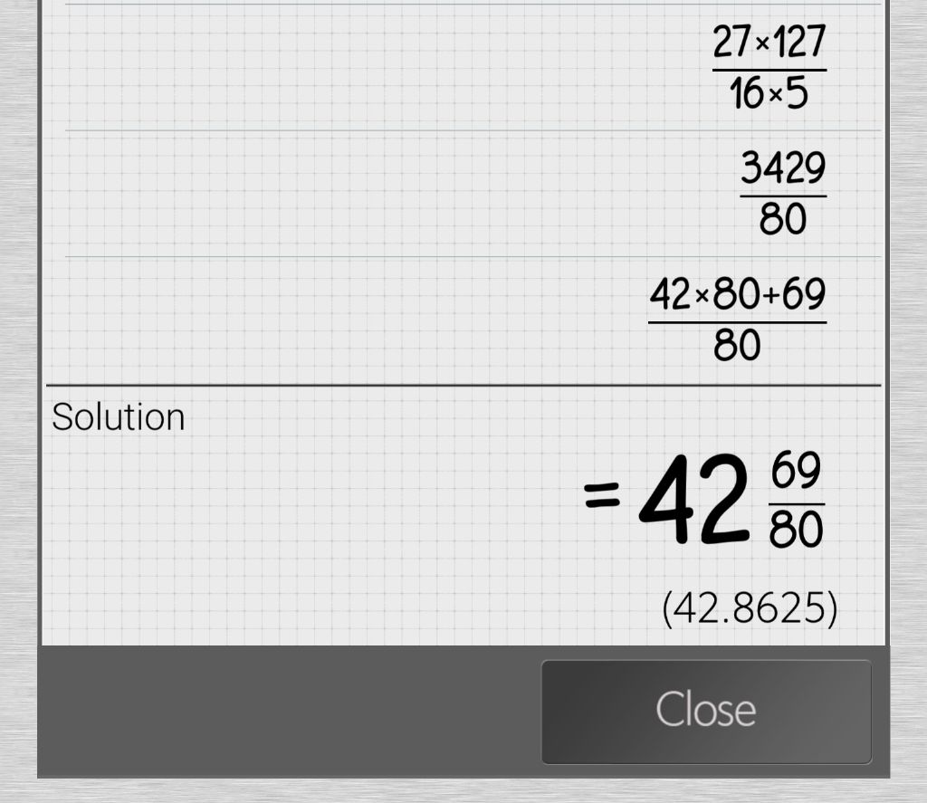

                                  Posted by SillyOldDuffer on 17/08/2021 12:03:49:
                                  All fraction calculators suffer to some degree from this inaccuracy, though the more sophisticated versions do far better than simple minded digital calipers. Michael's example is close: his calculator (and Nick's) both give 1¹¹⁄₁₆ x 25.4 = ³⁴²⁹⁄₈₀. So does mine. However, the real answer is ⁹⁶⁵¹⁷⁷⁶⁹⁵¹⁴⁰⁸³⁹³⁷⁄₂₂₅₁₇₉₉₈₁₃₆₈₅₂₄₈. Don't panic, ³⁴²⁹⁄₈₀ is an excellent result, the error being only -²⁷⁄₁₁₂₅₈₉₉₉₀₆₈₄₂₆₂₄₀.
                                  Highlights a serious problem with fractions because the level of inaccuracy of each calculation depends on the individual ratio and on the number of display digits available. […]
                                  dont know
                                  You must try harder, Dave
                                  Here is the calculation, in fractions:
                                  The fractional answer is correct

                                              Steady guys – that (and the other replies) seems a long way to get to the answersurprise
                                              1 1 / 1 6 + 1 x 2 5 . 4 = (thirteen inputs on a conventional basic calculator) amazingly gives the same answer – 42.8625
                                              Ah but of course I know you want to show all that mathematical prowess you all possess to an old numbskull like me. Impressive of course but neccessary – hmmm not so sure on that – I'll bow out here me thinks.
                                              Great topic and good comments thoughyes
                                              Tug
                                              #558650
                                                Posted by Ramon Wilson on 17/08/2021 16:39:36:
                                                Sorry if it wasn’t self-evident, Tug
                                                The working that I showed is the way the Calculator does it … That listing is available at the touch of the button at top right of the display.
                                                Please see my post at 08:51:28 this morning.
                                                Edited By Michael Gilligan on 17/08/2021 17:03:31

                                                    Oh no, one of us must be wrong! Surely not me?
                                                    Sadly it's true, I've cocked up AGAIN!
                                                    Sorry,
                                                    PS Nurse says bed with no supper tonight…
                                                    embarrassed

                                                      There's much shorter approach by calculator than that shown; as Tug describes and I would do it:
                                                      1) Divide 11 by 16.
                                                      2) Add 1.
                                                      3) Multiply by 25.4.
                                                      = 42.8625
                                                      OR….
                                                      1) Divide 27 by 16. (27 = 16 + 11; simple enough for mental arithmetic more rapid than Steps 1) and 2) above.
                                                      2) Multiply by 25.4.
                                                      = 42.8625
                                                      On some calculators you may need use the equals sign at the appropriate point in either method.
                                                      A waltz and a two-step! Not sure what the photographed umpteen-step example is on that theme… More like Strictly Come Dancing.
